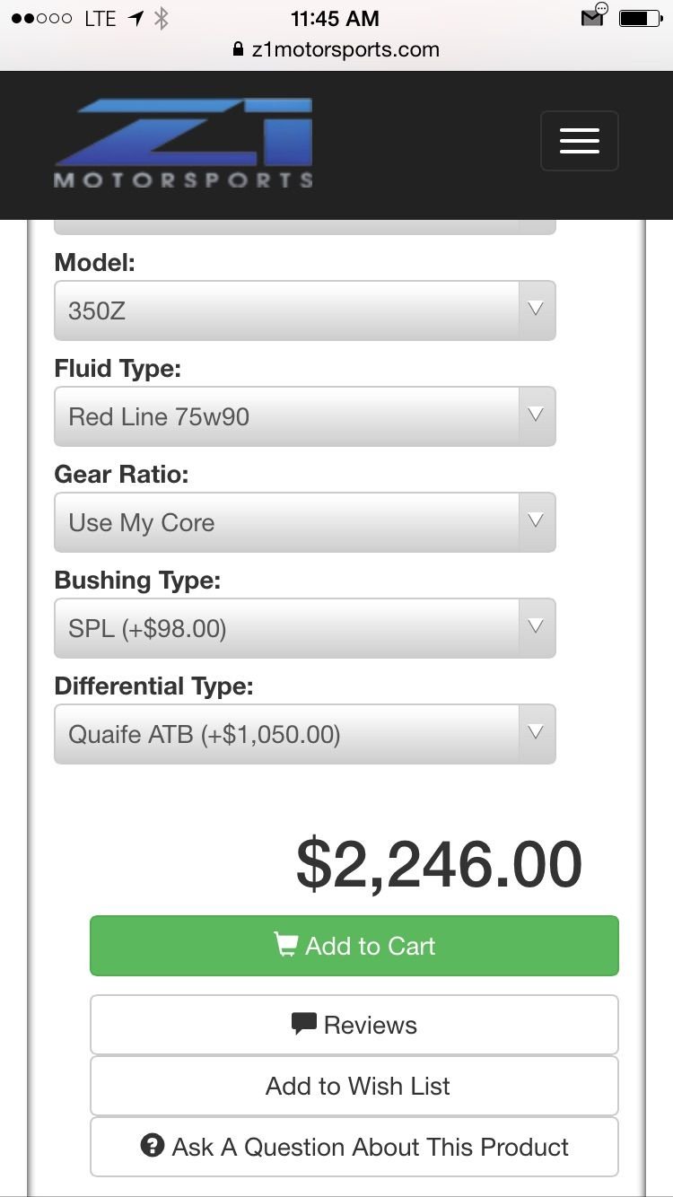

Mine is like 2300 or 2500 cause I'm in SoCal
But even at that price I can't find a local shop that can do the same for cheaper. Pretty crazy
Old Sep 28, 2016 | 10:51 AM
rottingcat's Avatar
rottingcat
Joined: Dec 2015
Posts: 123
Likes: 14
From: California
this is not including shipping and tax yet... ��
were prices raised?
I'm pretty mechanically inclined...does anyone know if it's easy to self assemble and clean everything like it's brand new?
