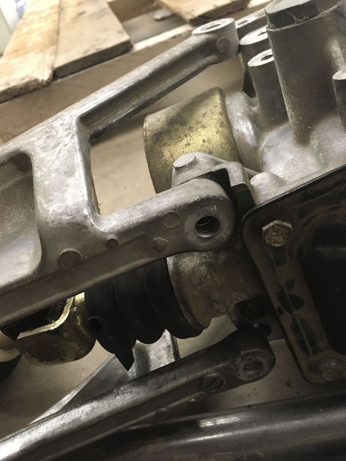

Cd009 bushings
Cd001 no bushings.
i finally got around to swapping in a cd009 after years of complaining about grinding shifts. I looked and looked for ways of identification for a cd009. And couldn't find any. The main thing I noticed from looking is my cd001 had a solid mount shifter bracket. The cd009 has rubber bushings in the bracket holes.

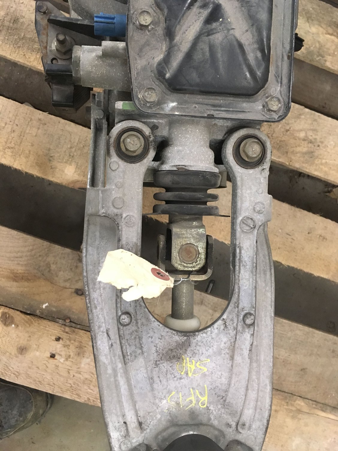

Cd009 counter weight.
cd001 no counter weight.
Second is my cd009 had a counter weight or something on it that the cd001 did not. Now these 2 things could be because it's newer or because it came from a G35 which was meant to be softer and smoother. However i did not see either of those things when looking at older g35 transmissions. Just was thinking maybe this could help others out in the future.
