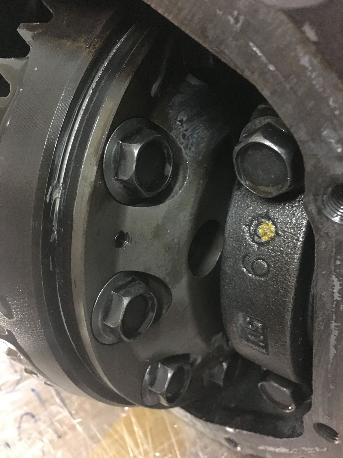

Hi there
i just bought a used pumpkin was only told that its a 2 way lsd. Can someone help me identify what the brand or if its a 1.5 or 2 way.
It might be ats carbonetic lsd but the cap side is a little bit different from the image i search here. The only mark i found on the cap side is “No 033600” and the one line on the casing. Other than that nothing else
attached are the pics of the lsd
thanks in advanced

I definitely see a thrust washer, the cam inside looks to be symmetrical, and the ramp profile on the pressure rings also seem symmetrical, meaning it is setup as a 2 way.
Regarding brand, no idea. Since the carrier is open and out of the car, it isnt too difficult to remove the diff and open it up (as long as you have the tools of course), which I would definitely recommend based on its condition. Especially if its a carbon plate unit.
Cheers!
Cheers!
will do this weekend sir. will update if i found out any clues
