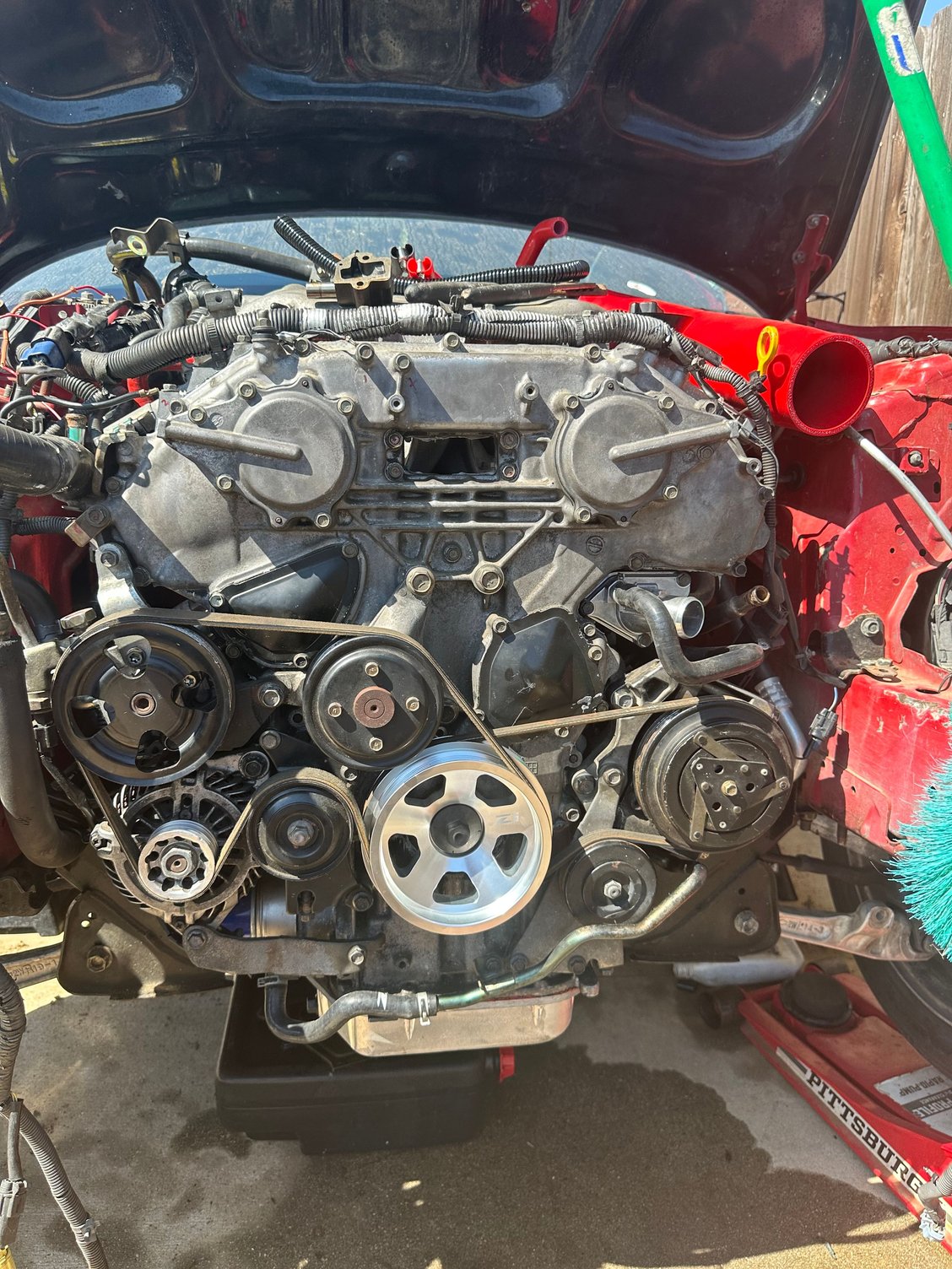

Hi I bought an automatic nissan 350z shell and my plan was to manual swap it and get a engine for it so I installed the engine and the manual transmission and I completed the whole process of the manual and installed the manual harness and I installed a manual Ecu and reprogrammed the key to the bcm and Ecu and I did the wiring procedure with a safety clutch switch and the problem I’m having is that the car cranks and cranks and it almost want to turn on it releases combustion smoke from the test pipe and I used a obd2 scanner and my codes is p1122 so I need help if anyone ever had this p
roblem

Hi I bought an automatic nissan 350z shell and my plan was to manual swap it and get a engine for it so I installed the engine and the manual transmission and I completed the whole process of the manual and installed the manual harness and I installed a manual Ecu and reprogrammed the key to the bcm and Ecu and I did the wiring procedure with a safety clutch switch and the problem I’m having is that the car cranks and cranks and it almost want to turn on it releases combustion smoke from the test pipe and I used a obd2 scanner and my codes is p1122 so I need help if anyone ever had this problem
Holy run on sentences, Batman! Why do young people refuse to use punctuation? Might want to start your own thread.
