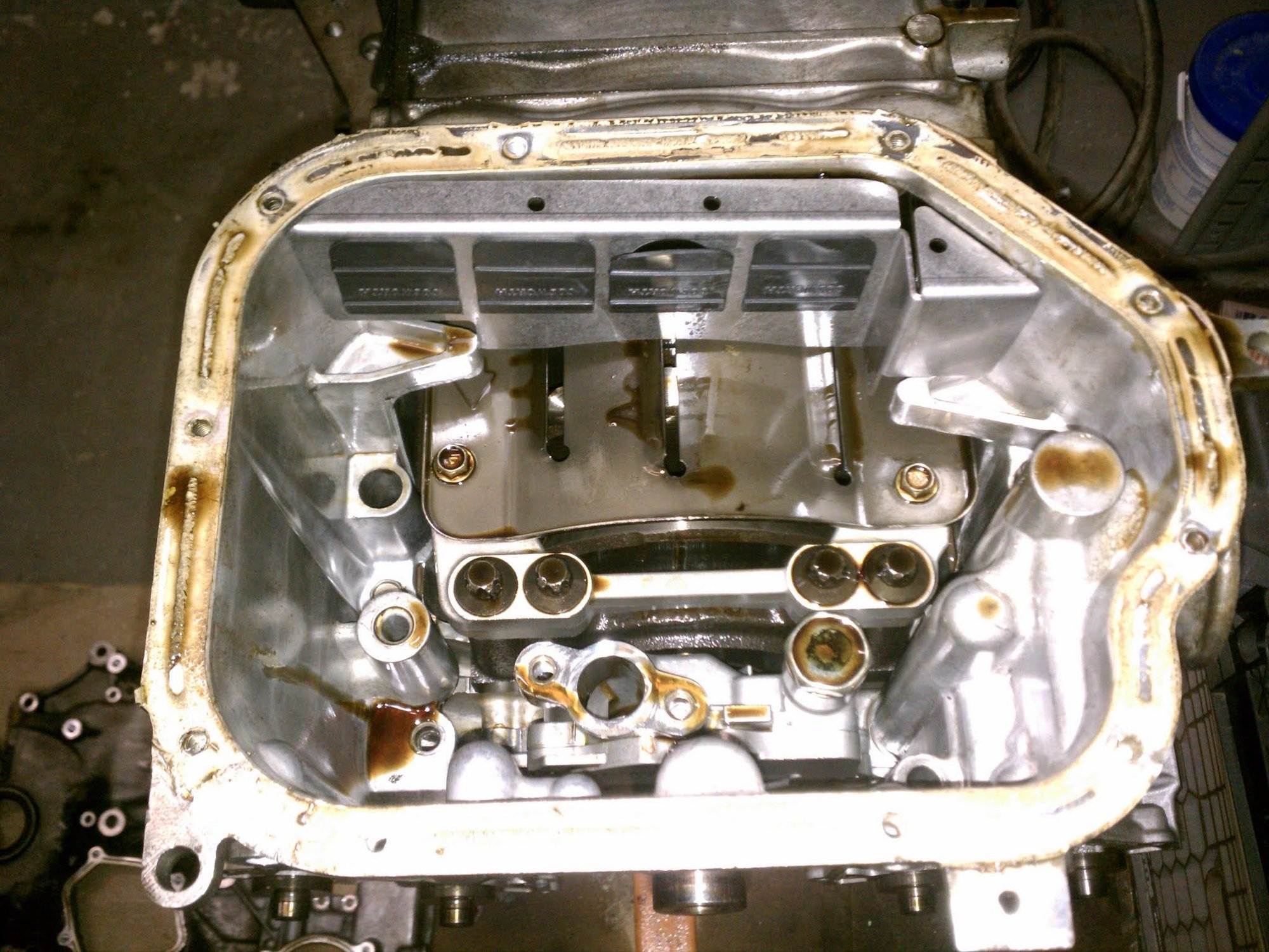

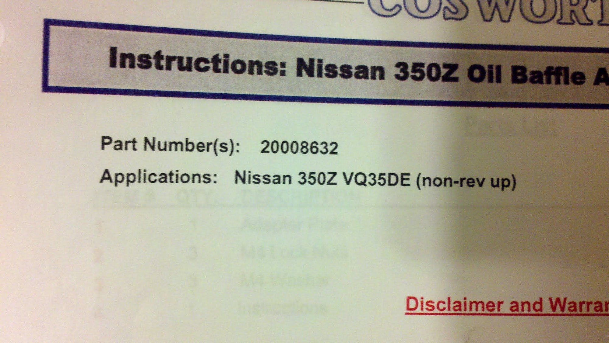

You need to find a used APS Oil Pan and the Cosworth Oil Control Baffle Kit

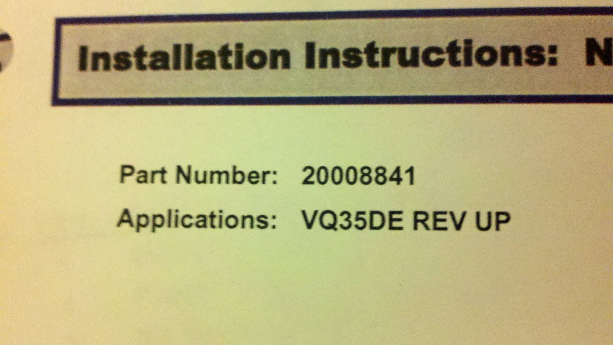

What about th rev up engine?
Old May 22, 2023 | 08:52 AM
terrasmak's Avatar
terrasmak
Super Moderator
Posts: 29,138
Likes: 2,402
From: Sin City
they have a version for that engine too
