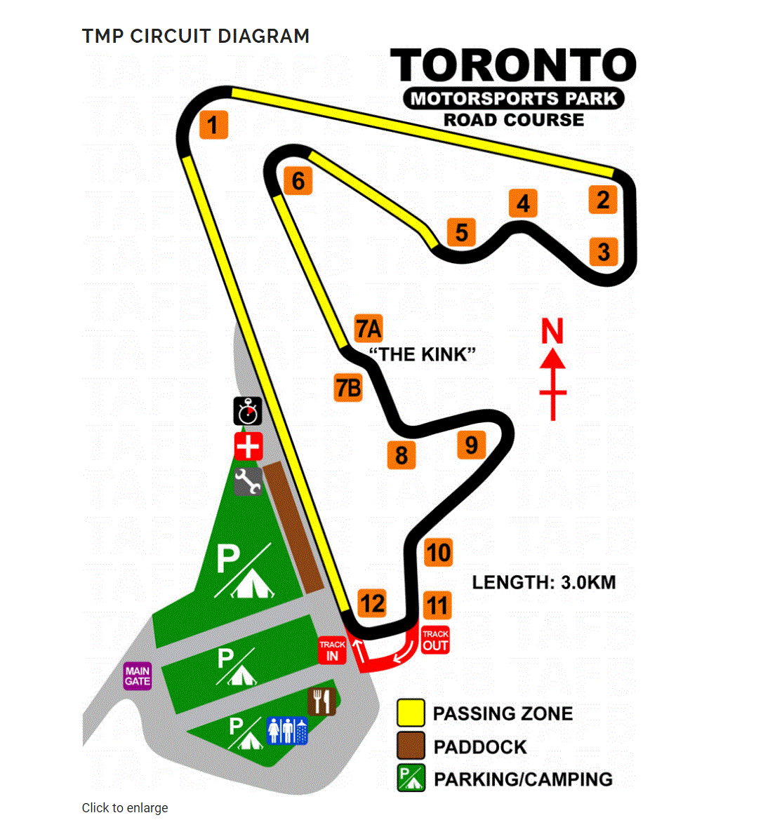

Last track day I experienced extreme blow by after hard cornering on the track. The car seems to have oil getting past the pcv valve and my catch can and going straight into the combustion chamber. It seems to happen after turn 6 at my local track (TMP) right after I get on WOT. I'll post a pic of the track layout.
TMP track map
