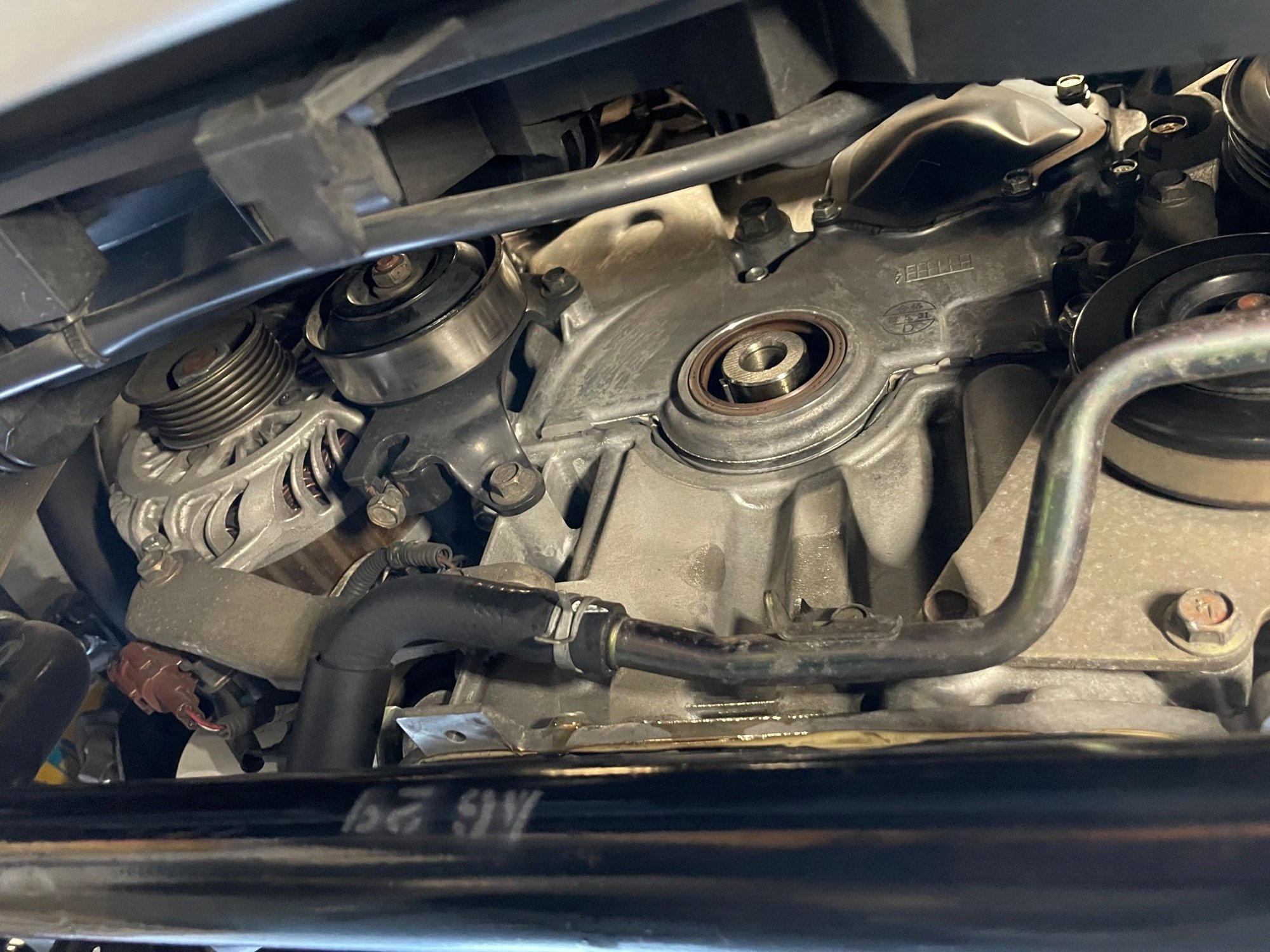

There should be enough space to replace the seal without pulling the Radiator or Fan Package. I recently replaced my crank pulley for a Fluidampr unit. Here's what it looks like with the pulley off. I didn't need to remove anything else from the vehicle aside from accessory belts and the lower splash shield. Definitely easier to do from underneath the car.
Cheers!
-Icer
Crank Pulley Removed, exposing front main seal.

Oh wow thanks for the pic!
Is there space to get an impact on there? I don't think the crank pulley has ever been removed on this car (bought used at 60k, currently at 120k) so I'm not sure how stubborn the crank pulley will be..
I have a quickjack so lots of room to access stuff from the bottom 👍

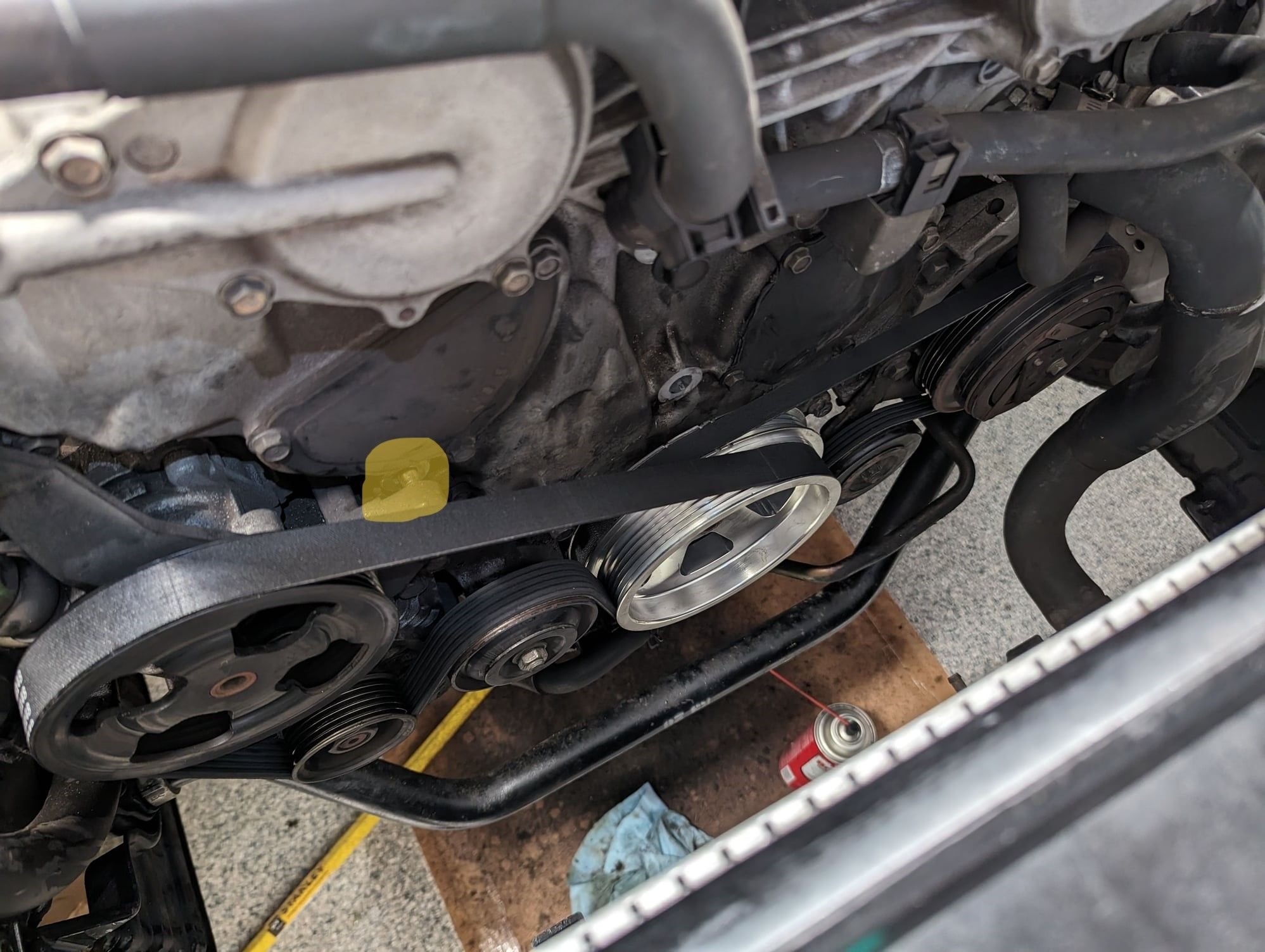

Thanks for all the tips. Just wanted to post an update and pics.
Managed to get it off eventually. Tried from up top with a breaker and extension but wouldn't budge. Put it up on my quickjack and decided to pull the fans to use my impact. There's actually enough space to fit a Milwaukee m12 stubby impact. Tried with the impact for a bit but my high output battery went bad recently so it didn't have enough torque with my regular batteries.. Finally tried the breaker from the bottom and was able to break it free (locked in place with parking brake).
Got off the crank pulley and pulled the front main seal. I *think* it was the front main rather than the upper oil pan seal based on the splash pattern. Oil was spread pretty evenly in all directions around the crank. Installed a Z1 crank pulley and new belts. Did the idler pulley delete while I had everything off. No leaks so far so really hoping that was it.
Thanks again for the info and tips!

Hey mcubed,
Hate to point it out, but you're missing the spacer washer for the pulley delete. The PS pump really should have this to prevent the pulley/belt from going out of alignment.
See pic.

Haha thanks good eye!
I was gonna post another thread asking for tips on installing the spacer. I had to really work it to get the pulley bracket off. I can't even get the edge of the spacer started. Even with the ps bracket bolts loosened... I can't get a good angle to pry the bracket at all for extra clearance either. Any tips?
I think I saw a video where someone grinded the spacer down a bit to get it to fit..
Also is it ok to leave the other idler pulley bracket bolts off? They bottom out without the bracket.
