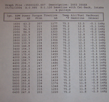

Looks pretty lean to me...........at some rpm ranges..........here is my A/F chart alot richer
