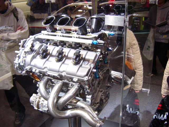

ANyone have picture of ITB? Either on 350Z or M3? I would like to see how it looks.. thanks!

here ya go
HKS:
Old Mar 19, 2004 | 05:55 AM
Z1 Performance's Avatar
Z1 Performance
Former Sponsor
iTrader: (564)
Posts: 19,266
From: Long Island, New York
NISMO:
