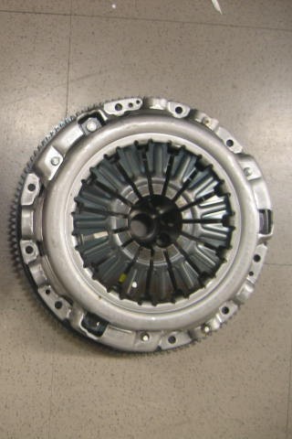

but what about pressure plate ? is that the same as Clutch Cover ? or is it additional part ?

NISMO calls the pressure plate CLUTCH COVER...
here is a pic of it next...
