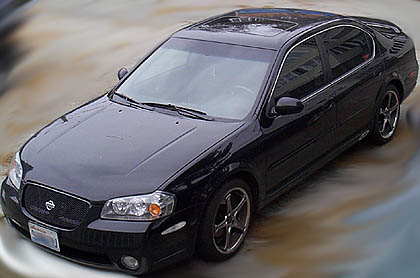

I had a 2k2 Maxima right before I bought my Z.
Having been on the maxima boards for about 2 years, I have some basic info.
For one, the average stock dyno on a 2k2 6-spd was 210hp at the wheels.
I'm not sure how different the engines are, but there seems to be a big difference in stock HP. You couldn't get near the Z HP without some serious cash....even with Technosquare.
