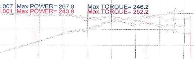

Alrighty, about a month ago, I installed Stillen SC Stage 2 (6psi). Reason I chose it is because it was one of the most reliable, albeit mildest mods (as far as FI goes) on the market. However, it appears I've been driving with -40 of both torque and whp, because I just took the car to be dyno-tuned, and -- low and behold -- it 'scored' only 267whp/246wtq...
WTF!!?
Can anyone even begin to explain this? I mean, this was installed by SGP, a reputable pro-shop here in Houston. Also, tuned by them, and they did richen my A/F which appears to have been too lean. In fact, first dyno showed pretty much stock numbers, or just above: 244wh/252wtq.
What's even funnier, according to SGP guys, I'm running mostly about 5psi of boost, at best 5.5psi. This is a 6psi pulley. Again, WTF!?

Attached Thumbnails Lets see you figure this one out!-my_stillenstage2_dynojet_dyno_01smsm.jpg

Limits suck! Here are prime cuts, for the gawking! Let the freak show begin!

I'm not too sober right now, but belts... that's a possibility. For ECU... well, Stillen is plug-and-play, the SAFC2 I got on is just for more leeway to play with. Without any ECU changes, no fuel adjustments (no SAFC changes), etc... you can see 243.9whp only. Ouch!

Also might want to run an ODB2 datalogger next time you do a pull so you can log the timing and fuel trims....that should give us some better insight

I think the 7th injector is kicking in, it is hard to make out but you A/F looks to be in the 11-12 range and smooth throughout.
