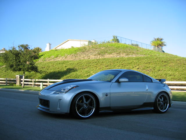

I have the stage 3 Steal in SC and mine sounds very close to yours, although i did notice there was some hesitation in the second gear to redline runs.
What exhaust are you running?
