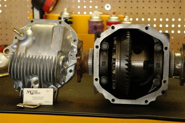

I got the pics back from Motorworks today. Got some good ones.
Attached Thumbnails Part II review of 3.9 gear 1/4 mile-new-image2-small-.jpg

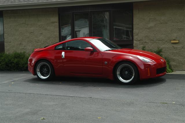

Great shot of my car.
Attached Thumbnails Part II review of 3.9 gear 1/4 mile-new-image-small-.jpg
