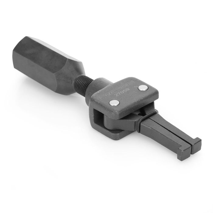

This is an update to step 18:
Using a "slide hammer puller" - google it:
^ due to the pilot bushings small size..i had to grind the tips of the slide hammer just a wee bit to get it to work.... just some FYI...
The attachement i used look like this and the little tips on the end at the bottom right of this pic i had to grind down to fit into the pilot bushing hole:
blended no more than .030 or so i would say...
-J
