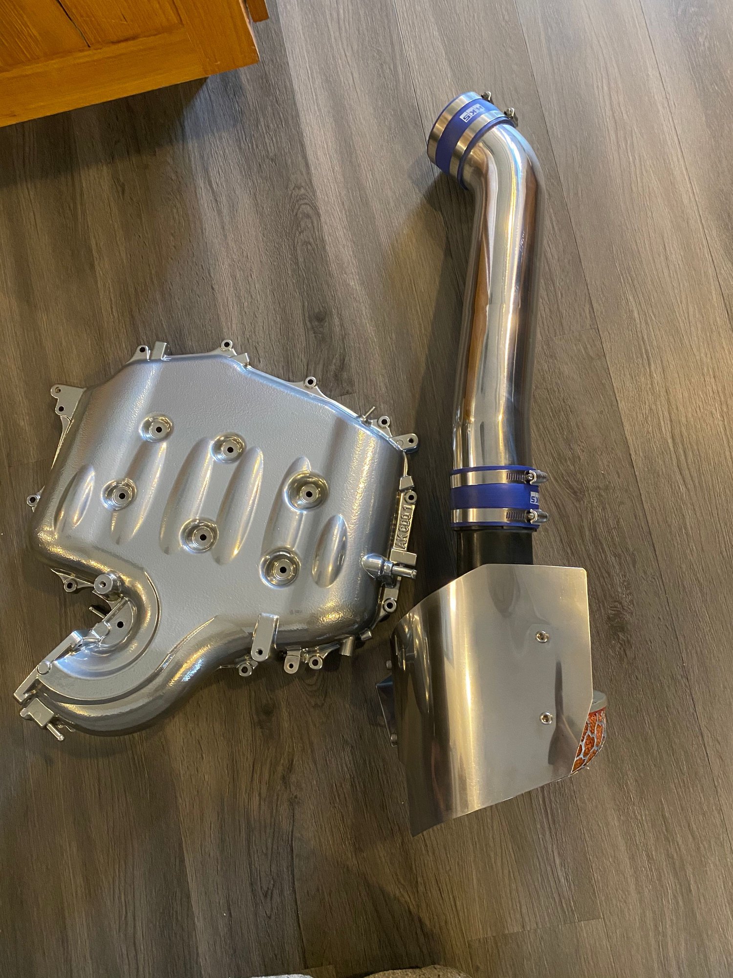

Old Jun 6, 2020 | 10:01 AM
jonathan_337's Avatar
jonathan_337
Joined: Jan 2020
Posts: 31
From: Port of Spain
As promised guys 😁 Powder coated the plenum so no oxidation will occur.
Old Jun 6, 2020 | 02:57 PM
calvin.w's Avatar
calvin.w
Joined: Oct 2019
Posts: 438
Likes: 77
From: Georgia
nice, looks good!
Old Jun 6, 2020 | 08:21 PM
jhc's Avatar
jhc
General & Tech Moderator
Joined: Jan 2013
Posts: 10,400
Likes: 2,226
From: ZdayZ
That actually looks pretty damm good, Jonathan!
Old Jun 7, 2020 | 06:00 AM
MicVelo's Avatar
350Z/370Z Tech Moderator
Joined: Oct 2014
Posts: 10,319
Likes: 3,381
From: Northern California
Looks good. Curious, you powdered with what? A clear? That would answer my question I was asking regarding whether a clear coat would save the finish over time. Be interested to see this part a year from now. Please put it on your calendar to post follow up next year.
