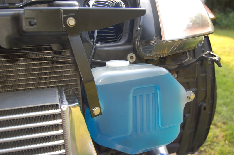

The washer tank is on the driver side right next to the intercooler. So This oil cooler will be to the right next to it. I can relocate the tank to the passenger side but too lazy LOL. I just finished 1 side of the bracket and will do the other side tonight after work. I work 12 hours day and don't have much time to work on my car. Will take some pictures for you guys to see if it's ok.
wait, what car do you have that has the washer fluid tank on the drivers side?
My oil cooler is mounted to the passenger side of my large intercooler, with plenty of room to not interfere with my washer tank.

03 350Z. I got the Greddy TT kit and the washer is right next to the intercooler. Now thinking about it, if it ran out....how da hell i'm going to re-fill it LOL? I can put the oil cooler on the passenger side, but then there will be extra length( long stainless braided lines). Don't feel like cutting them, and it jsut perfect length on the driver side.

Well BAD NEWS! It doesn't fit on the driver side The freaking wastegate is in the way. BTW I got the regular GTM oil cooler kit(bought it of for a bit over $300 new). Just tried over the passenger side and it rubs on the bumper reflector. It will be pretty tight fit and might rubs the intercooler pipe a bit. Will try to make it fit.

Finally got it to fit! Such a PITA!!!!!!!!

Finally wrapped things up! BTW, it's the 26mm Bought the 27mm then return for the 26mm.

Great work on those brackets OP. Nice setup.

Only thing I'd do different if I had the time would be to paint them flat black. Maybe next time I have bumper cover off, I'll paint them.
