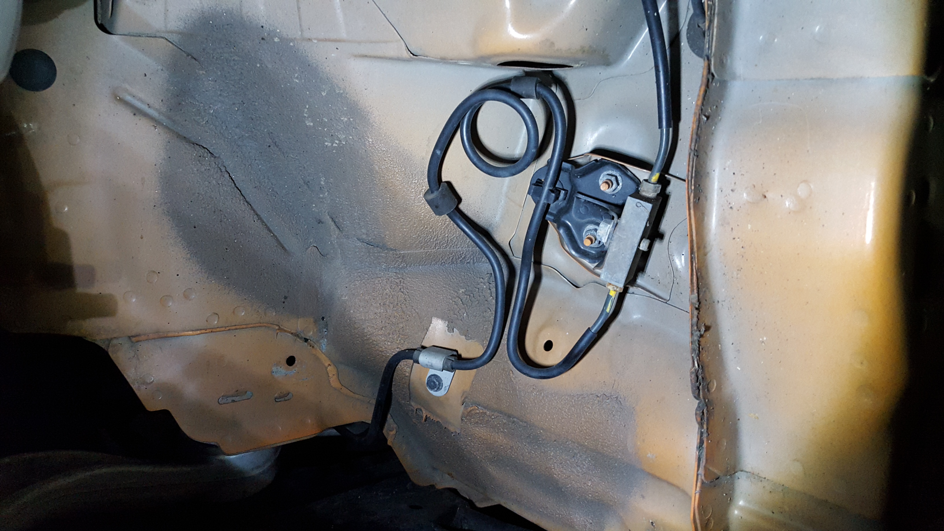

Ok so I assumed that Zspeed MC kit would connect all the way down to where the CSC connects to underneath the car (PIC 1). But it actually is only long enough to connect to the orifice block (PIC 2). My question are:
1. What are the benefits of this block?
2. Why can't it just be replaced by one long SS line?
3. If it can be removed, what are the benefits?
4. If there are benefits, where can I get this SS line?
Pic 1:
Pic 2:
DIY: Zspeed Wilwood Clutch Master Cylinder-4idkqaw.jpg
Old Nov 6, 2015 | 02:31 PM
  #58
Pic 1:
Pic 2:
It does replace everything except the short hose to the trans, looks like you've installed it incorrectly

oh wow, my bad. I hadnt yet taken it out of its packaging. I just did that, and its 4.5ish ft in length. Just to be clear, that is long enough to make it to the tranny hose?
Pic 1:
Pic 2:
Also not sure which lines you have in both of your pics but neither one are of the lines you received with our kit, our lines are coated in a black PVC coating.
From the master you will follow the stock routing of the hard pipes with the Ss line included and then connect that to the short hose going to the transmission
