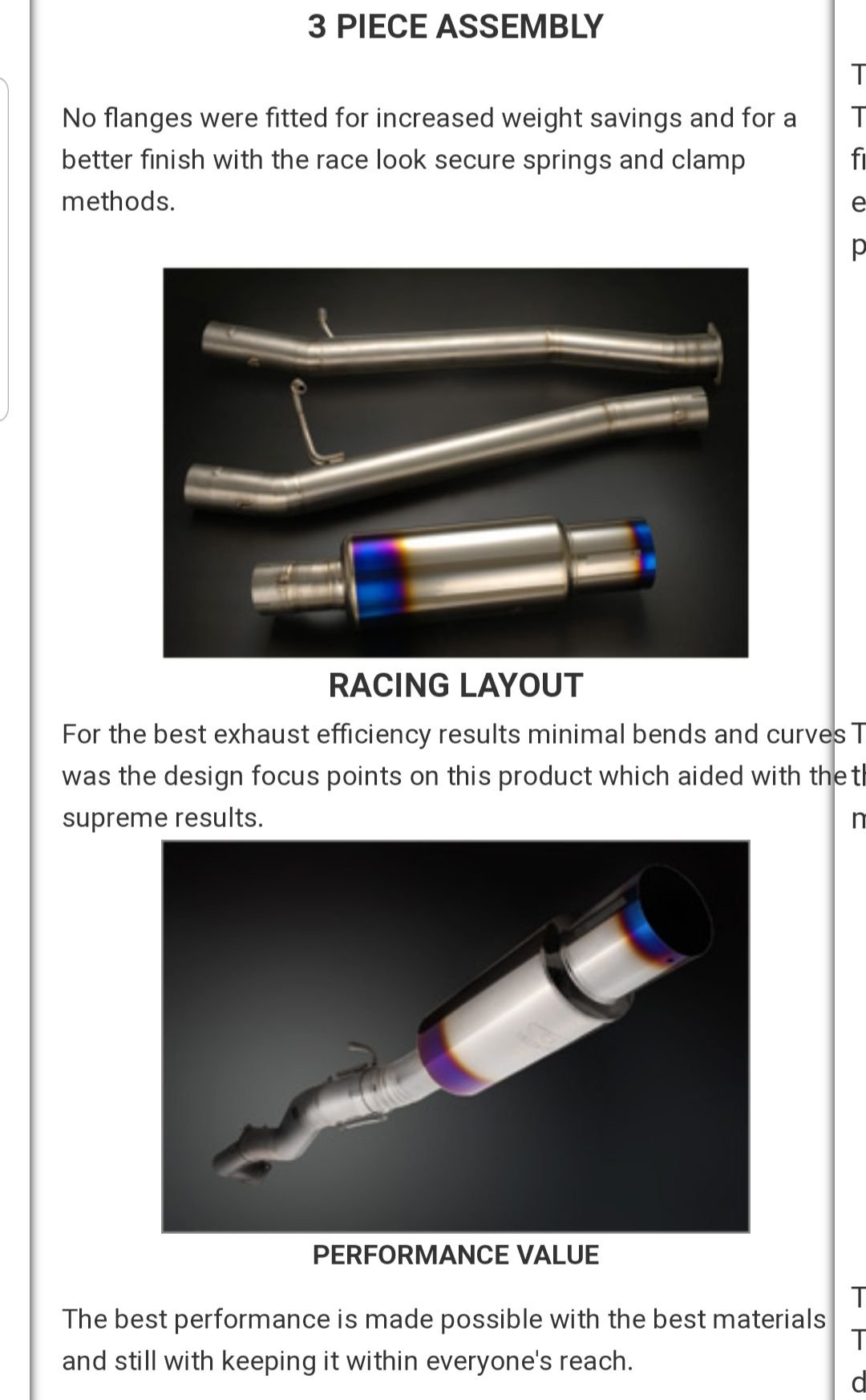

Does the Tomei include just the muffler or the muffler AND mid-pipe? If it has the complete mid-rear setup, you're good from the catalysts back.

Thanks for the advice.
(The car is 15 years old and 90% factory stock.
The primary goal is to replace the old cracked muffler. I understand that this wont be a noticeable performance upgrade but it will make her tone deeper.
I will add pictures below of the parts included in the deal.
1) What am I to do with my current Cat converter setup?
Replace them from Nissan or go a different brand ?
buy and deal with a HFC that has a Check Engine Light solution?
