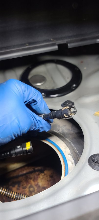

Per title.... I was attempting to replace my fuel pump when I manage to put a hole on the line. Now I am looking for a replacement but with no avail. I have search but no OEM replacement even on Nissans parts/ dealers/ OE websites. Need help. I found the corrugated hose. Need help finding the connector or any some sort of replacement. Thank you in advance!!!!

Replace with rubber and clamp it on?

Ensure the replacement line is fuel resistent both inside and outside

Here is what I have done. Found some corrugated submersible fuel hose and connected to the OE fuel connector. Hose is from this website https://www.racetronix.biz/c/fuel-pu...AAEgLwuPD_BwE#
