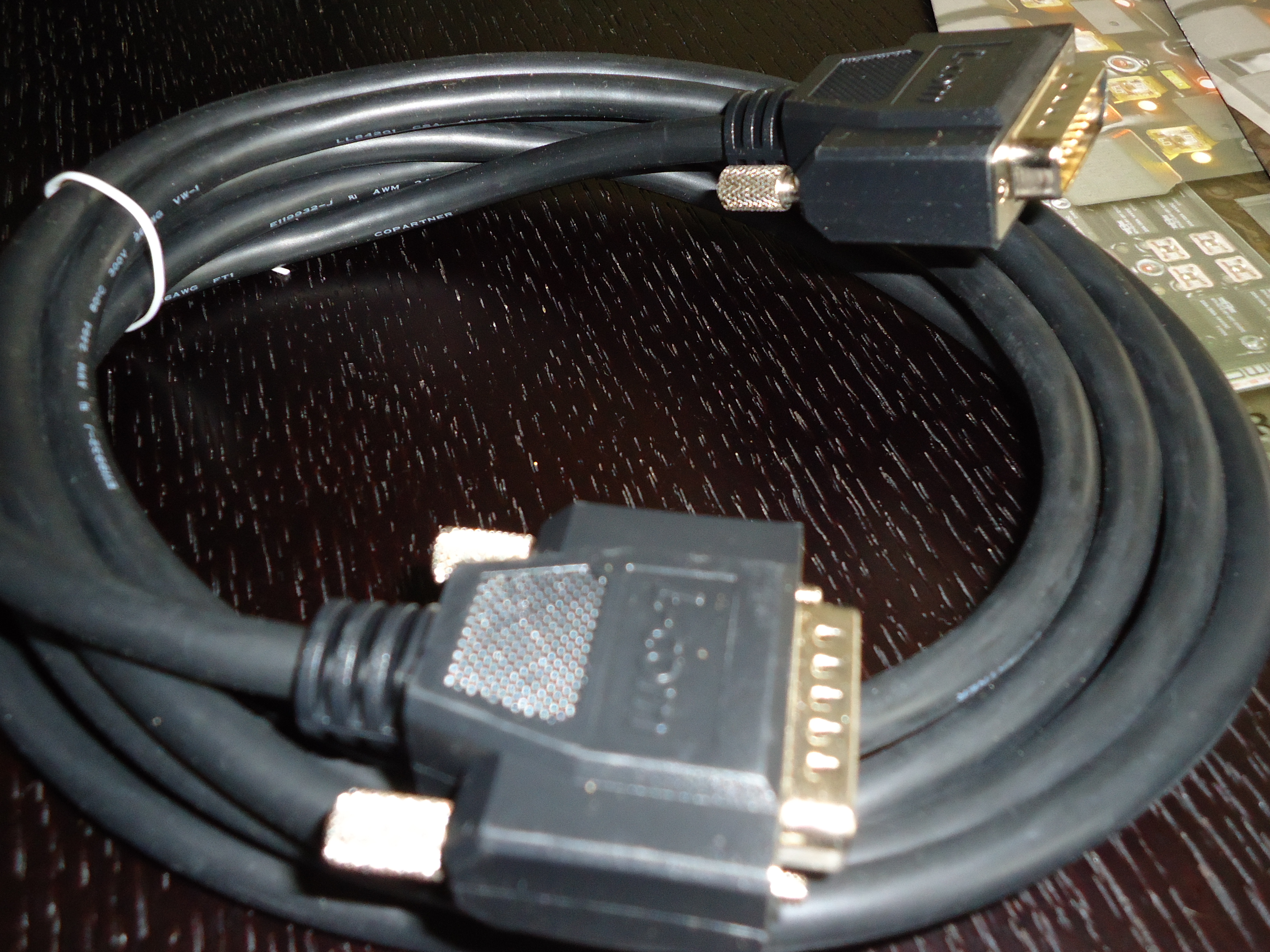

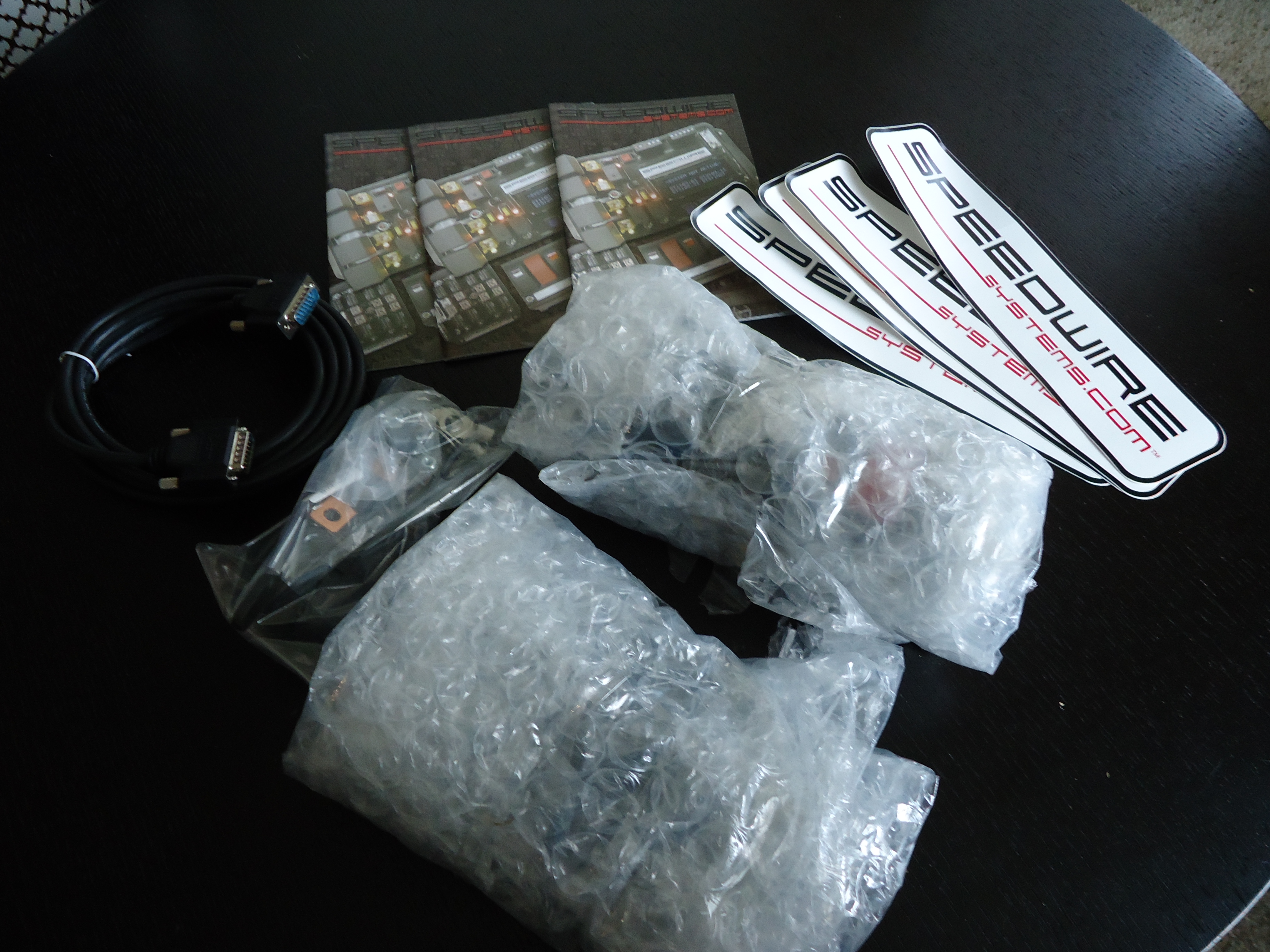

This is what came in the box..

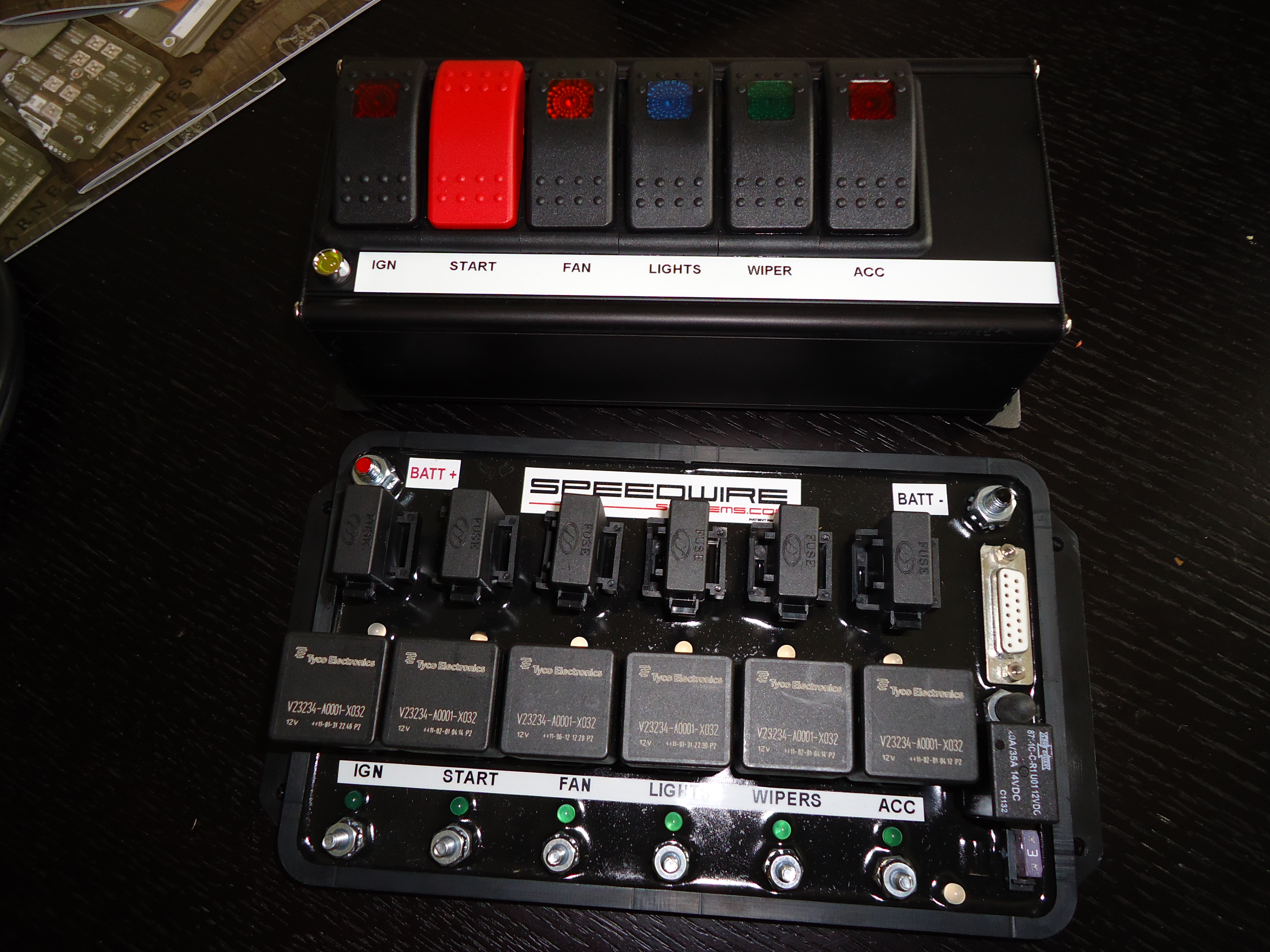

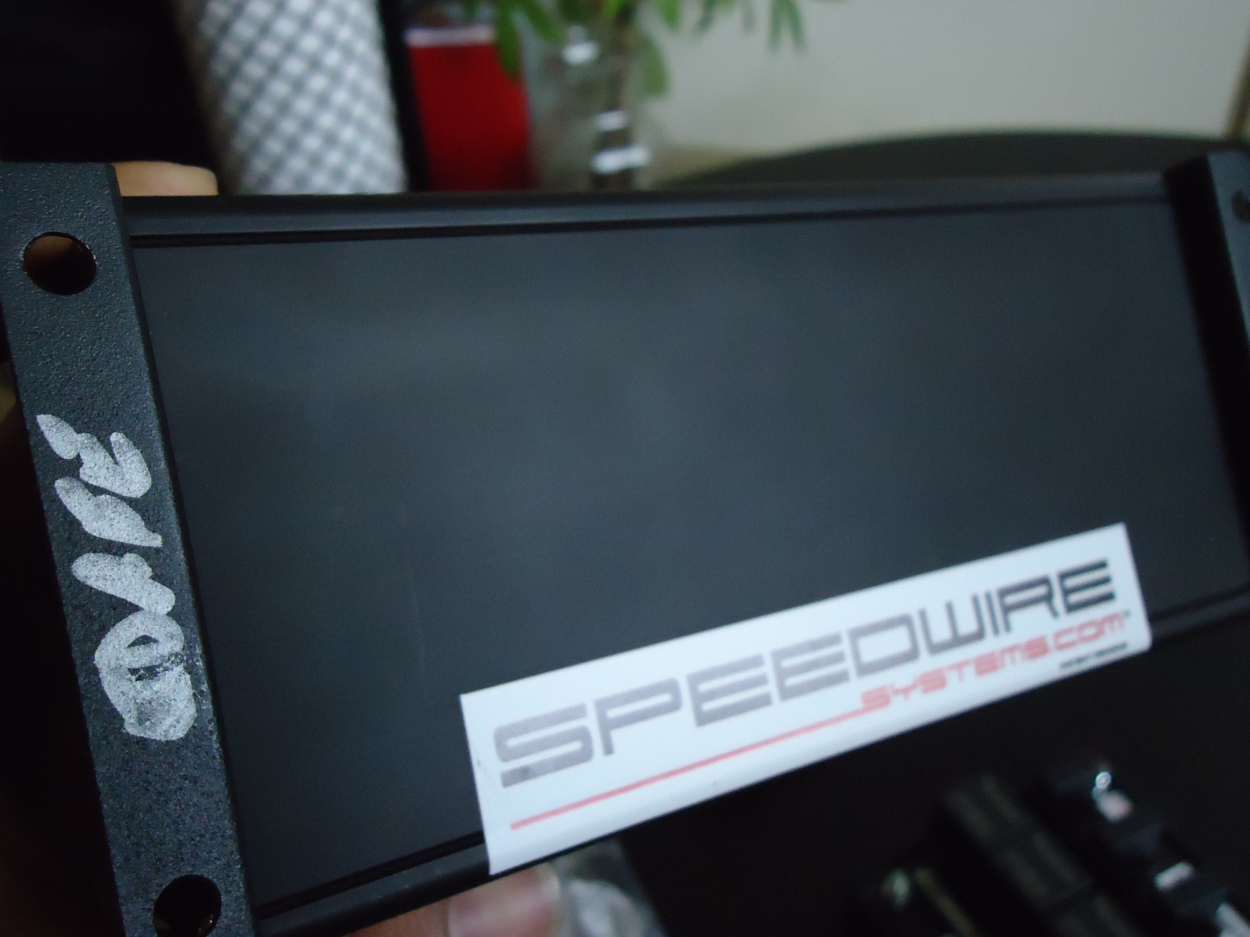

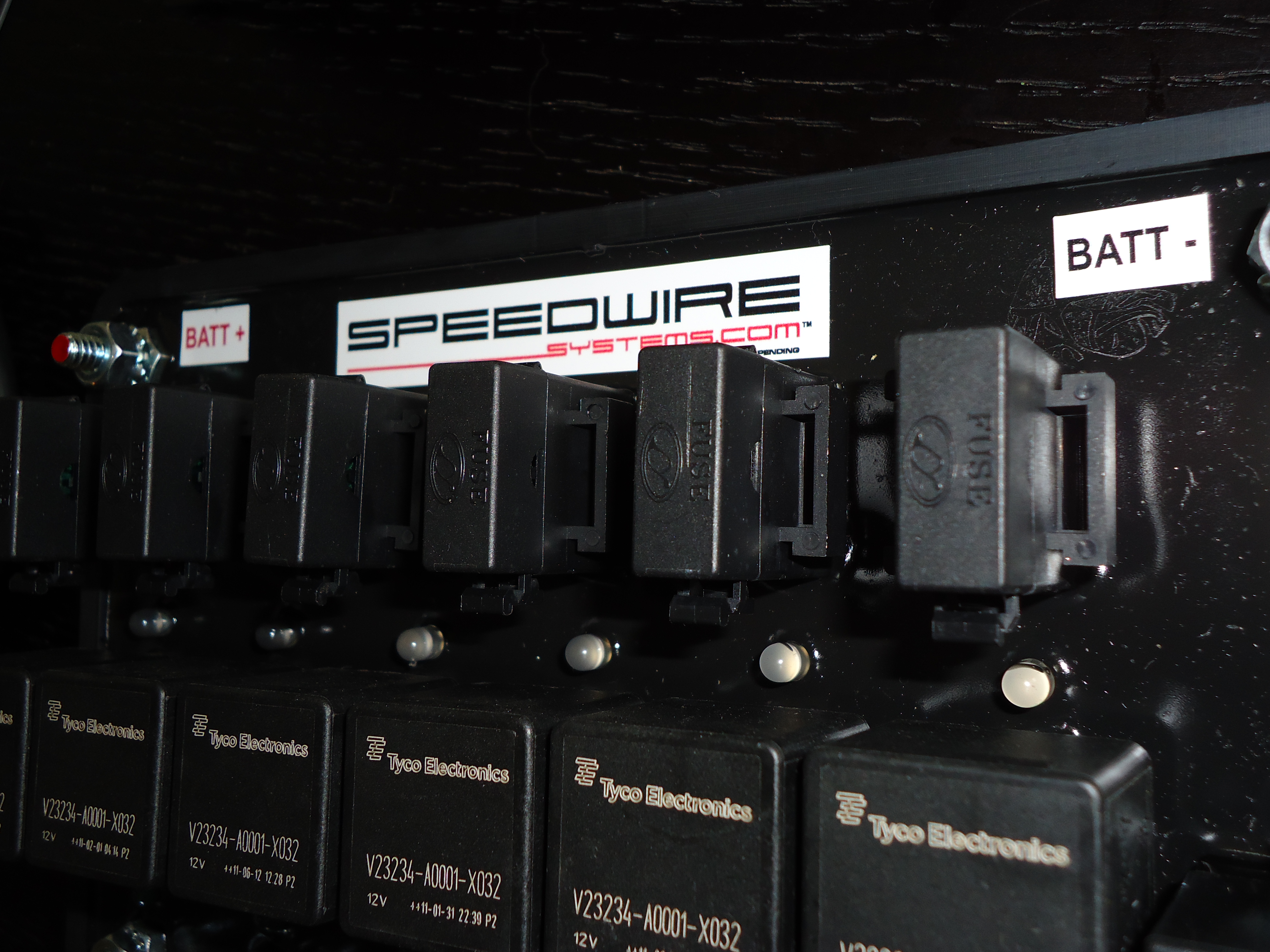

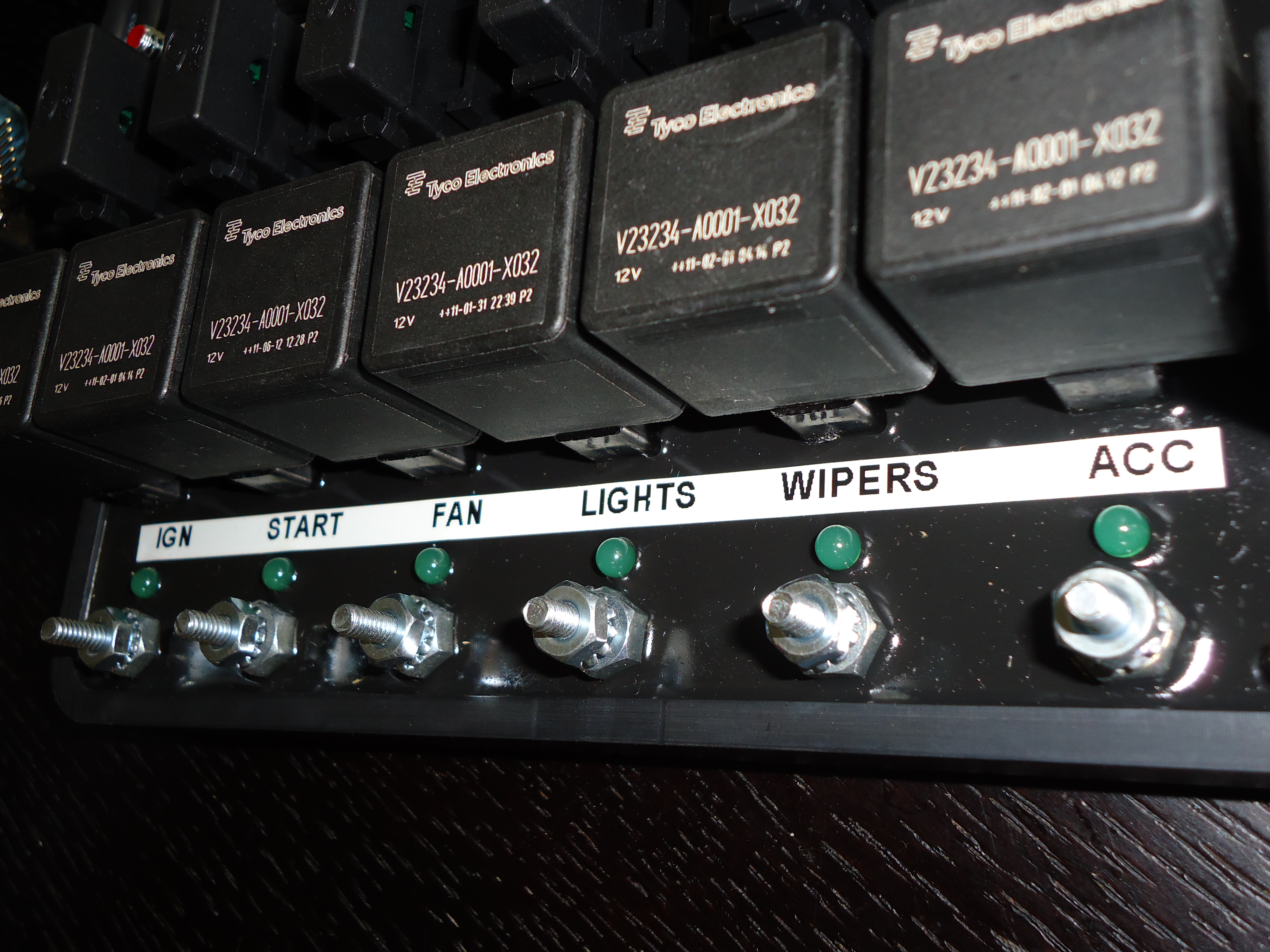

And here it is switch board and mother board.. Here is some stats on the unit:
Main control board system with switch panel made from extruded aluminum and powder coated black
Up to 11 switches to meet your needs
Simple and compact lightweight design
Professionally engineered circuitry
Self-diagnosing LED's for fuse and relay outputs
Flame, moisture and vibration-resistant materials
Flame-retardant epoxy and enclosure UL rating 94V-0
Magneto shut-off module available
switch panel enclosed in extruded aluminum housing
I just needed a 6 switches to get the job done..

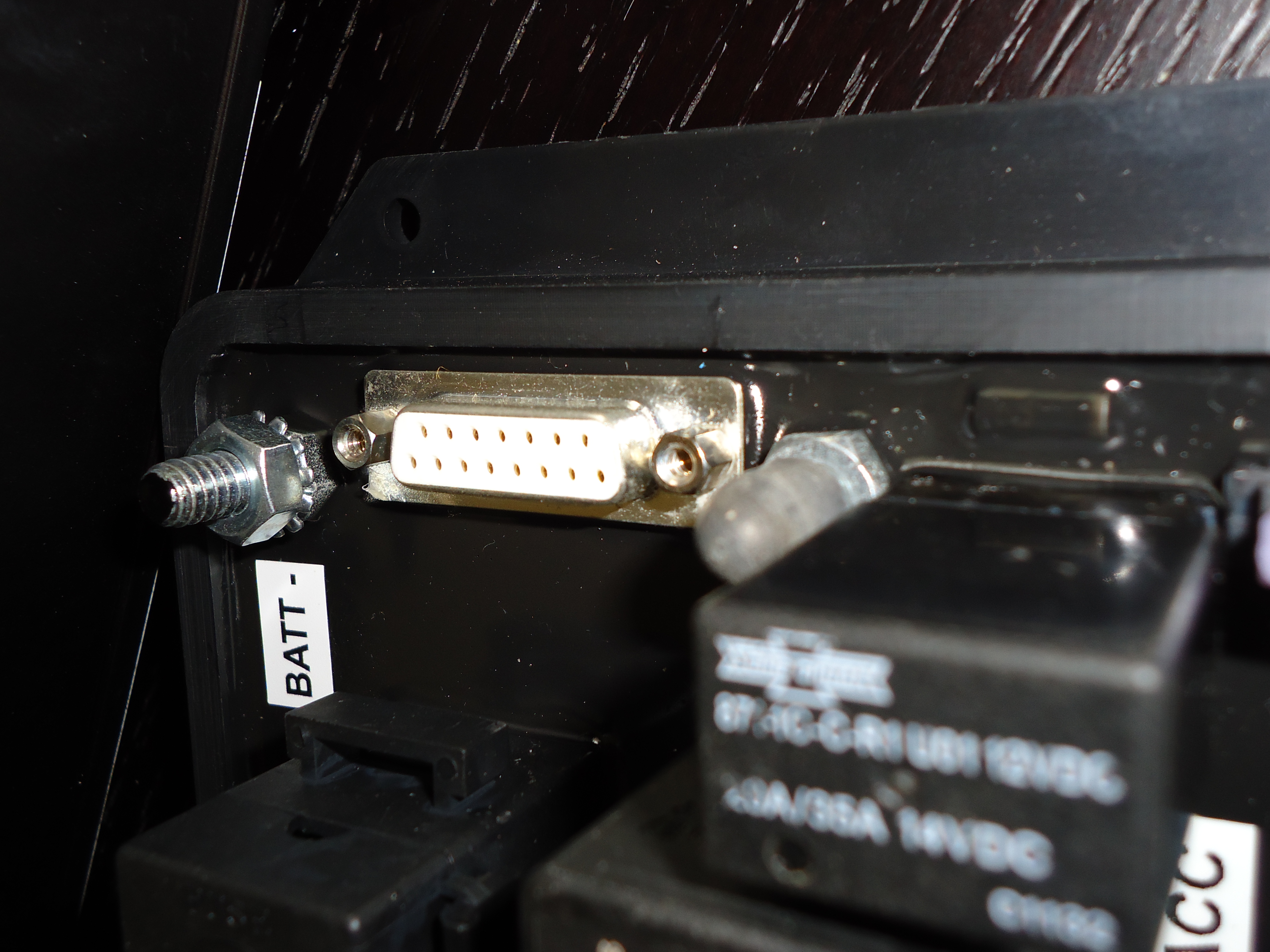

One wire connects the switch panel to the mother board, no need for doing any wiring..
Connection on the mother board..

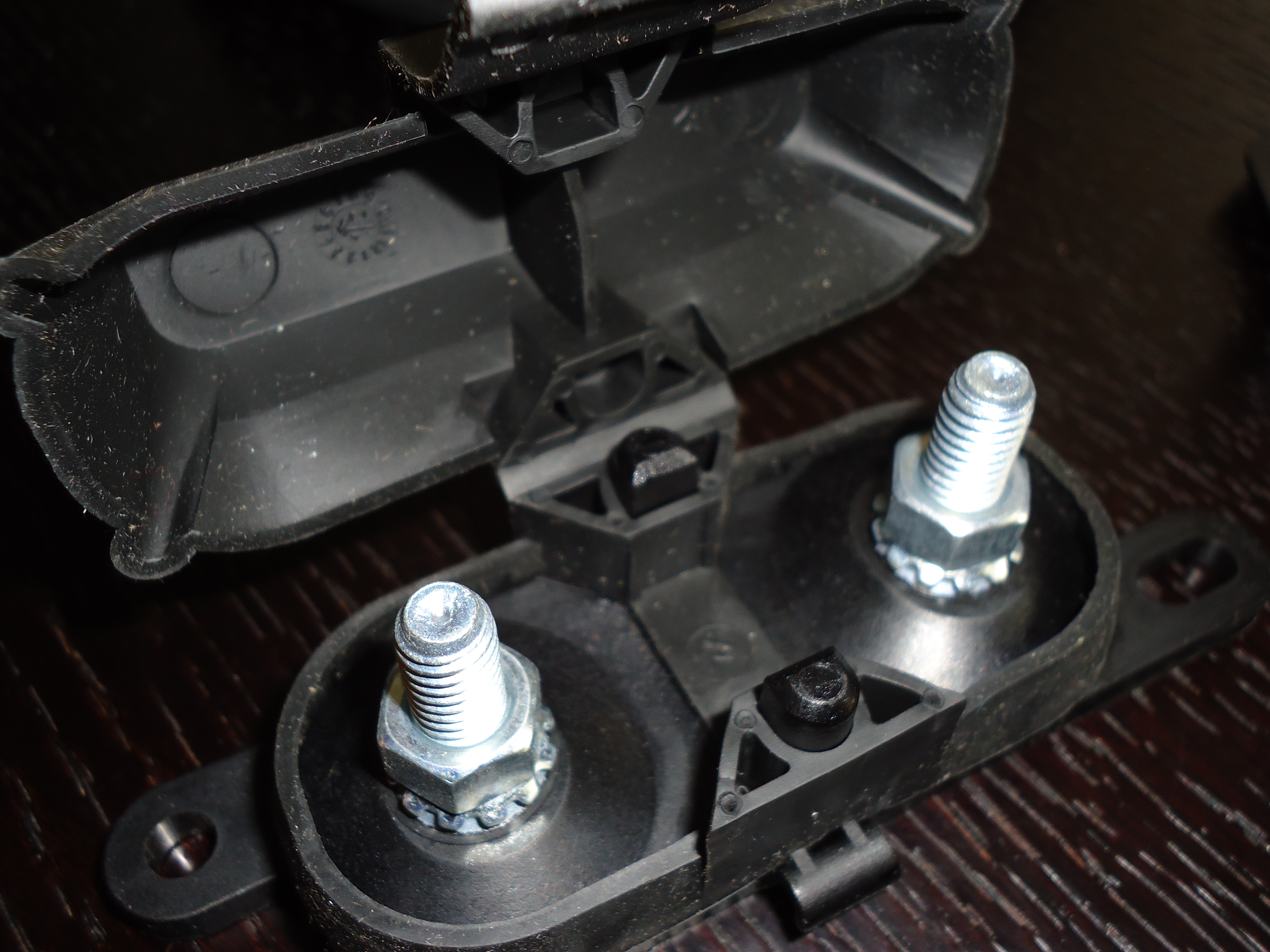

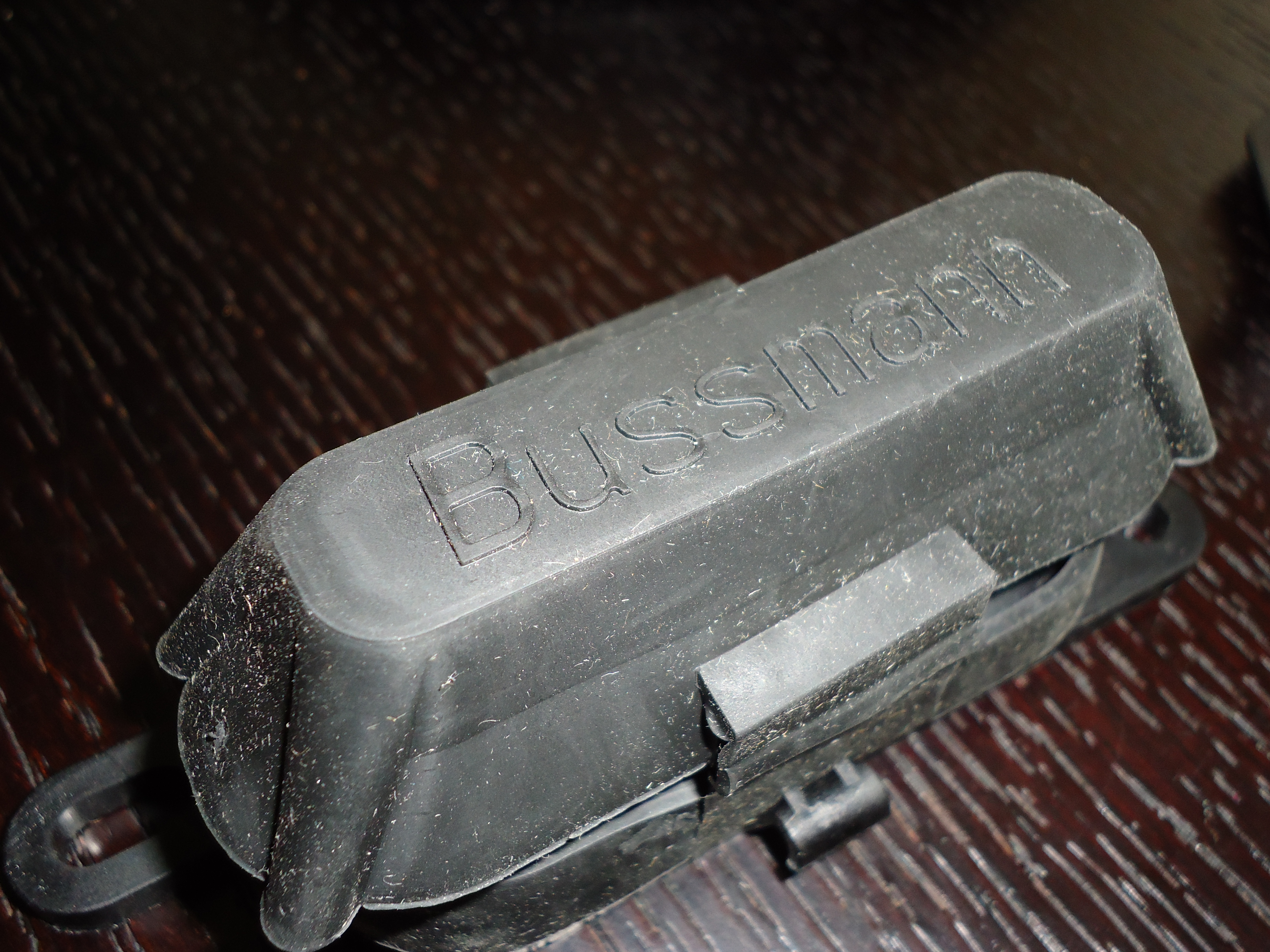

fueses...

The cool thing about this unit is that it is really easy to troubleshoot. With a LED light that indicates the trouble spots. I don't think it gets any better then that.

SpeedWire Systems really take pride in there work and try to work with every customer. As you can see they even place your name on your unit..
SpeedWire 6 relay Panel w/Controller" $765.00

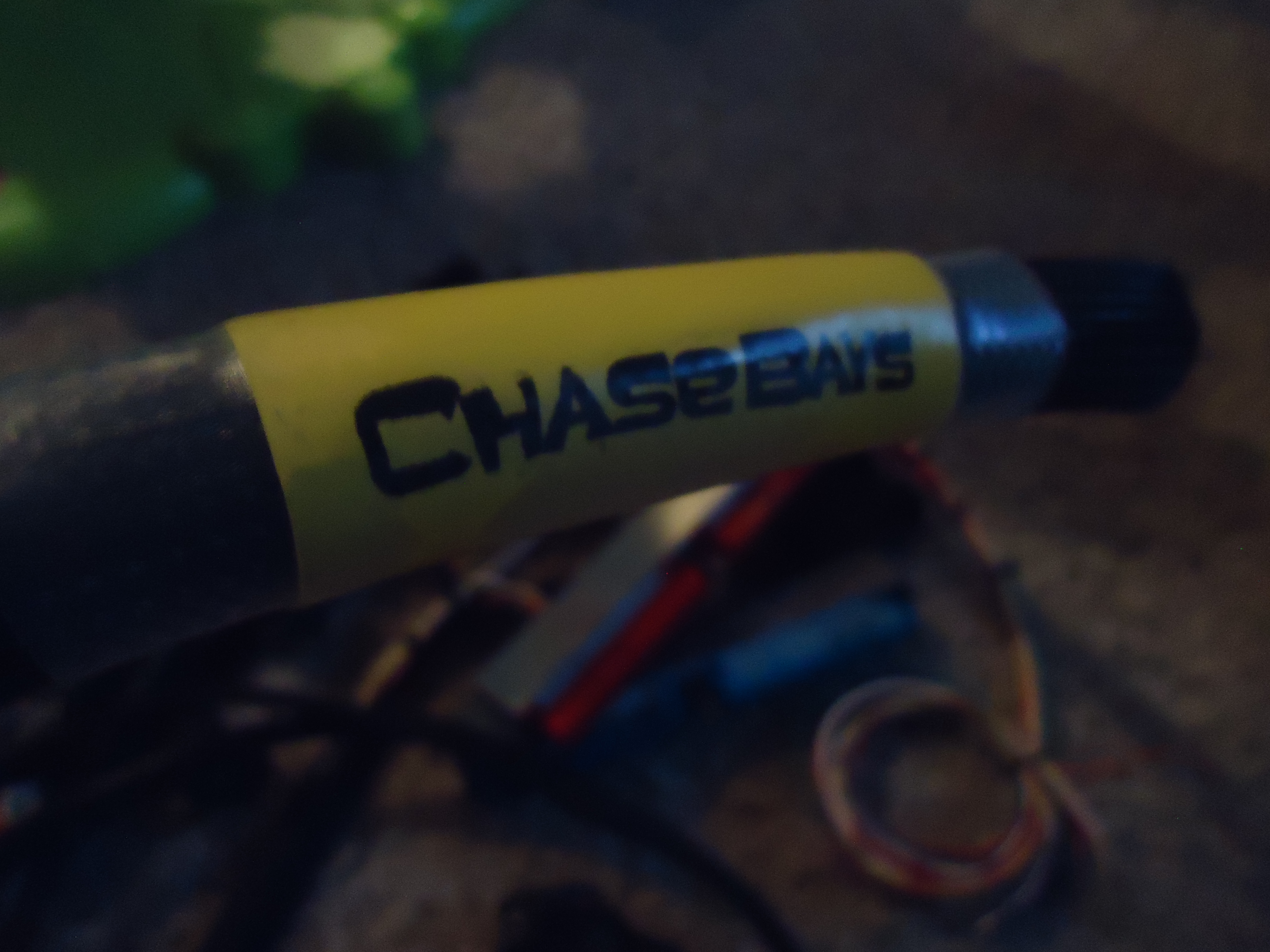

Next I would like to welcome ChaseBays to the build, there was no other company out there I wanted building my harness then them..

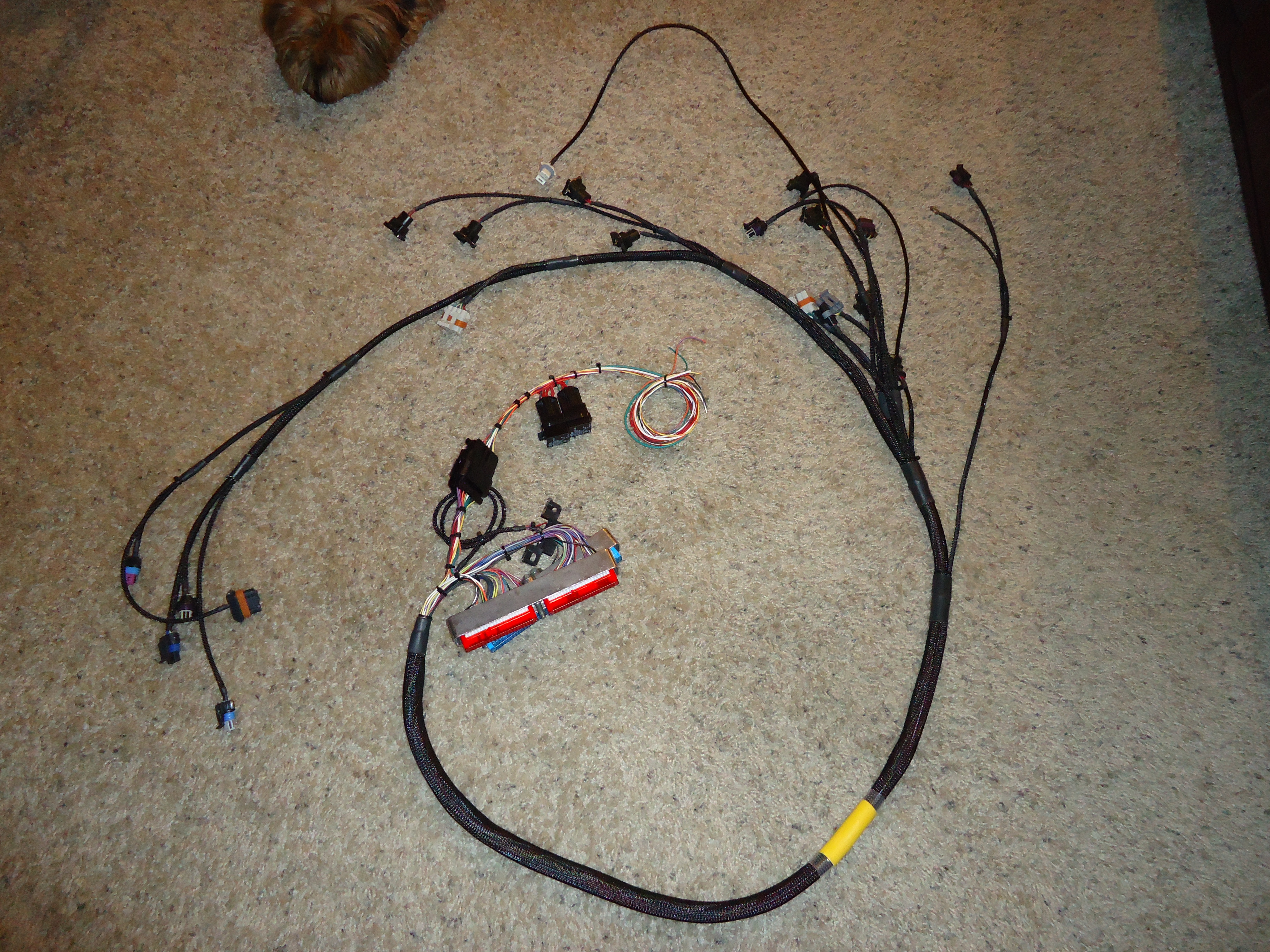

I saw the box and was like, "That's it".. Coming from removing the VQ35 harness which weighed a easy 40lbs...lol to this.. minds got blown...
Stamp of approval.

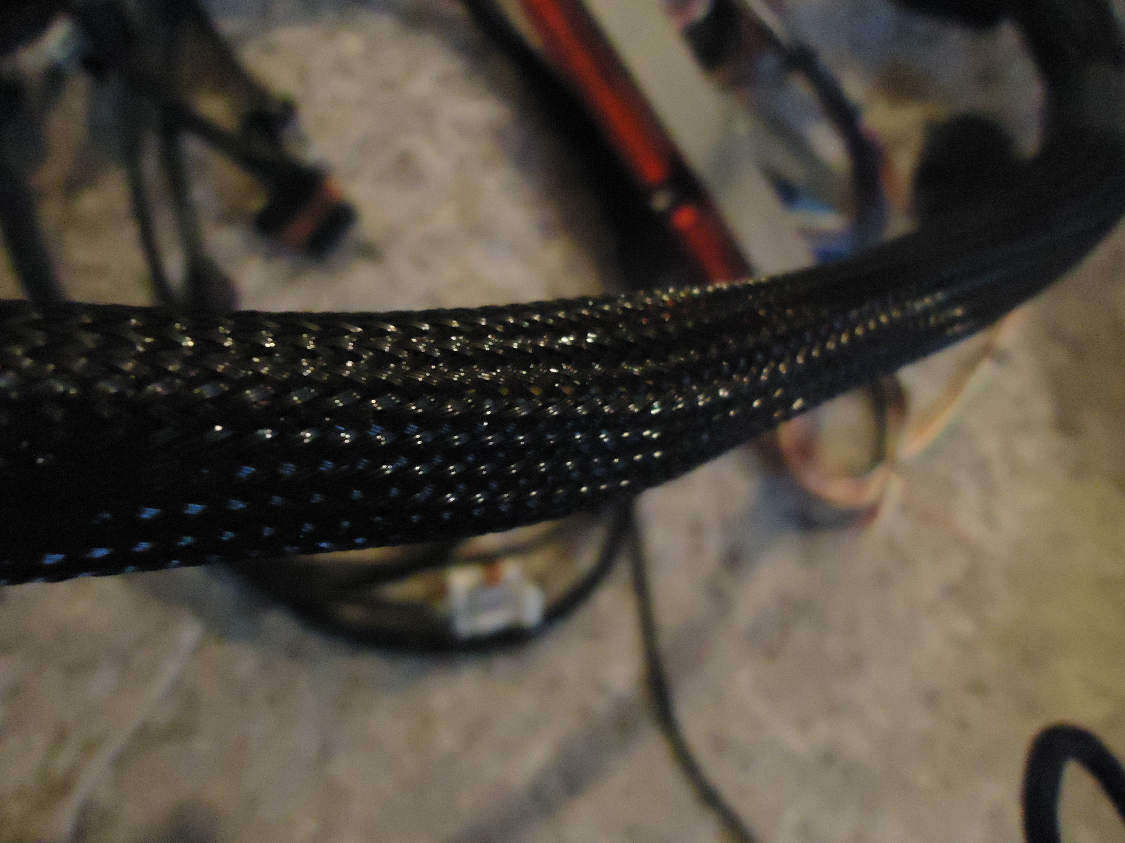

Loomed with Nylon Sleeving and Adhesive Glue Lined Heat shrink

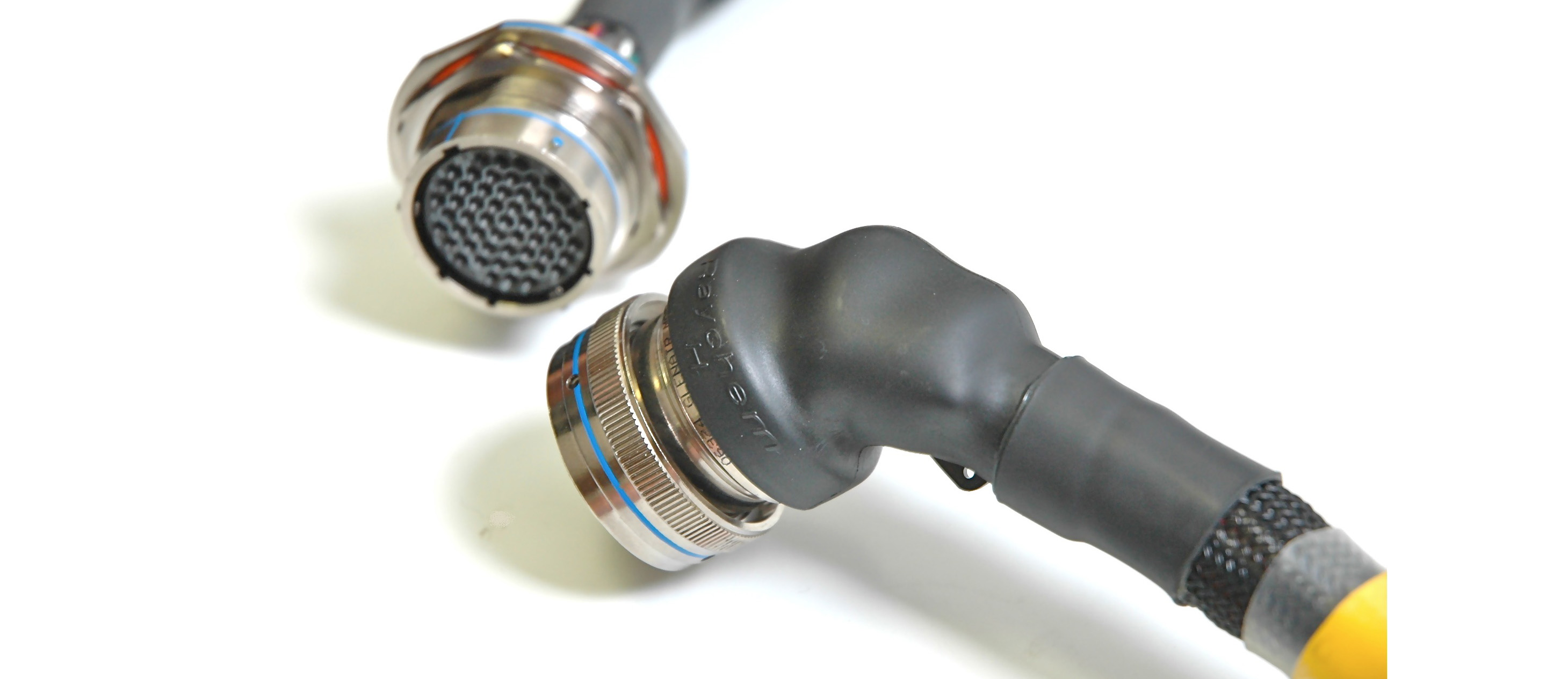

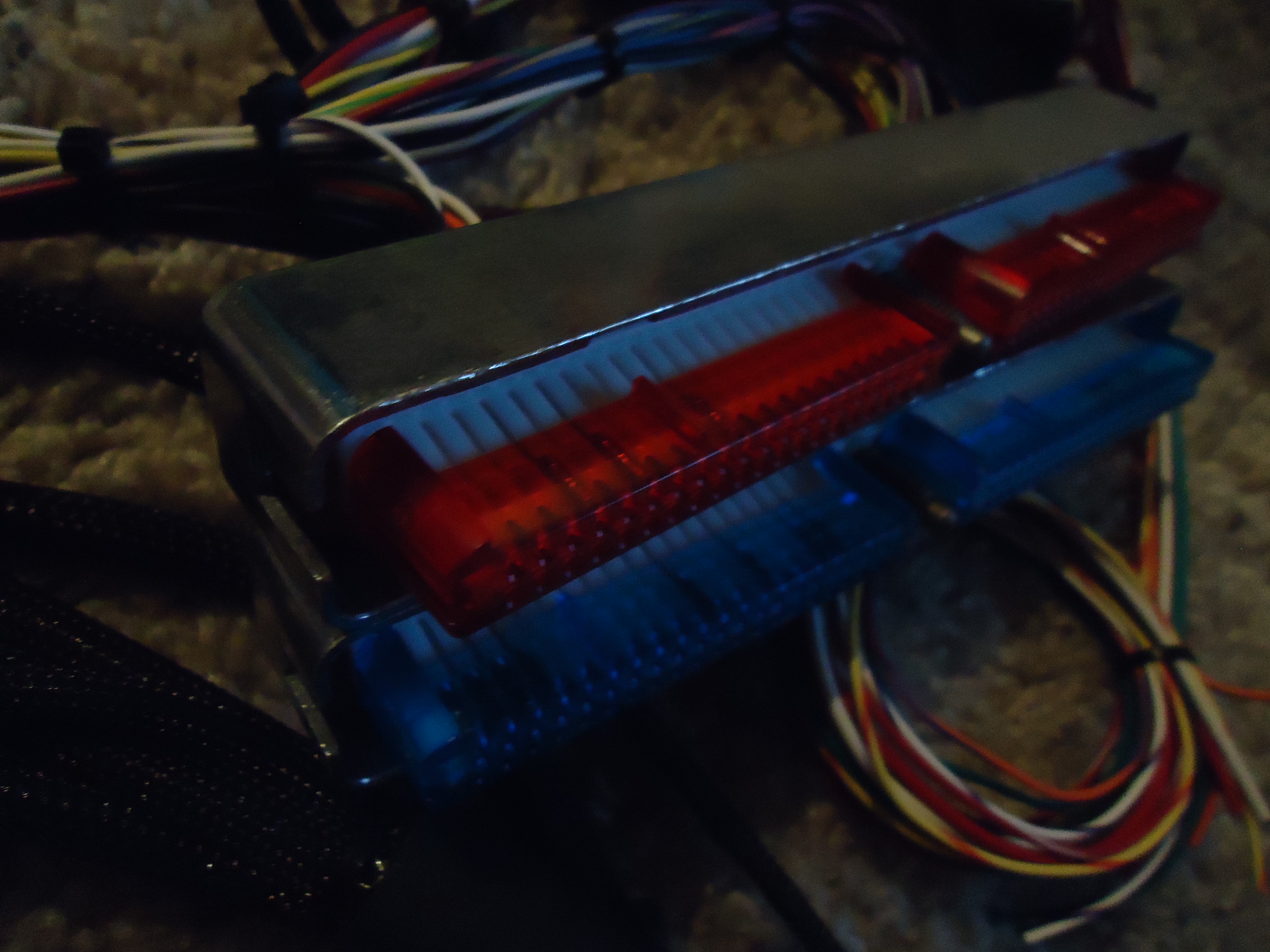

All harness is made to your liking, I had mine setup for Race and wire straight to the GM PCM..

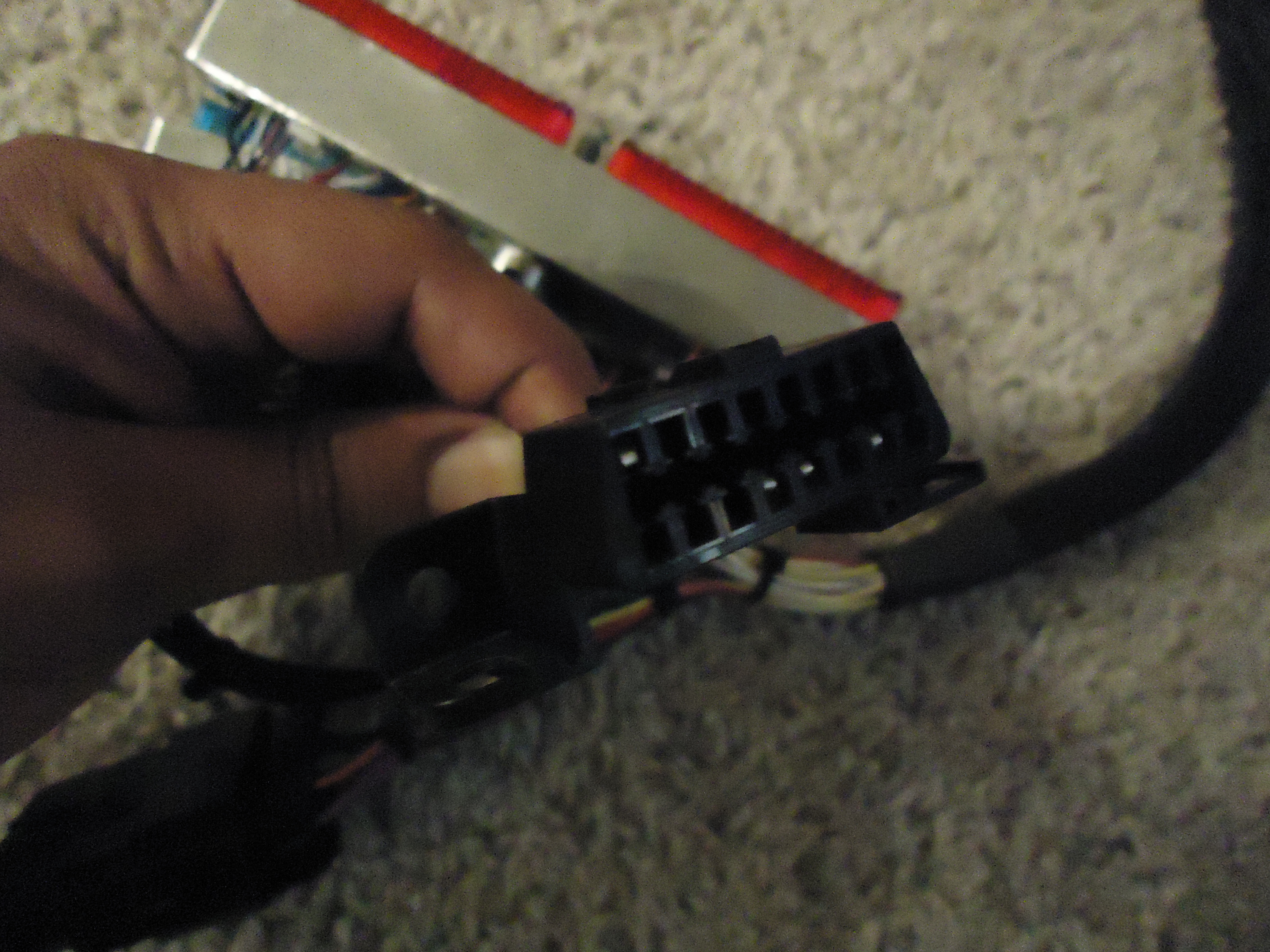

One thing I asked for and I think it comes this way is for the OBD II reader port.. A must have..
Also Made with brand new PLUGS, WIRE, and PINS
They also do a Optional Mil Spec connector for the firewall, nice for engine removal and what not..

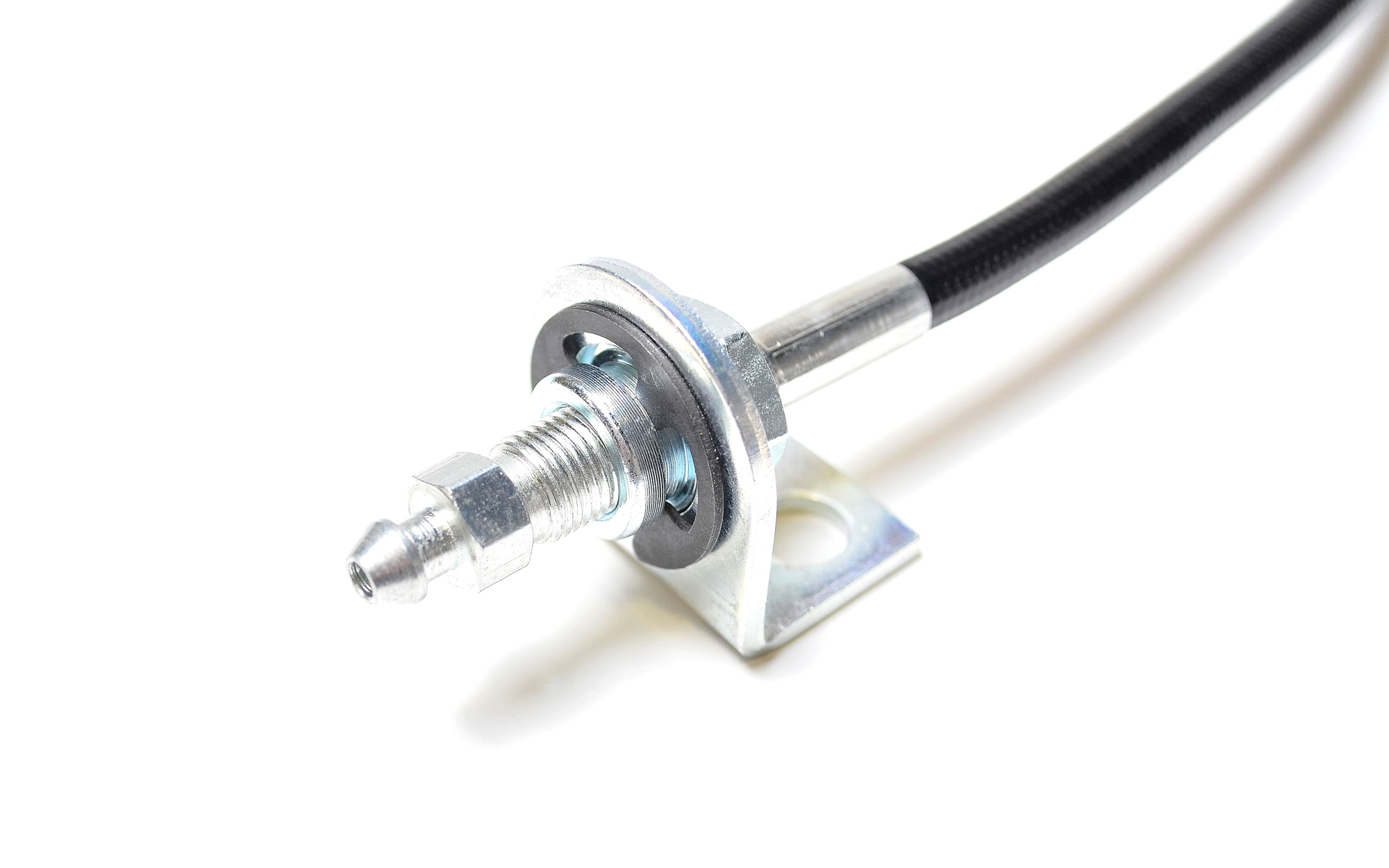

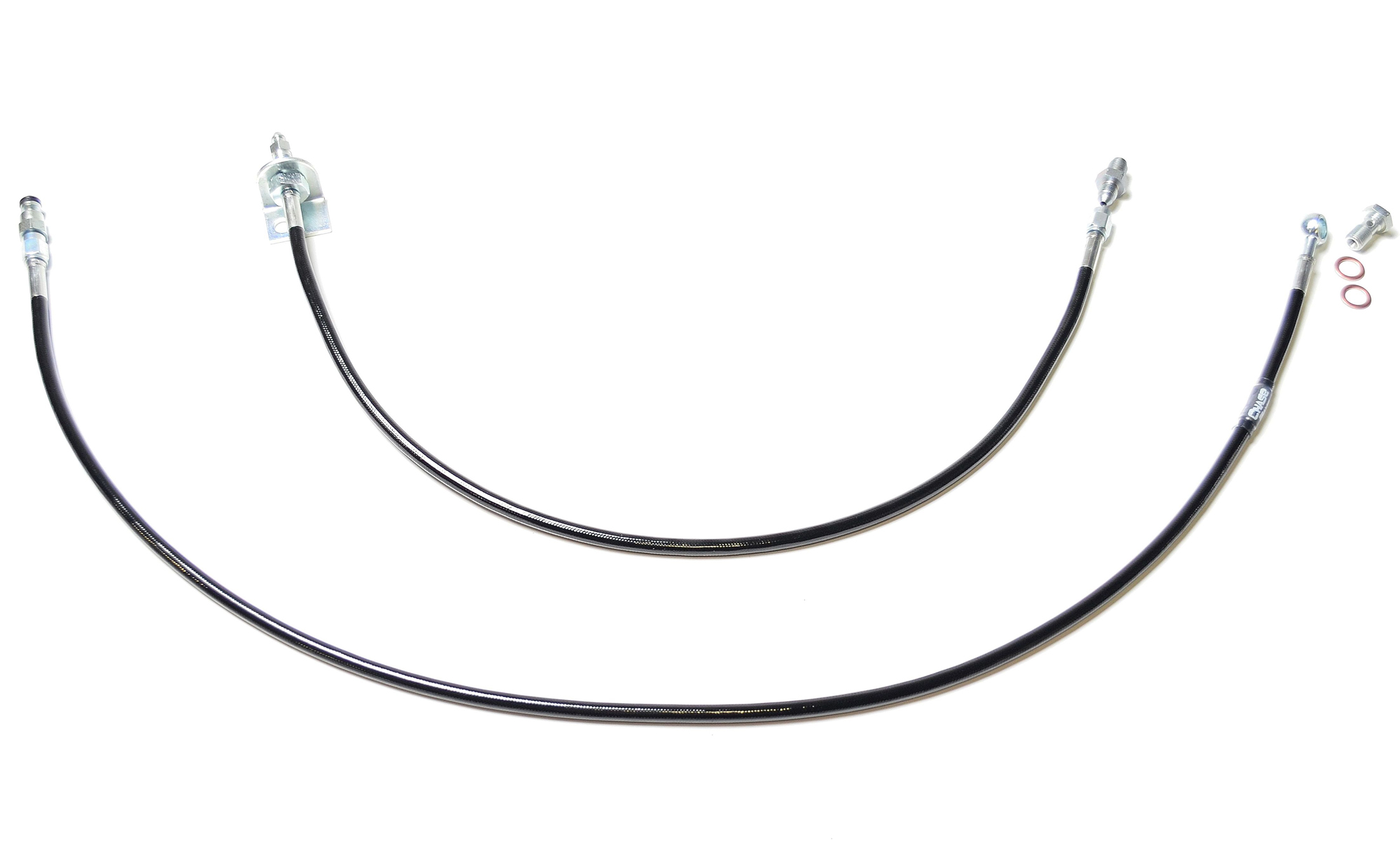

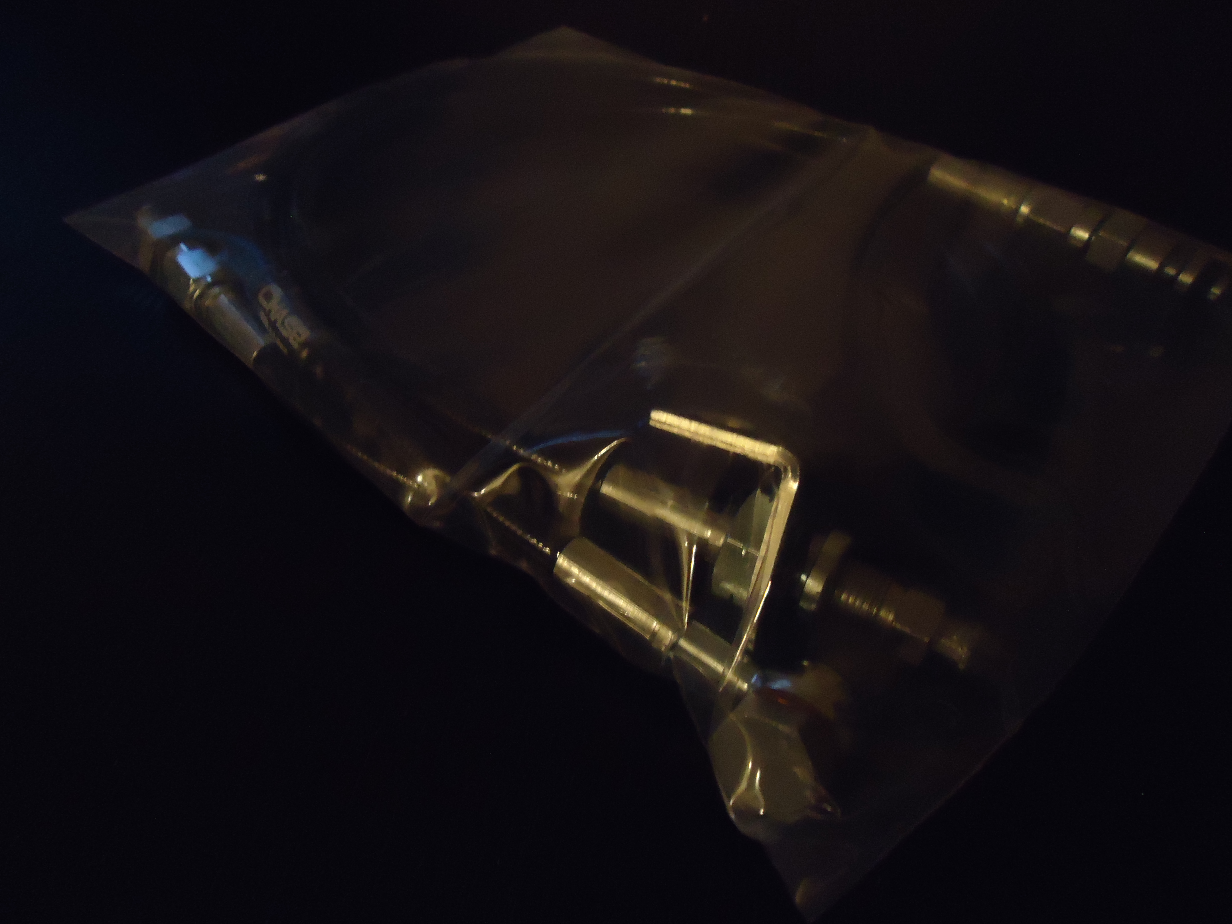

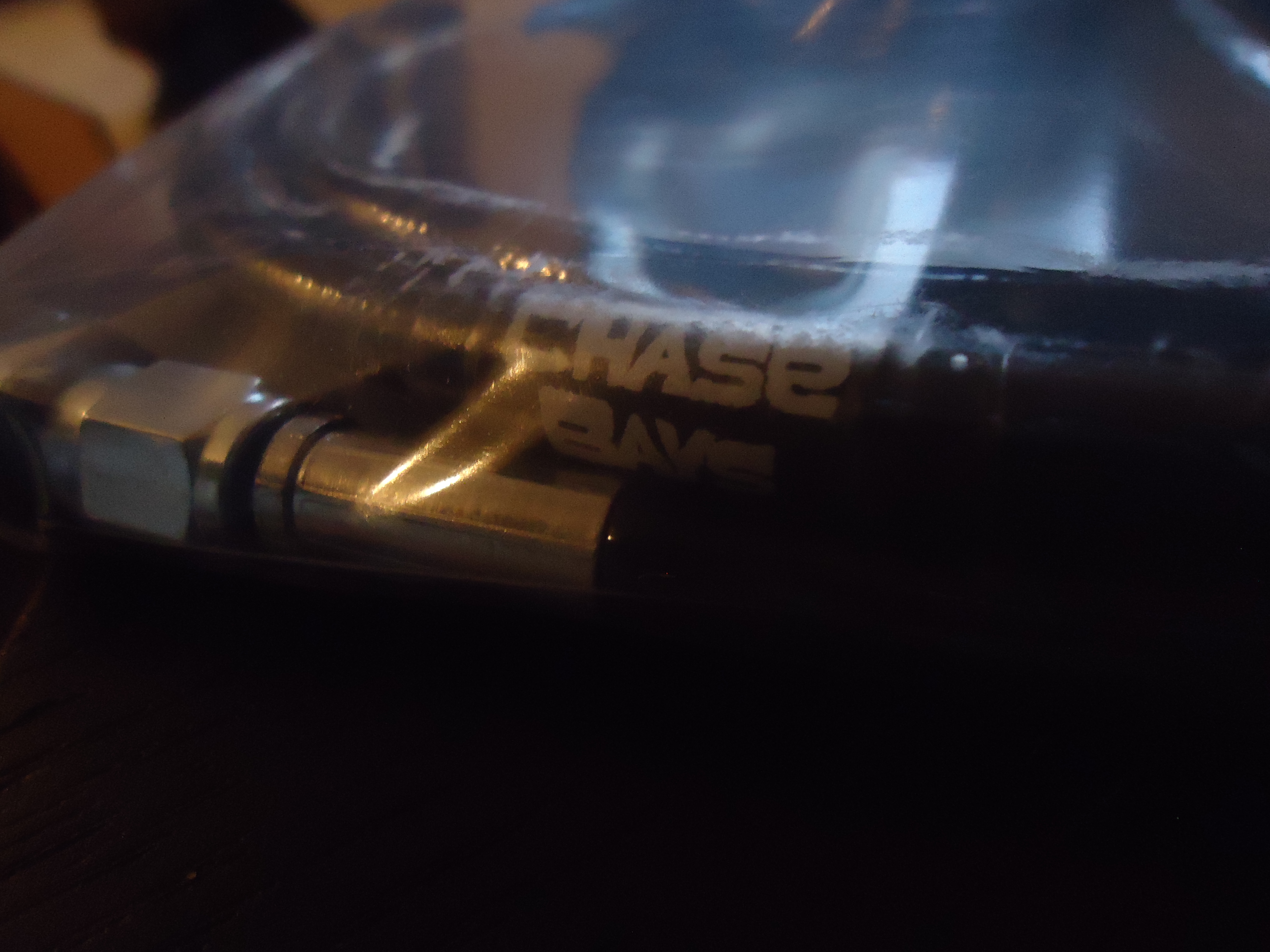

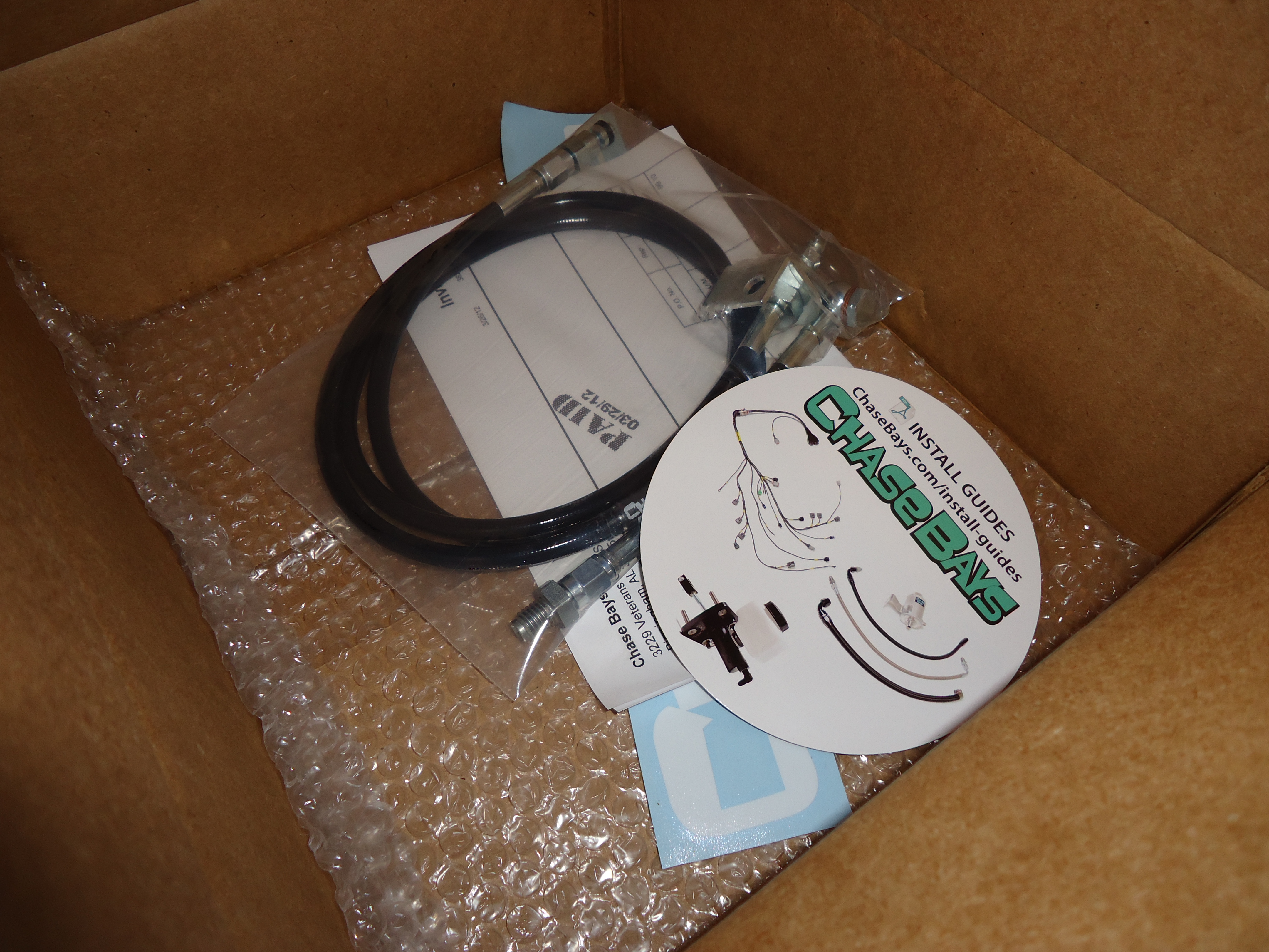

I also picked up their LS1 clutch line..
Packaged and ready to rock..
Some better pics from ChaseBays

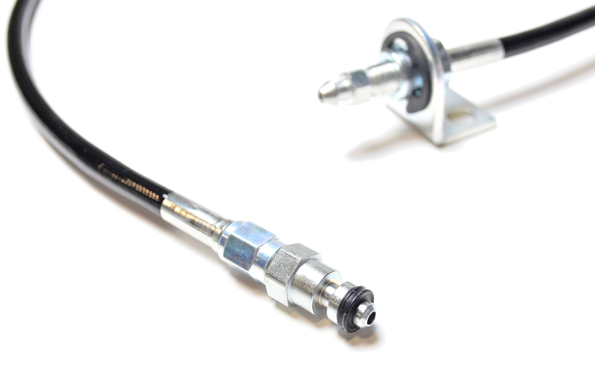

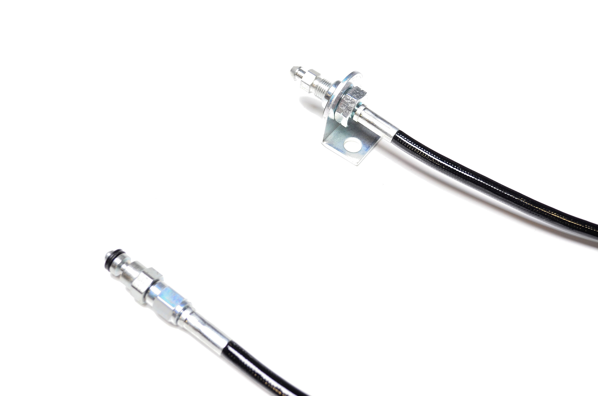

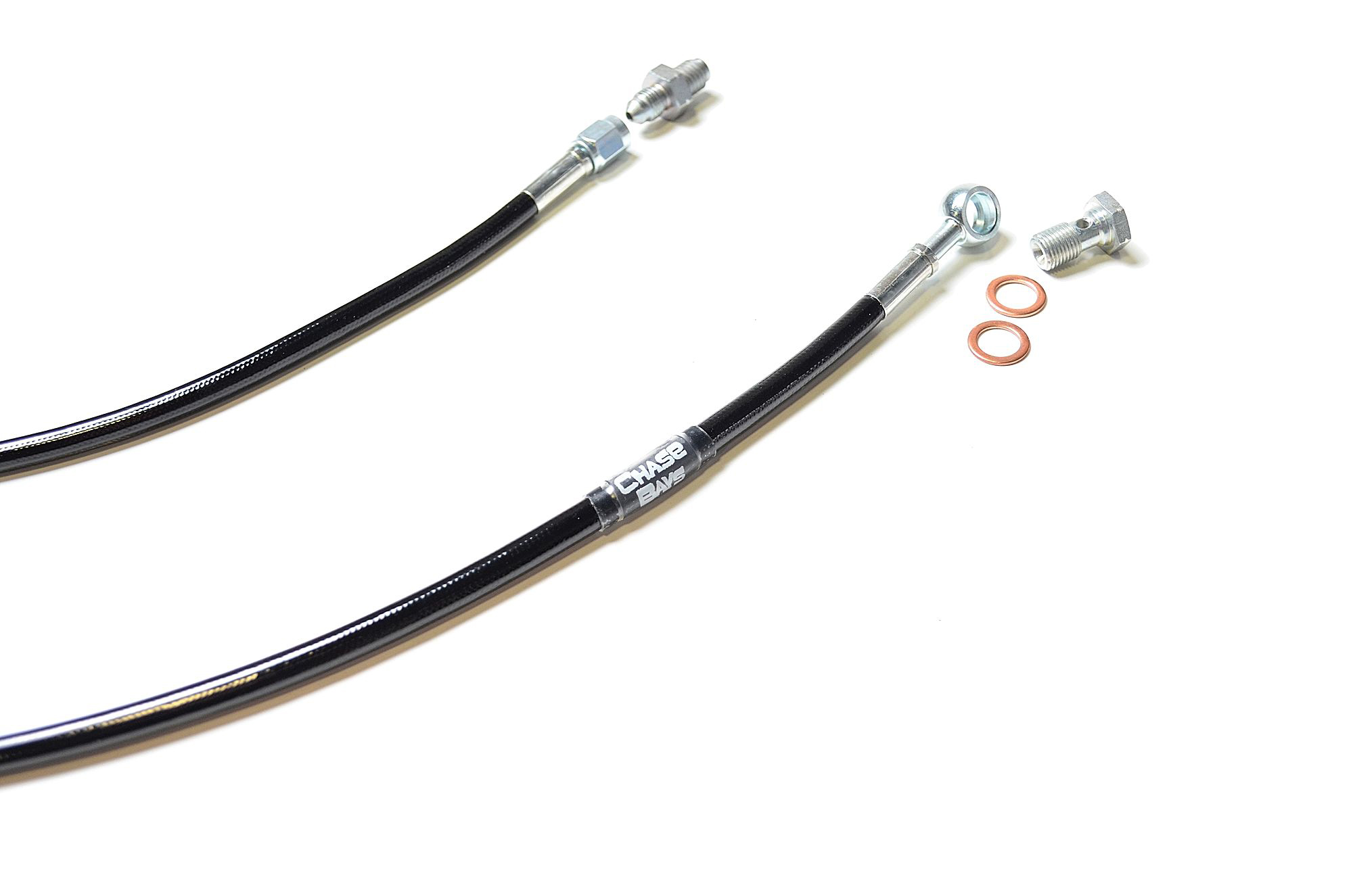

This is a full replacement clutch line and bleeder line. One piece -3AN stainless steel braided teflon coated line from the clutch master cylinder to the slave cylinder in the T56 transmission. The bleeder line is 16" long with a bracket pre-installed to attach to your transmission for easy bleeding. Eliminate the clutter and weight of the OEM hard line, soft line, and bracket. Our clutch line is great looking, saves weight, improves pedal feel, and improves clutch engagement.
Chase Bays Engine Harness - GM LS1 | LS6: Starting at $599.99
Chase Bays Clutch Line - Nissan 350Z/G35 w/ LS1 T56: $99.99

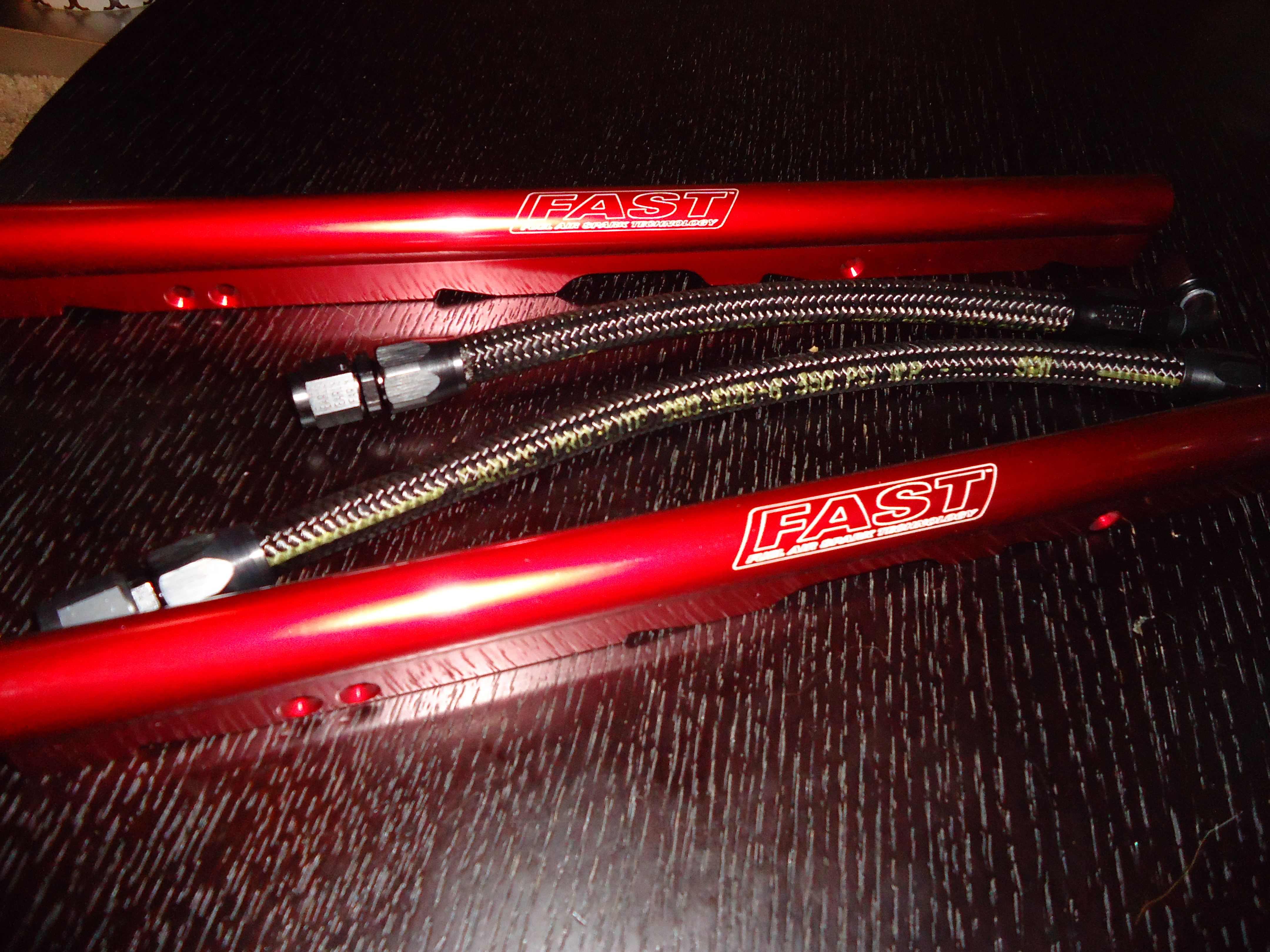

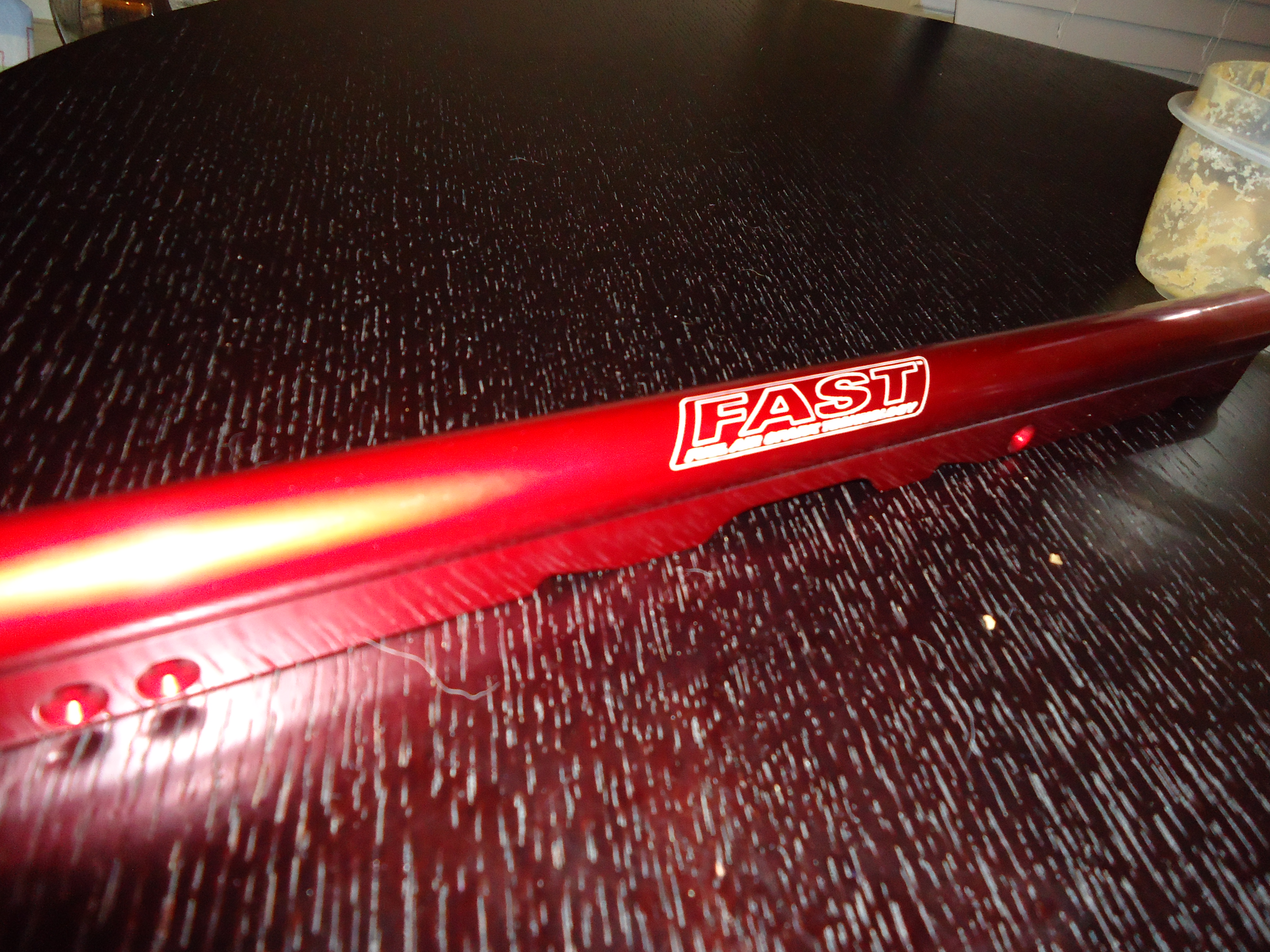

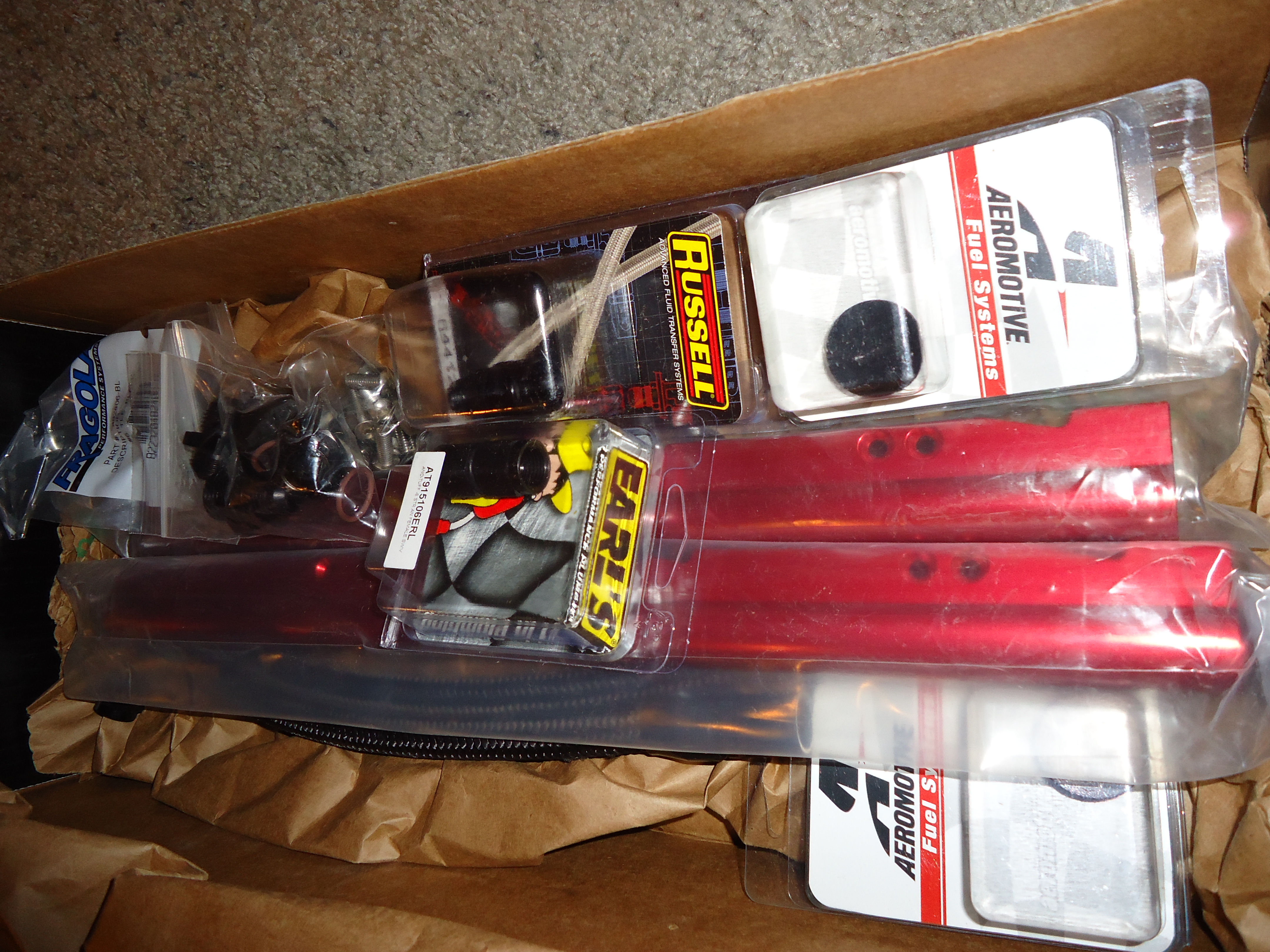

Next on the list was upgrading my fuel rails, chose to go with the Vengeance Racing Kit. Prb going to change the setup but oh well..
Comes with FAST billet fuel rails and all fittings needed.
Going to look so much better then the OEM FAST rail..
This is how it looks installed.
Vengeance Racing/FAST LSXR Billet Fuel Rail Kit: $399.99

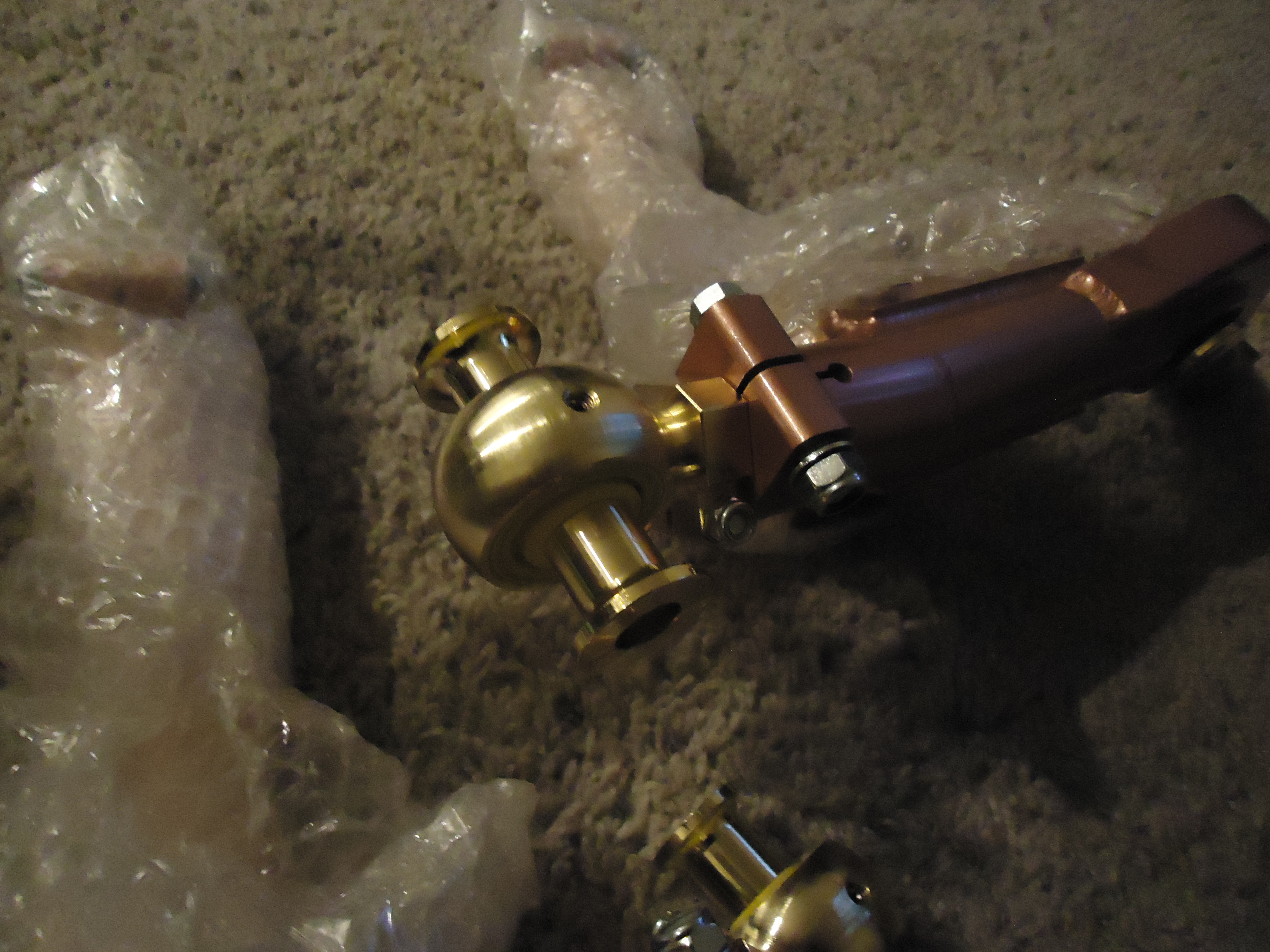

Next on the list was my Power By Max Super Angle kit for the Z33. If you guys have not seen this in action just watch Ryan Kado's vids. He is rocking the same kit.
Can't wait to mount these suckers up
Going to have to run S14 inner tie rods and cut them done with this kit. Could run Z33s but they suggested running the S14 for more adjustablty.
Power By Max Super Angel kit: $800

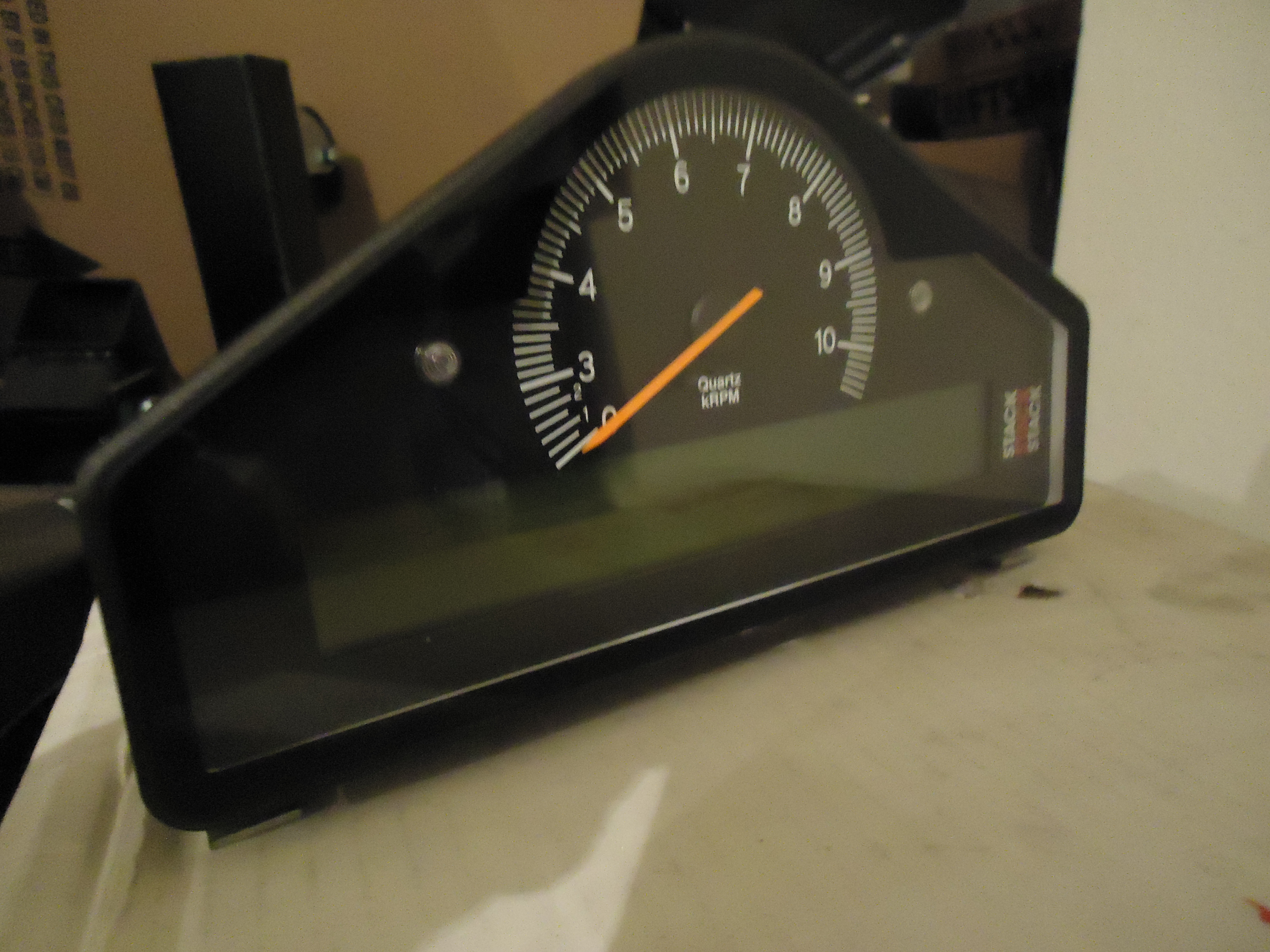

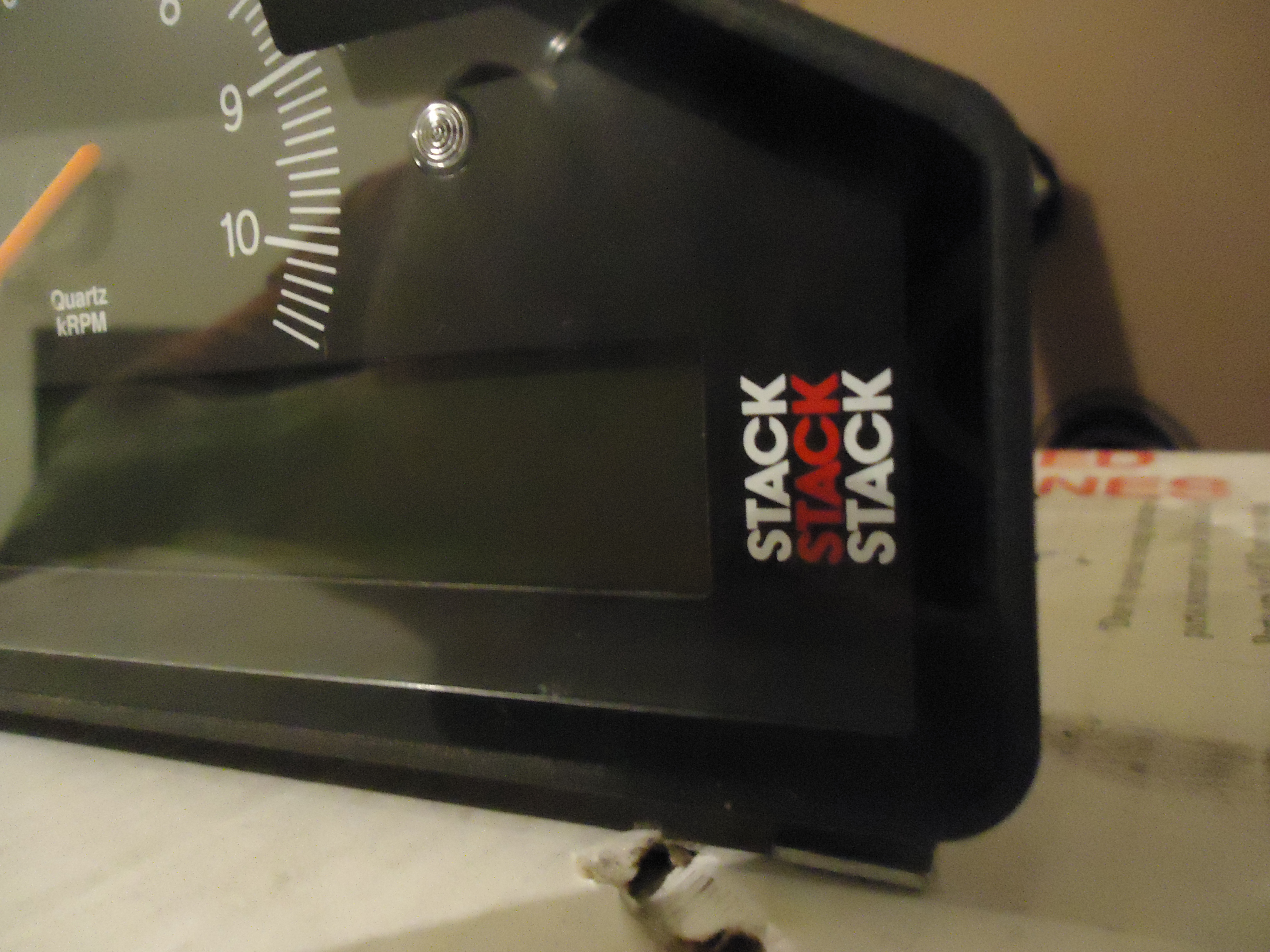

Picked up this sick Stack 81300 for a good price.. Going to make life so much easier with this..
Stack 81300: $1100

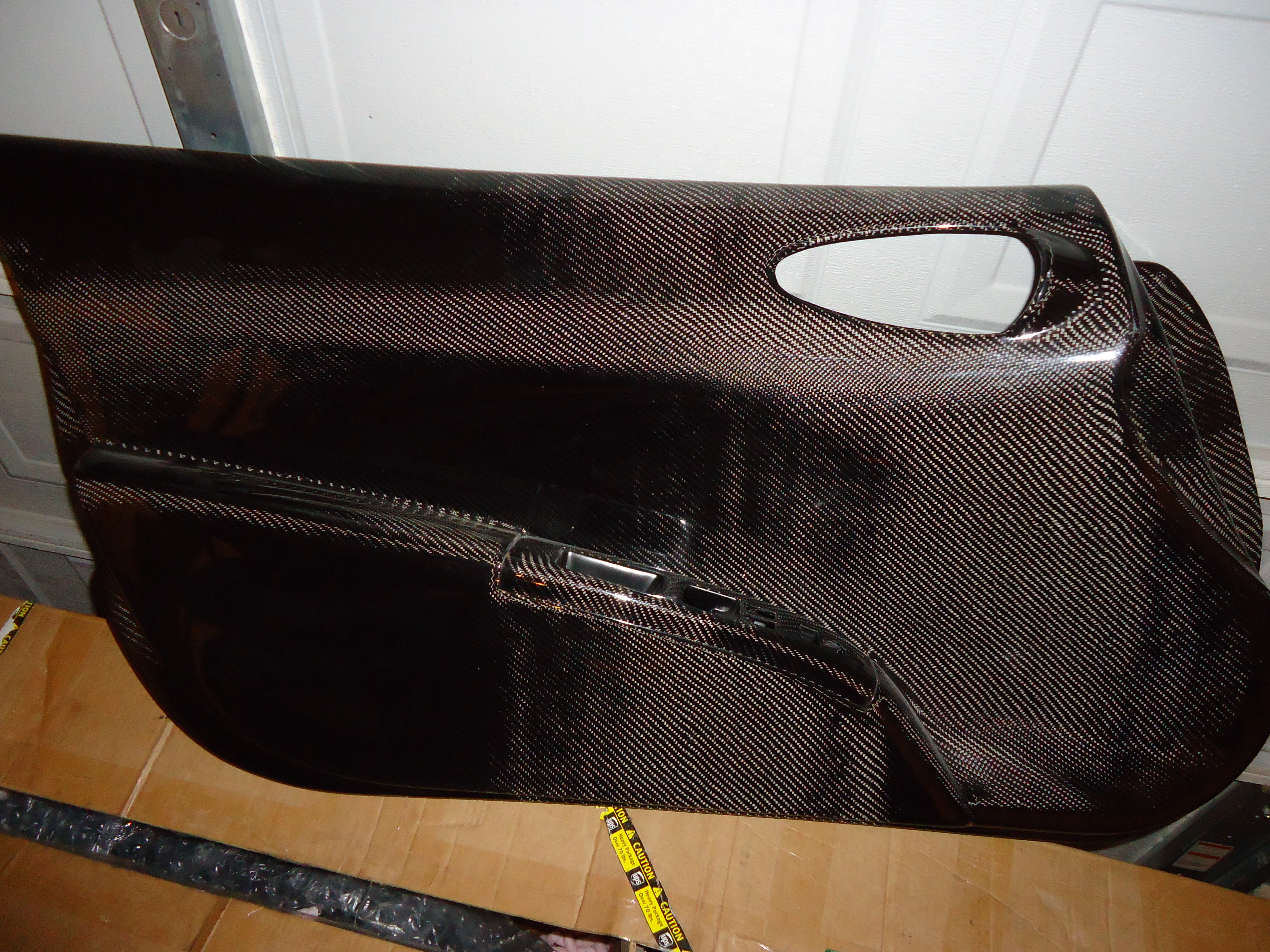

So these Carbon fiber door panels was kind of a impulse buy. Was a great deal though..lol
Wanted to do my own CF panels but this will work.. Going to have to cut out a opening for the door bars though..
Carbon Fiber door Panels: $350

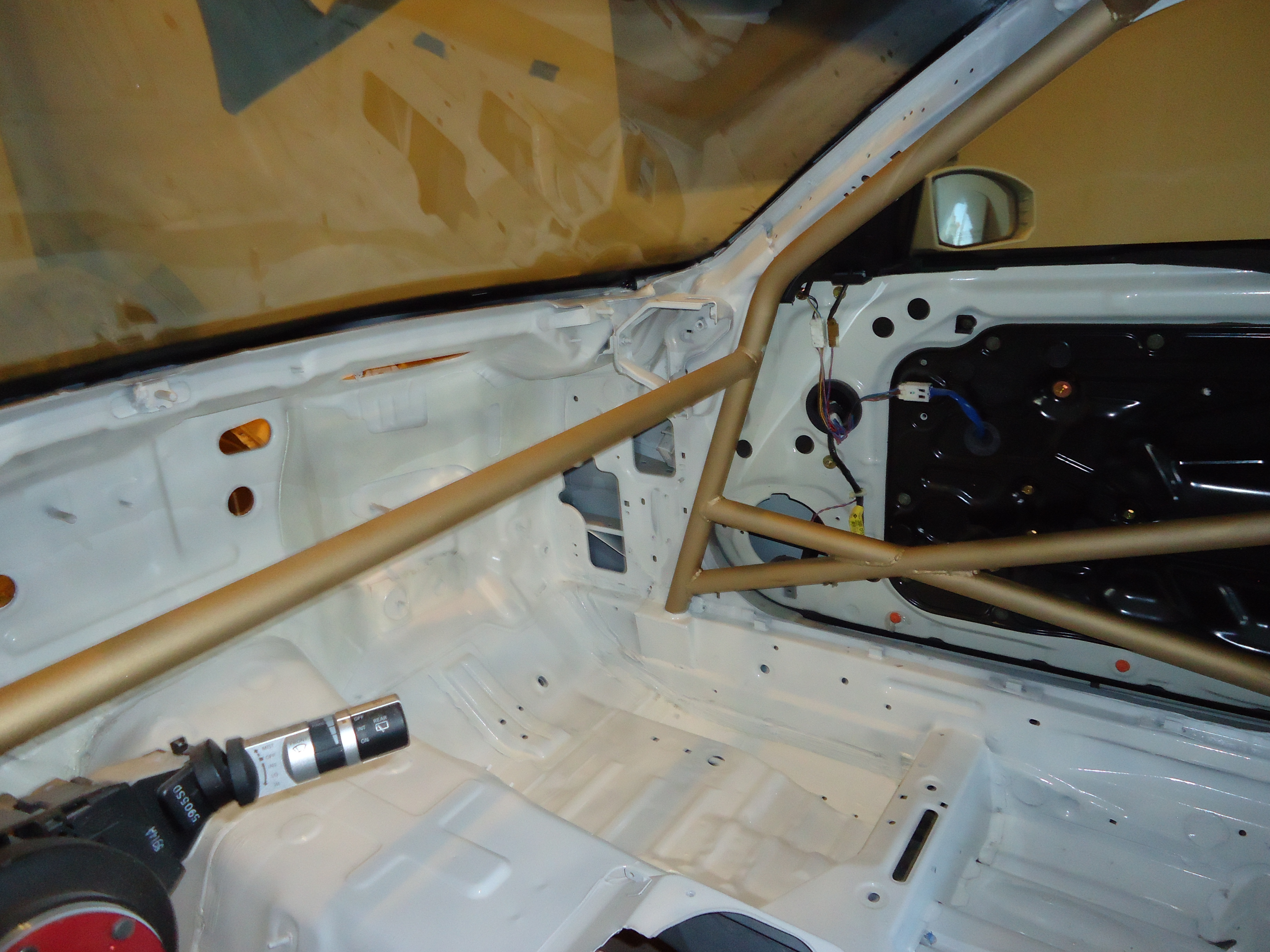

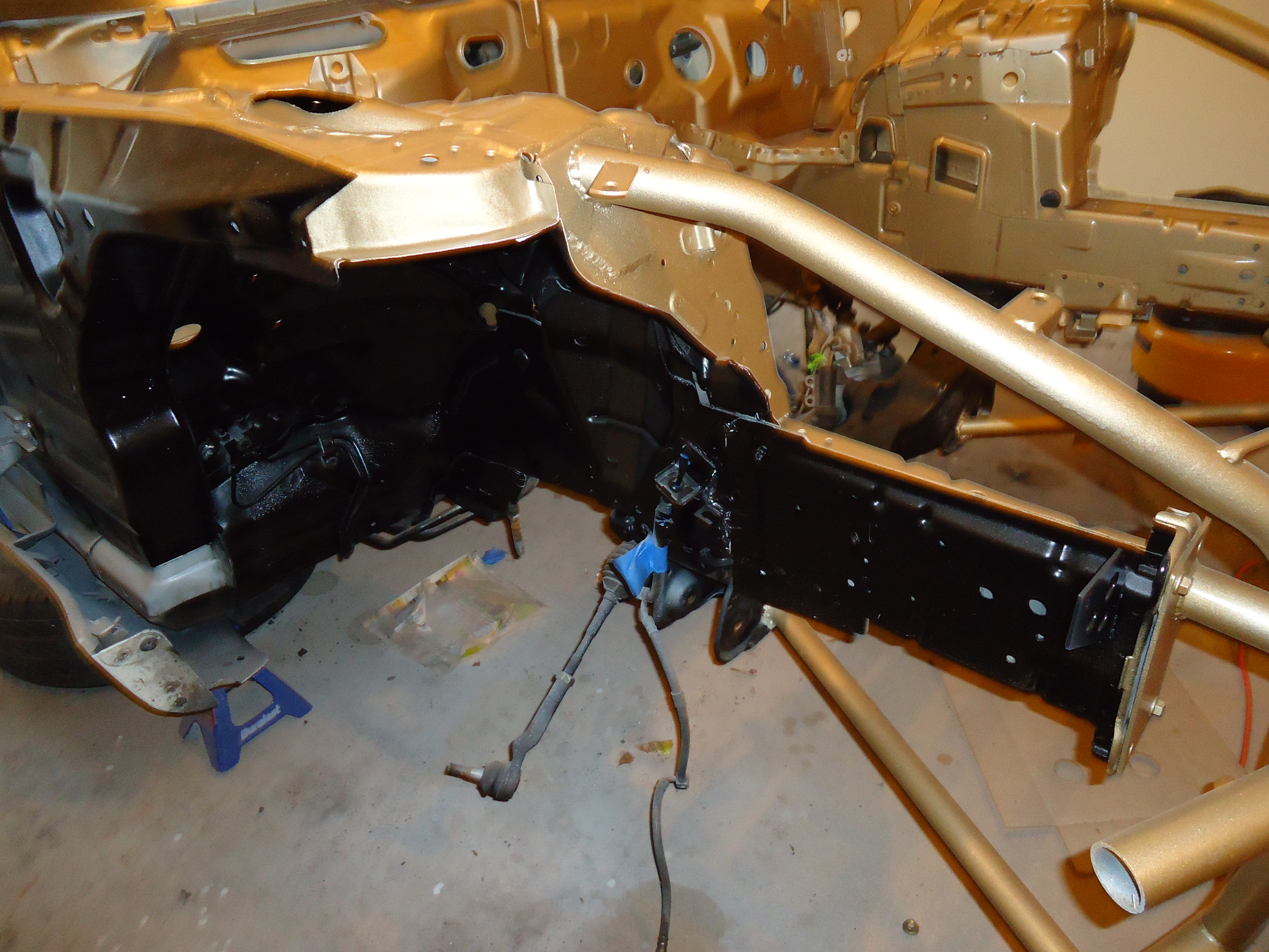

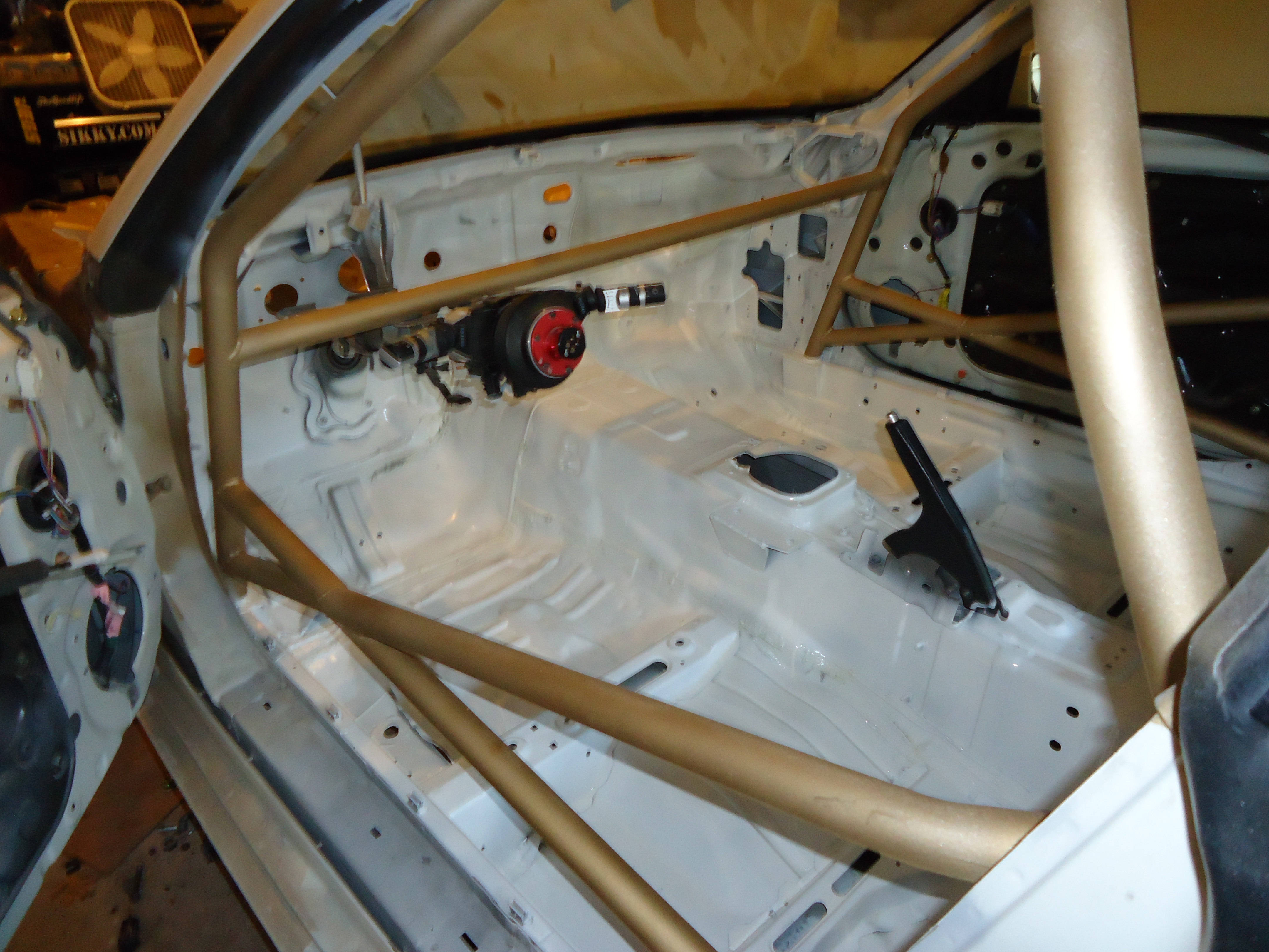

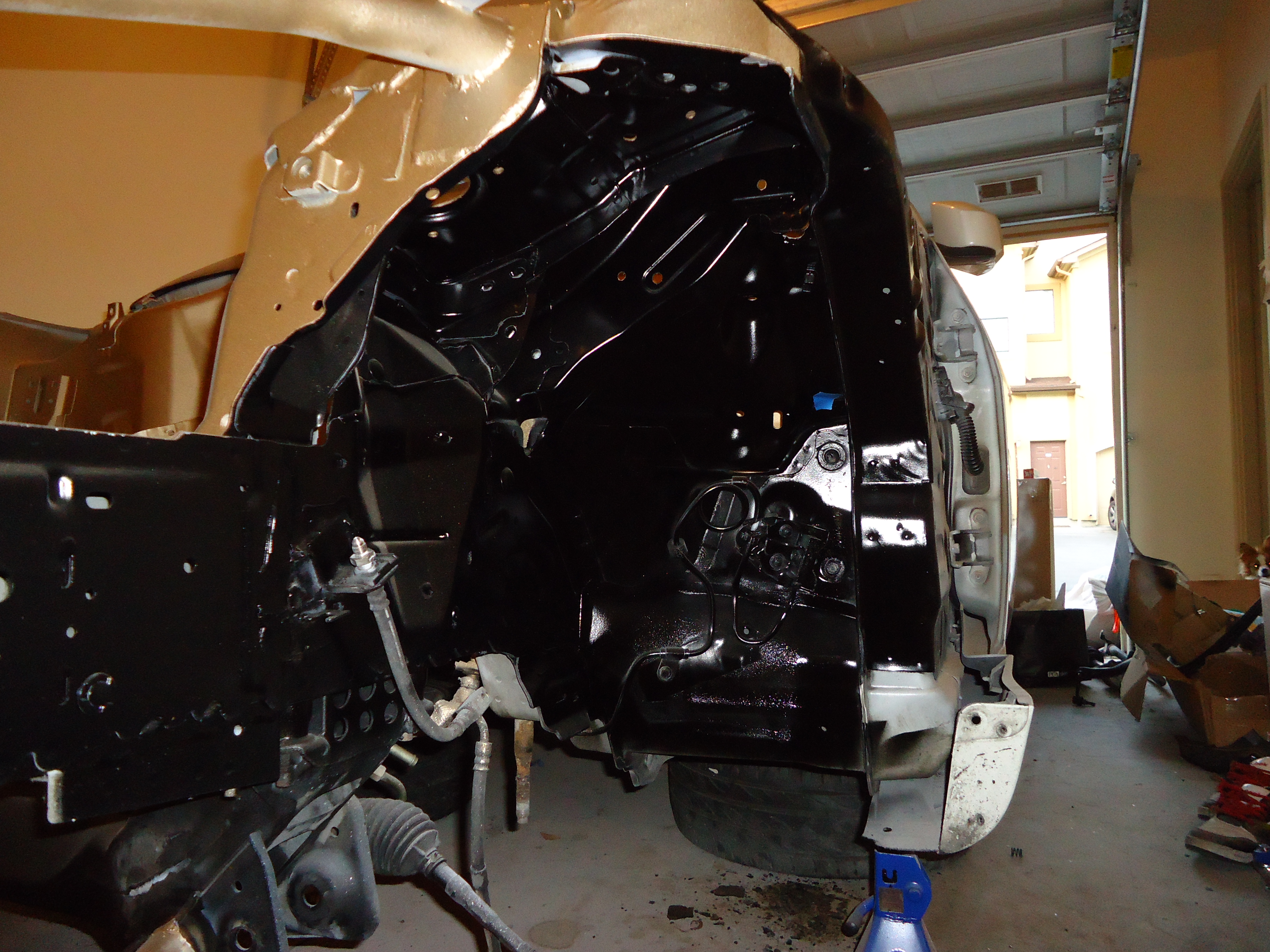

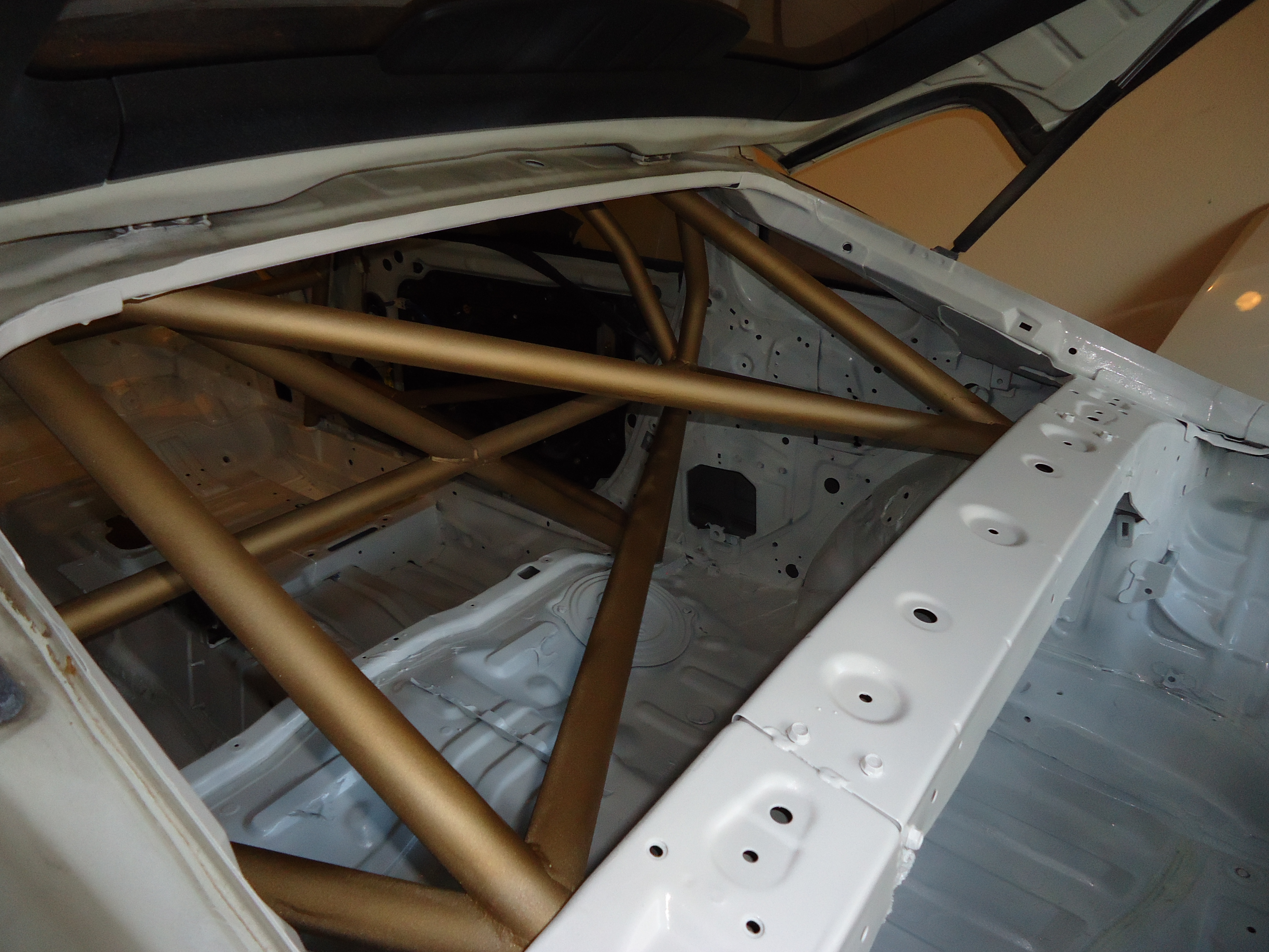

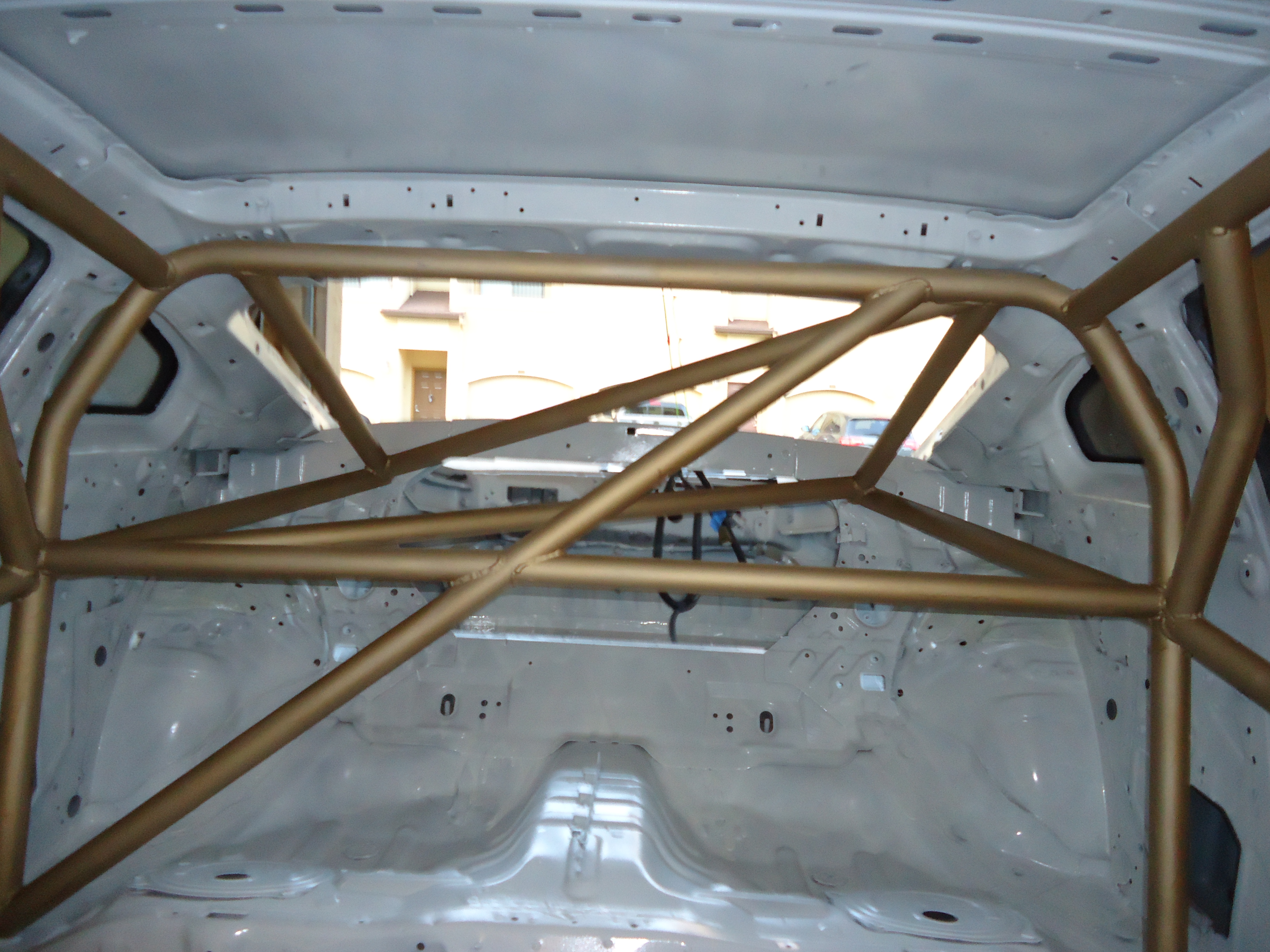

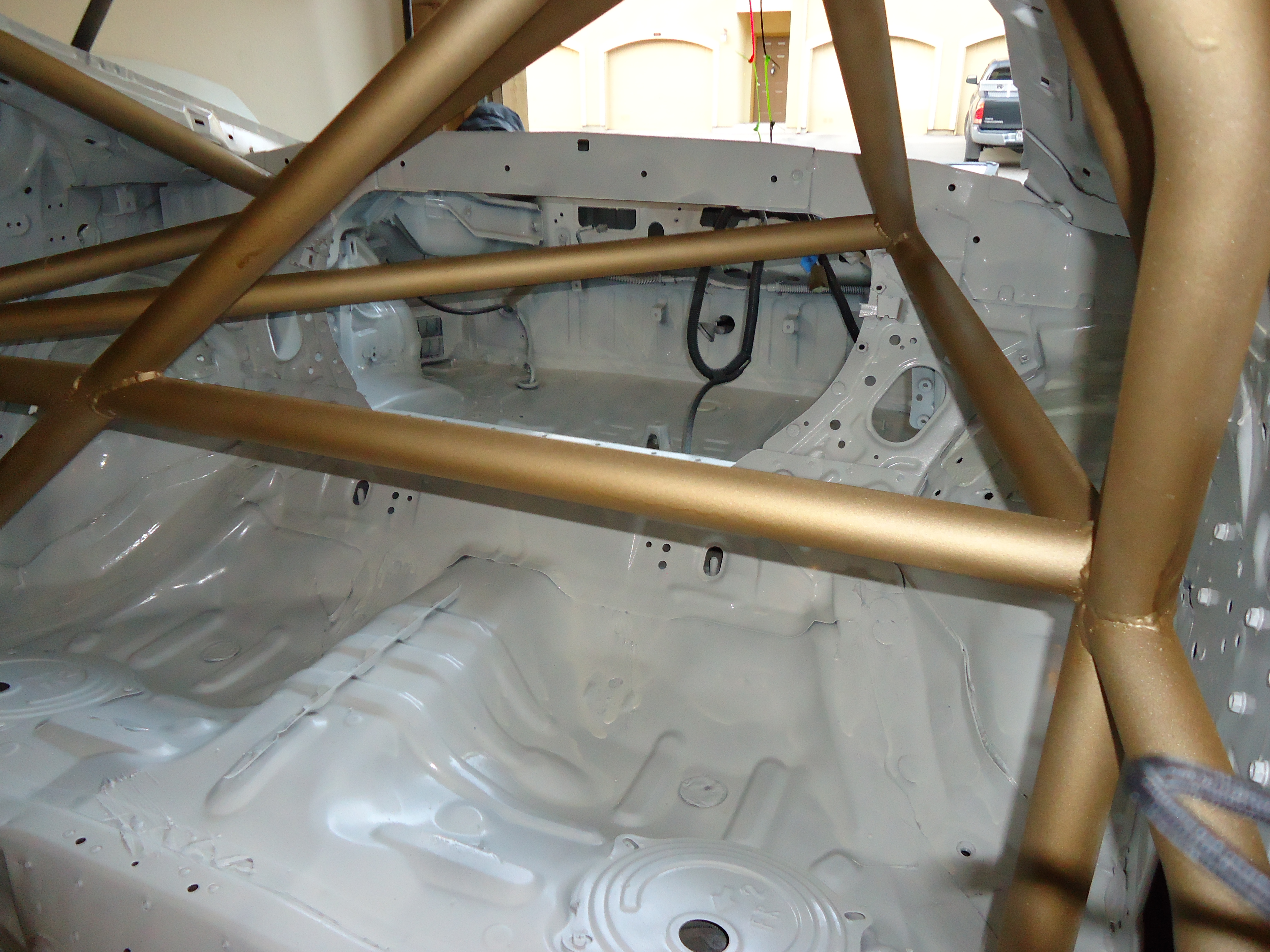

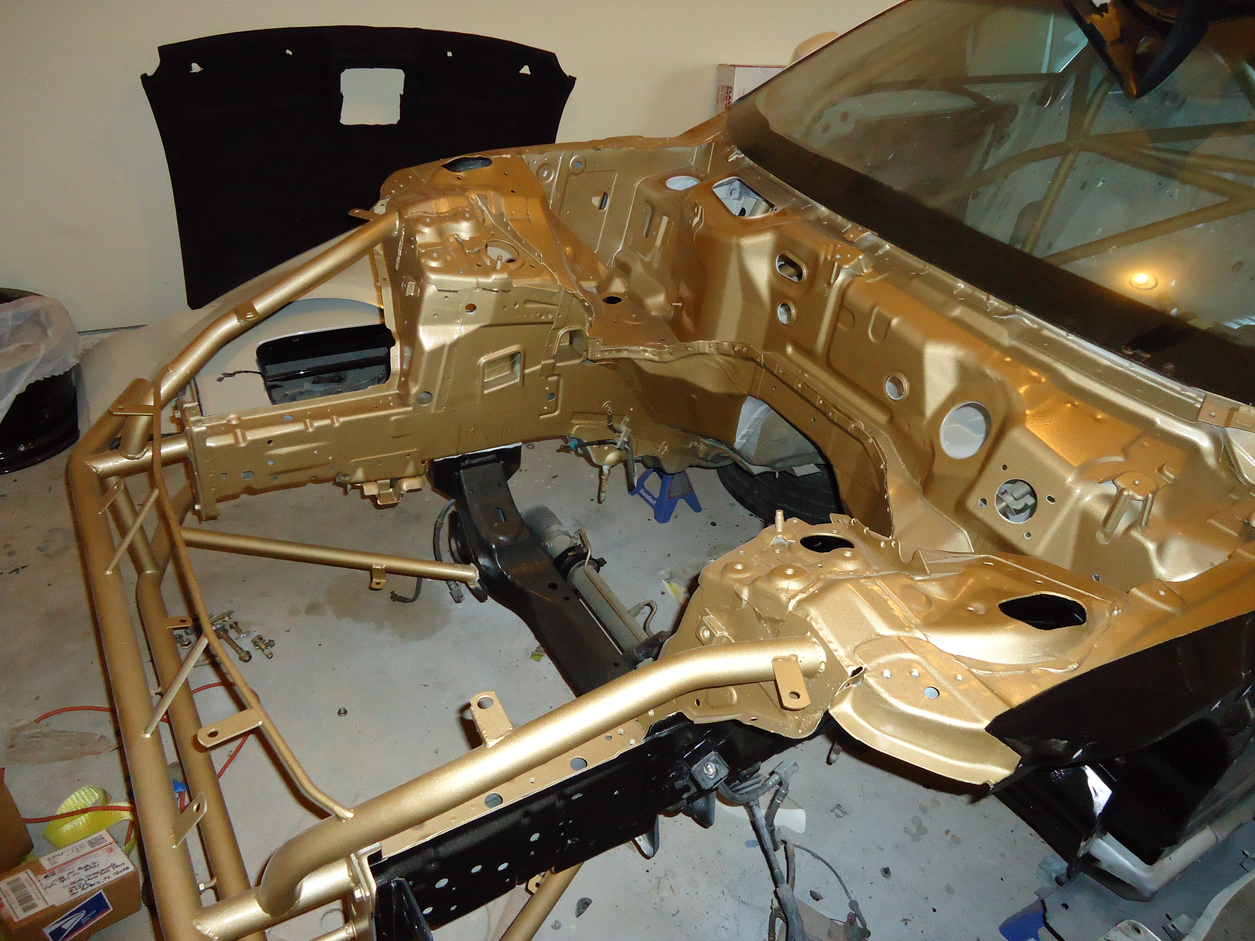

So lets jump into the car.. Started off using Dry ice which was really easy. Bought two bags from HEB and went to work..
The hard part was all the tar that was left over after the dry ice.. Used a Goo Gone professional liquid at HomeDepot, with a scraper. Took me some time but got it done.
After that I primed the whole interior.
It already started to look nice...
After painting the cage the Hot Rodz Flatz Champagne gold, I wrapped the cage in foil so no white paint would get on it.
And BAM!! we have cocaine white interior...lol
I think it came out pretty good for doing it in my garage.. Some drips here and there but looks good.
A shot of the rear..
Can't wait to instal my dash and center counsel..
Moving towards the front I also painted under the fender wells..
Shot of the other side..

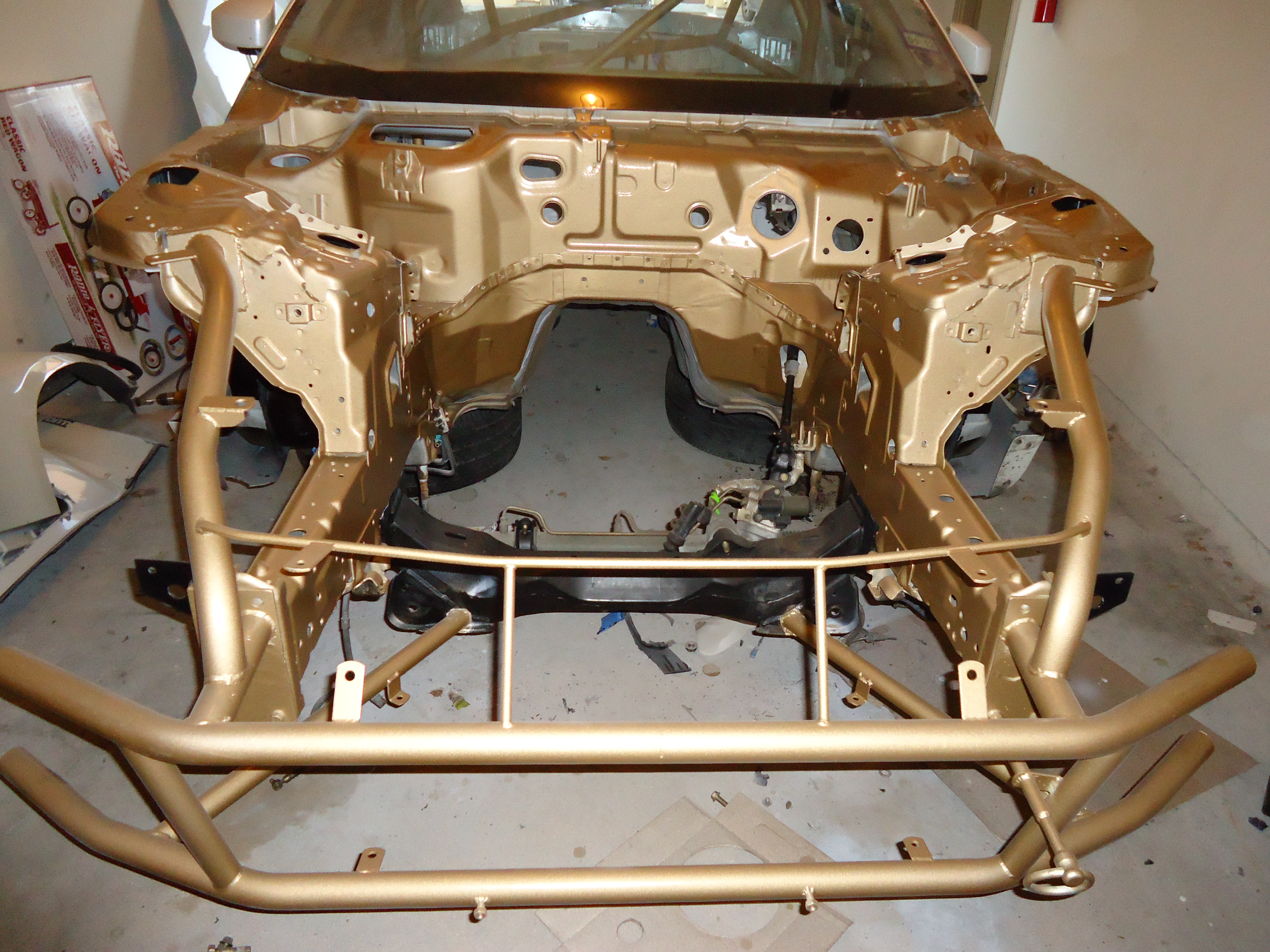

Here is the newly painted engine bay.. This is also Hot Rodz Flaz Champagne Gold but I added some clear to it..
And there you have it, Next step is to place my motor back together and have it ready for Stewart.. Getting close..
