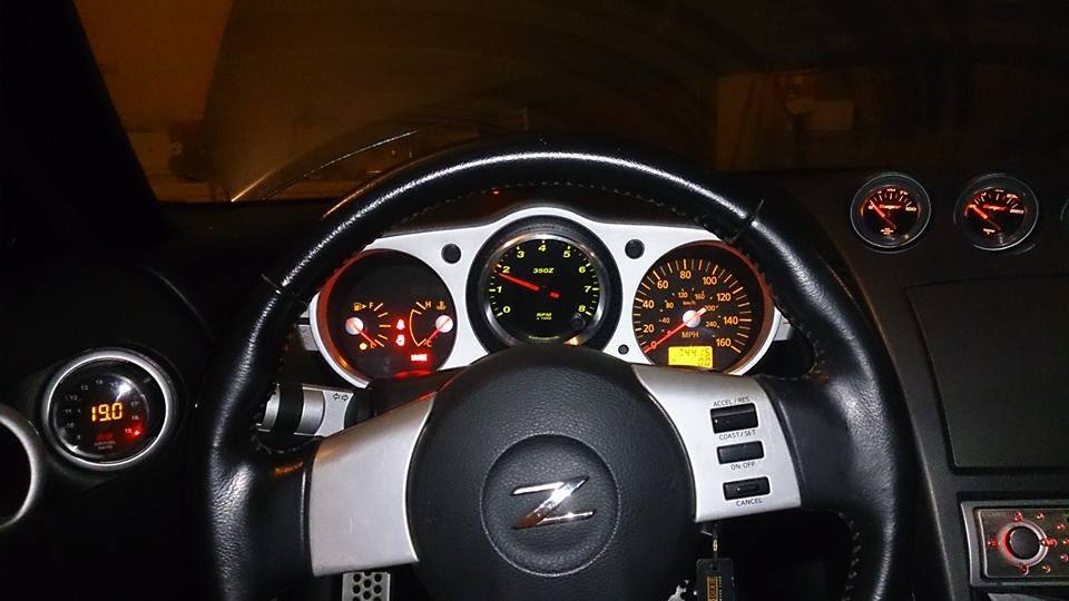

I'll start by saying this was a long project. I wanted to do this without useing a swap kit and made everything my self. Needless to say I installed, made mounts and so on more than a handful of times and wasted more money on parts then I want to count !
My gauge set up, some cheap sunpro gauges in the stock three gauge holder, a speedhut tach and a APSX D2 wide band in teh door vent

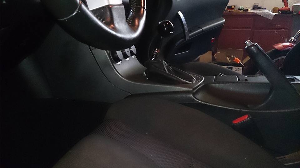

I have a DBC TB so drilled a hole in the stock pedal to hook the cable, alot of adjustment but got it right. Then a hurst promatic 2 installed and working with the stock 350Z shifter boot (was a 6 speed car)

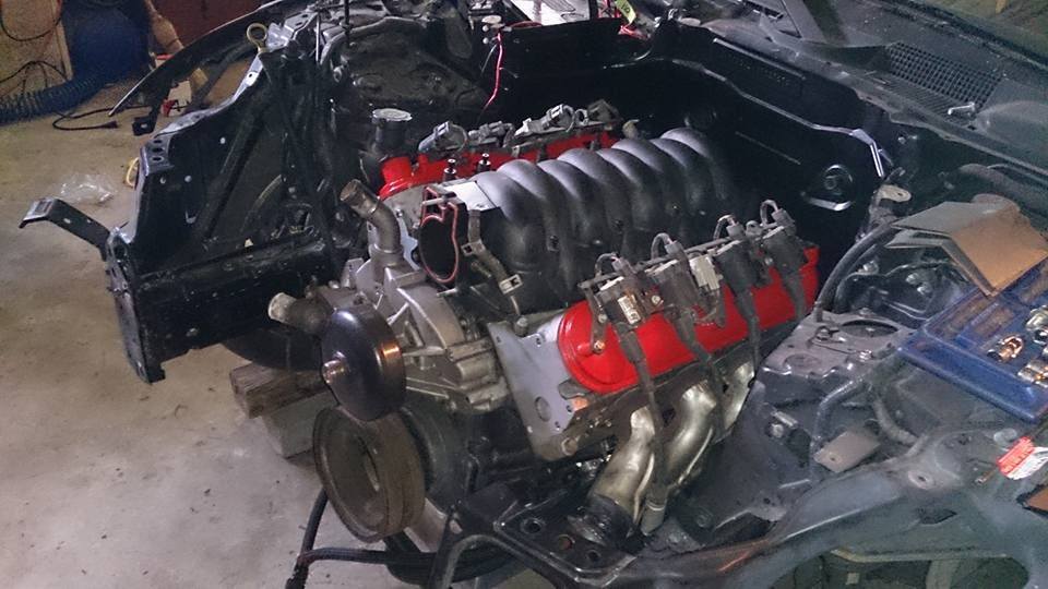

installed ls6 valve springs cleaned up motor and wanted Red covers!
Then installed motor for last time, made my own belt drive and started wiring

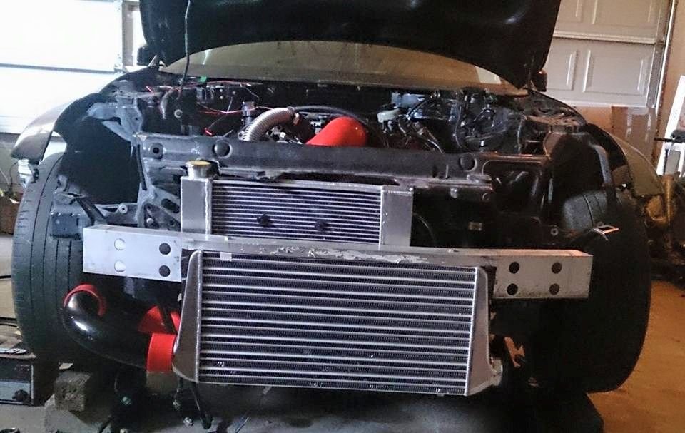

mounted intercooler and made a rad bracket
