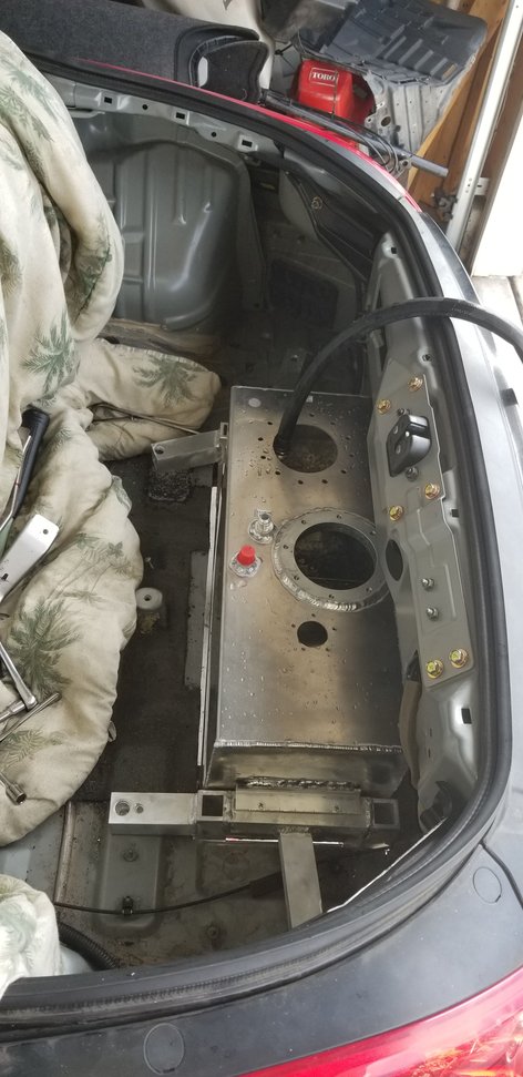

I have a few updates.
got a off the shelf 15 g flat bottone fuel cell and cut it down to about 10.5g and cut out the pickups and welding in a pump hanger to mount the megnafuel 750 internally with some added baffling.
i all so starting making a fuel cell cage to mount it in the trunk floor

Looking at your progression with your Z, makes me want to pick up on welding. Fuel cell looks great!

If u have a place to do it i recommend it its pretty satisfying making your own car parts.

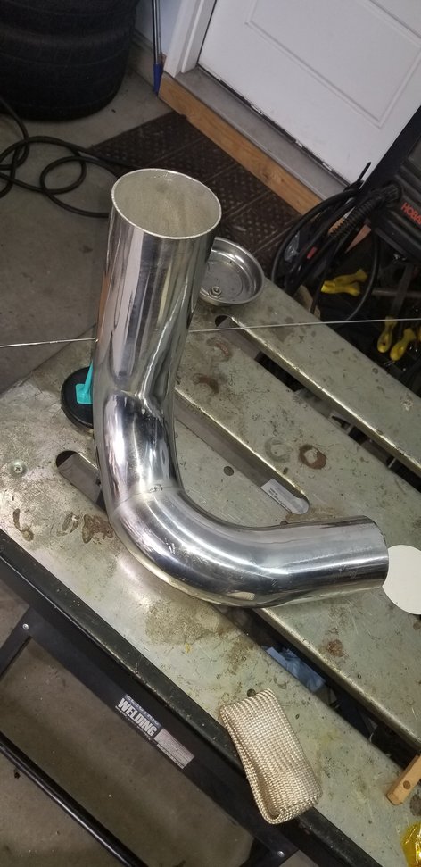

Old Nov 24, 2018 | 02:32 PM
  #167
chase z's Avatar
chase z
Joined: Mar 2012
Posts: 194
Likes: 52
From: fort Bragg , NC
Re doing all the intercooler piping makeing it all 3in reducing the couplers and making the air plath more direct. Allso have to clean up the trunk and wire up the relay for the fuel pump / fuel sender
