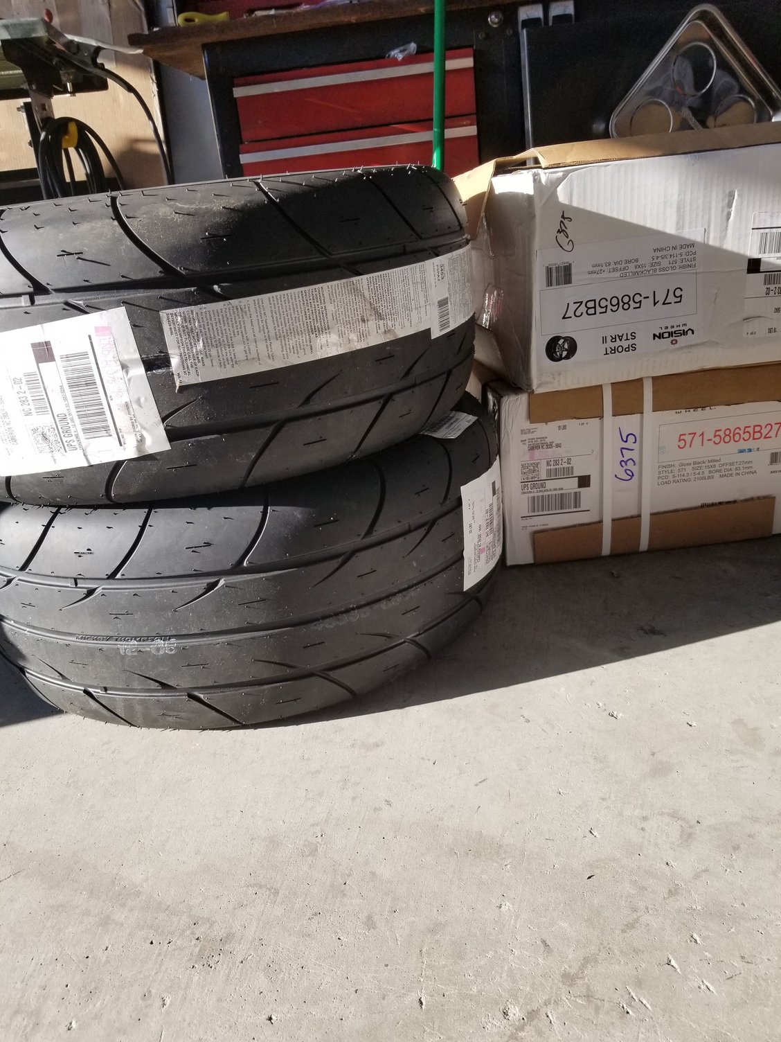

New wheels and rubbers . Now lets see if i can put the power to the road

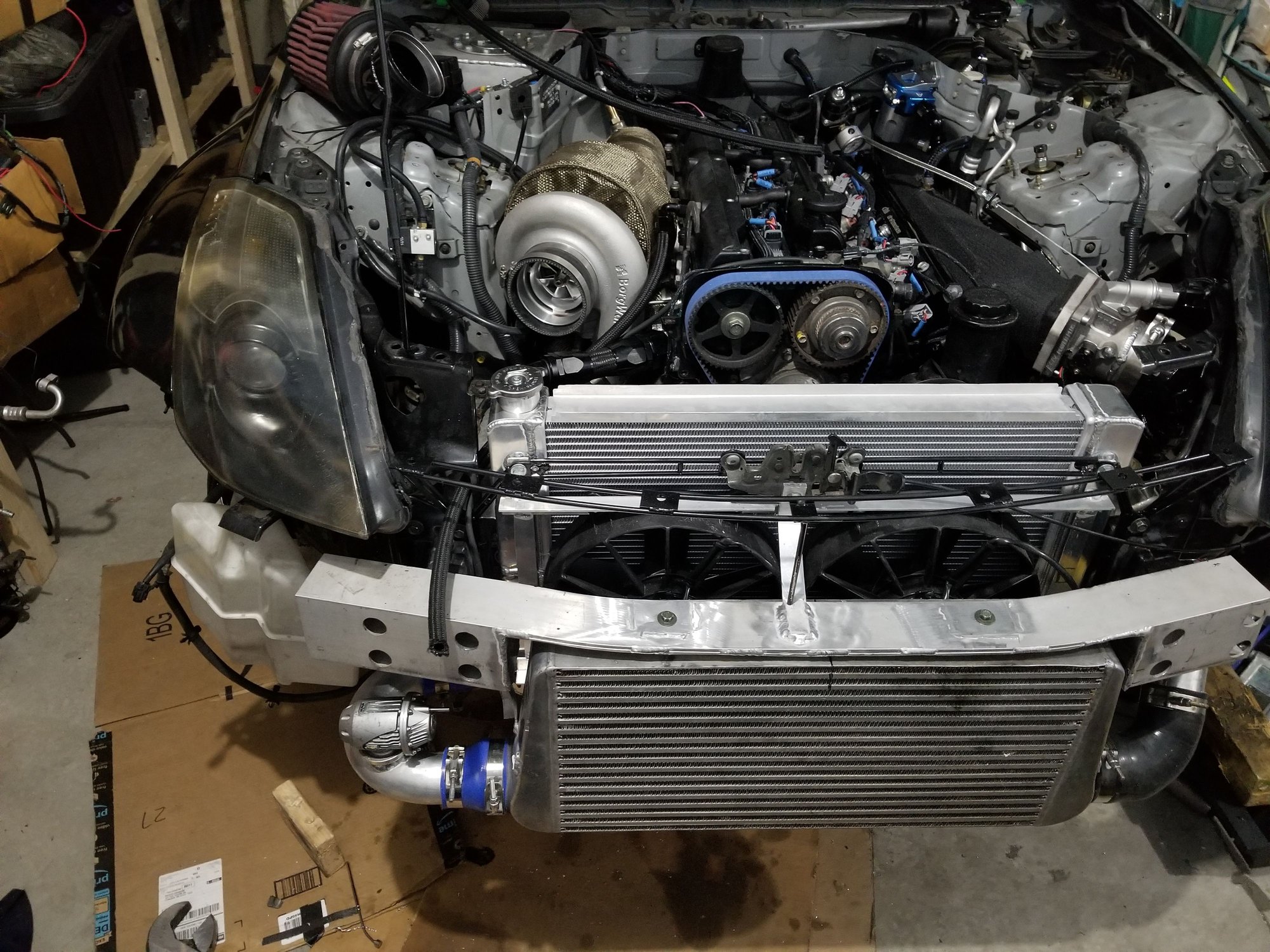

8x15 5.5 offset rims with 275/60s and a new rad with out the messed up core

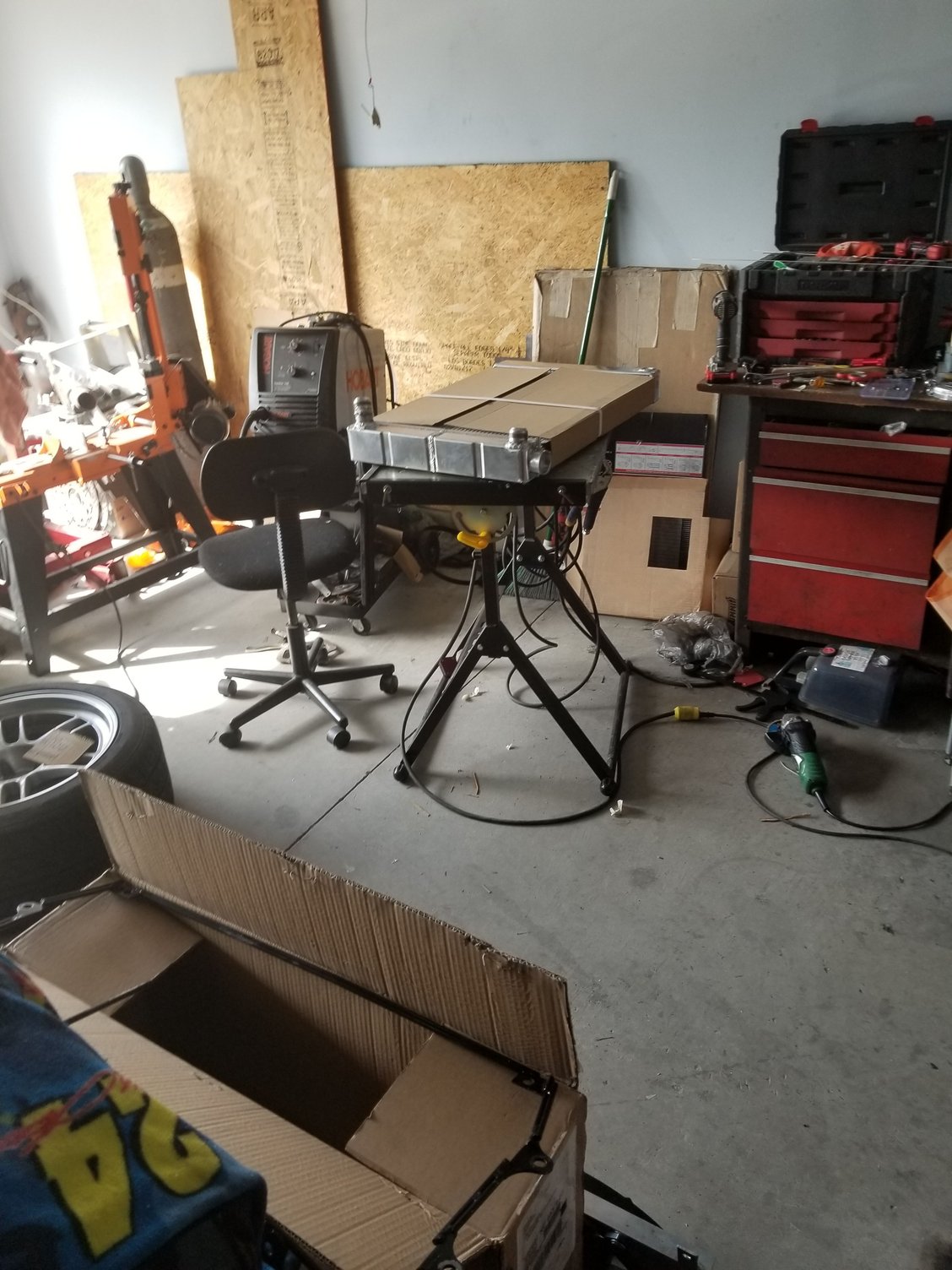

All welded up and pressure tested to 20psi.
Allso got the new fuel filter installed and moved the fpr.

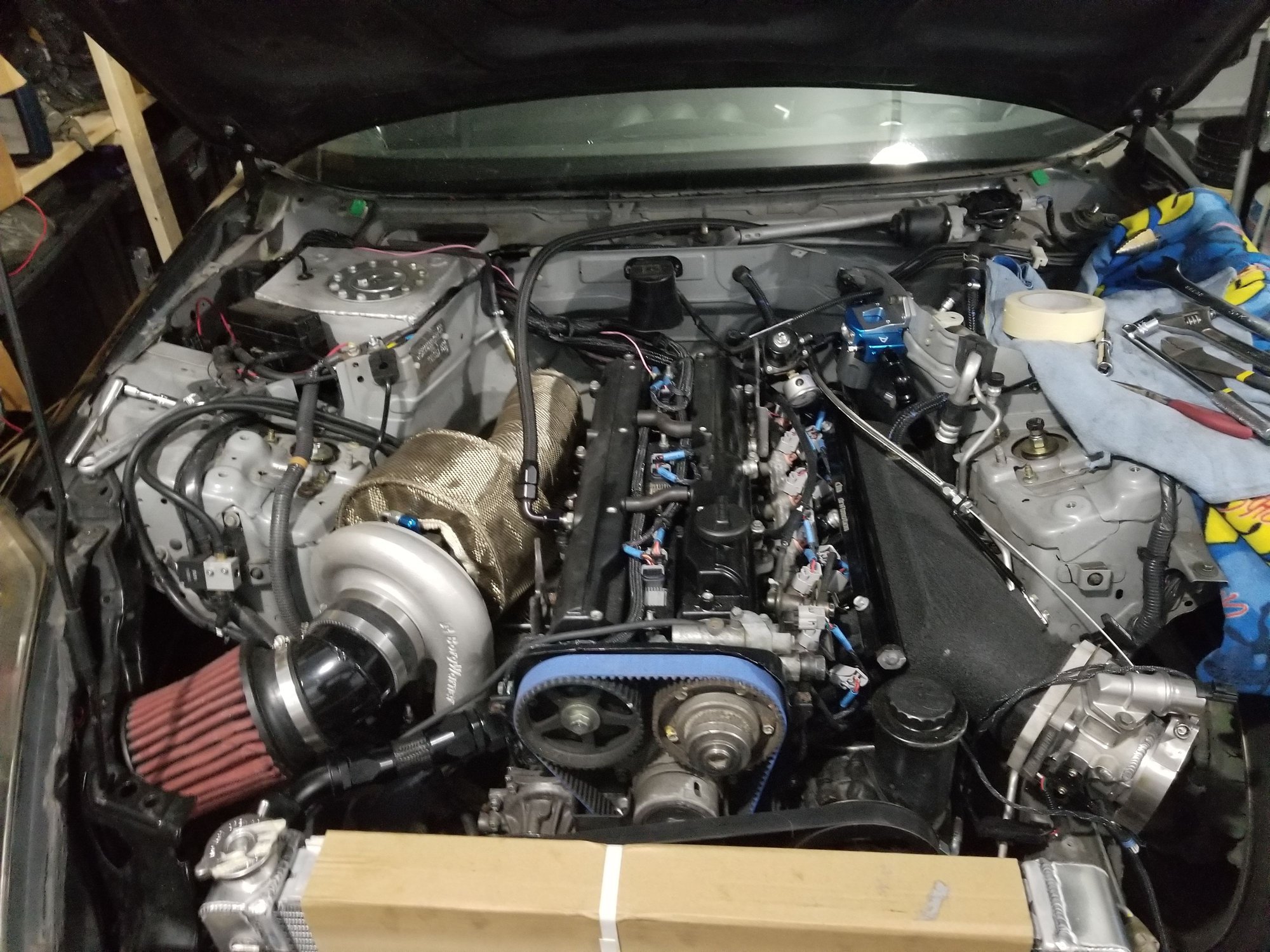

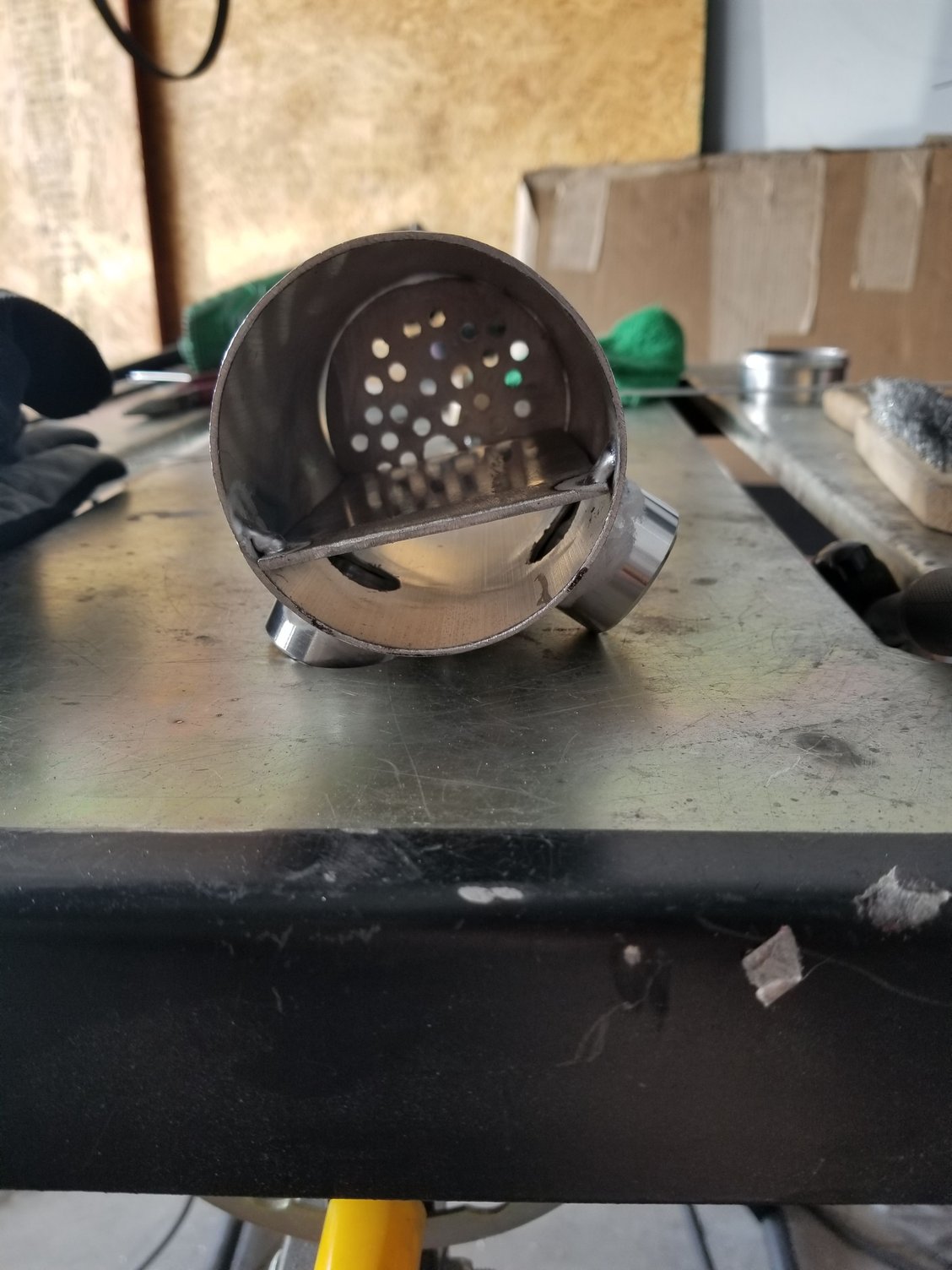

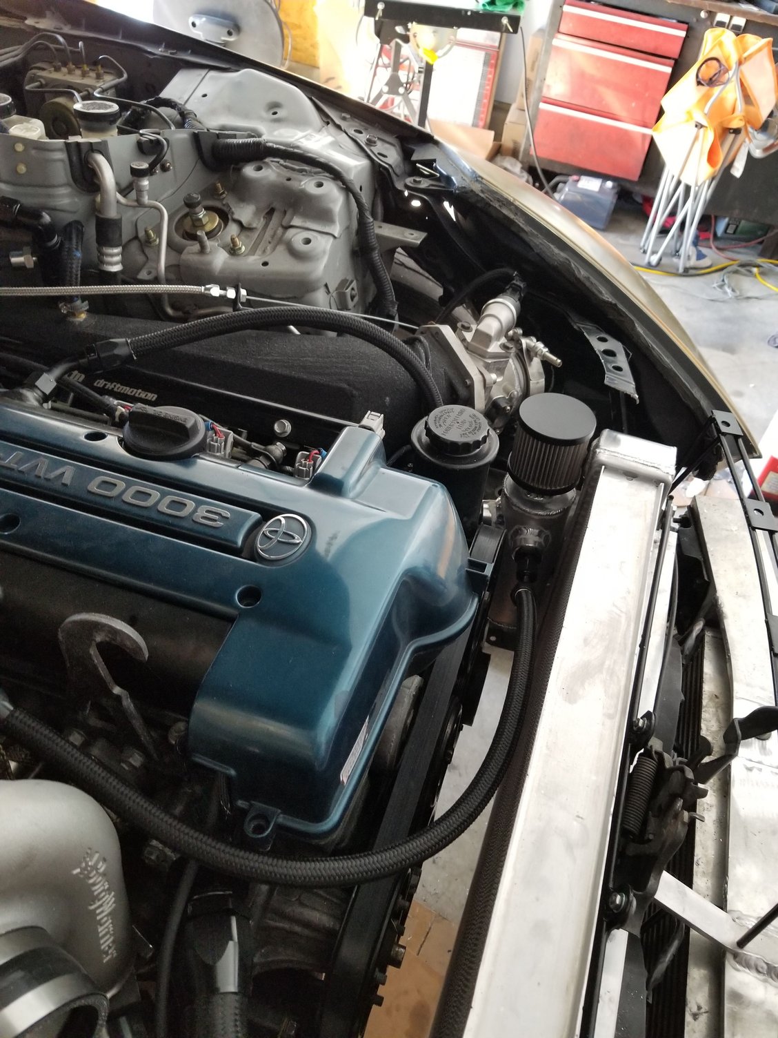

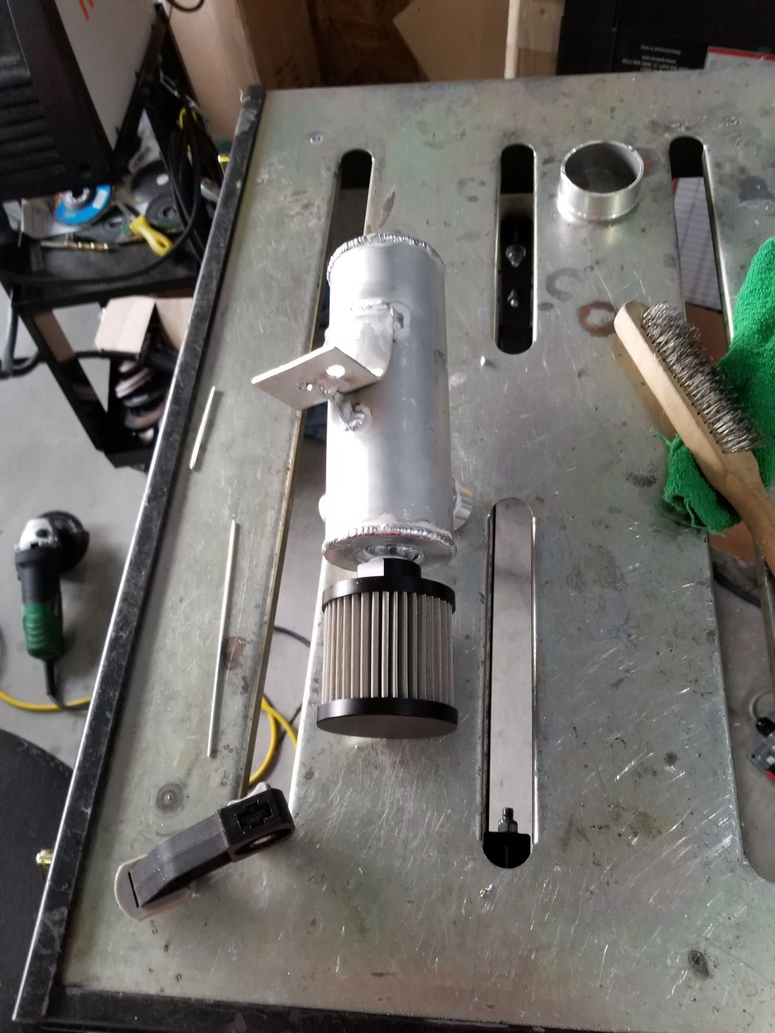

Intercooler remounted and made a oil catch can aswell

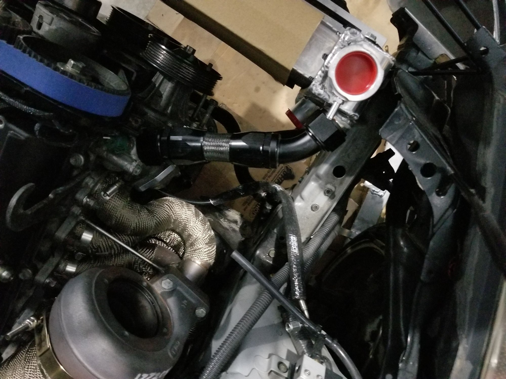

An lines cut to size and installed .
and a quick start up

Congrats, it's alive. Looks like it is idling well. Did you do a test drive?

Na i didnt have time. I will tomorrow adfter i buttion everthing up.
