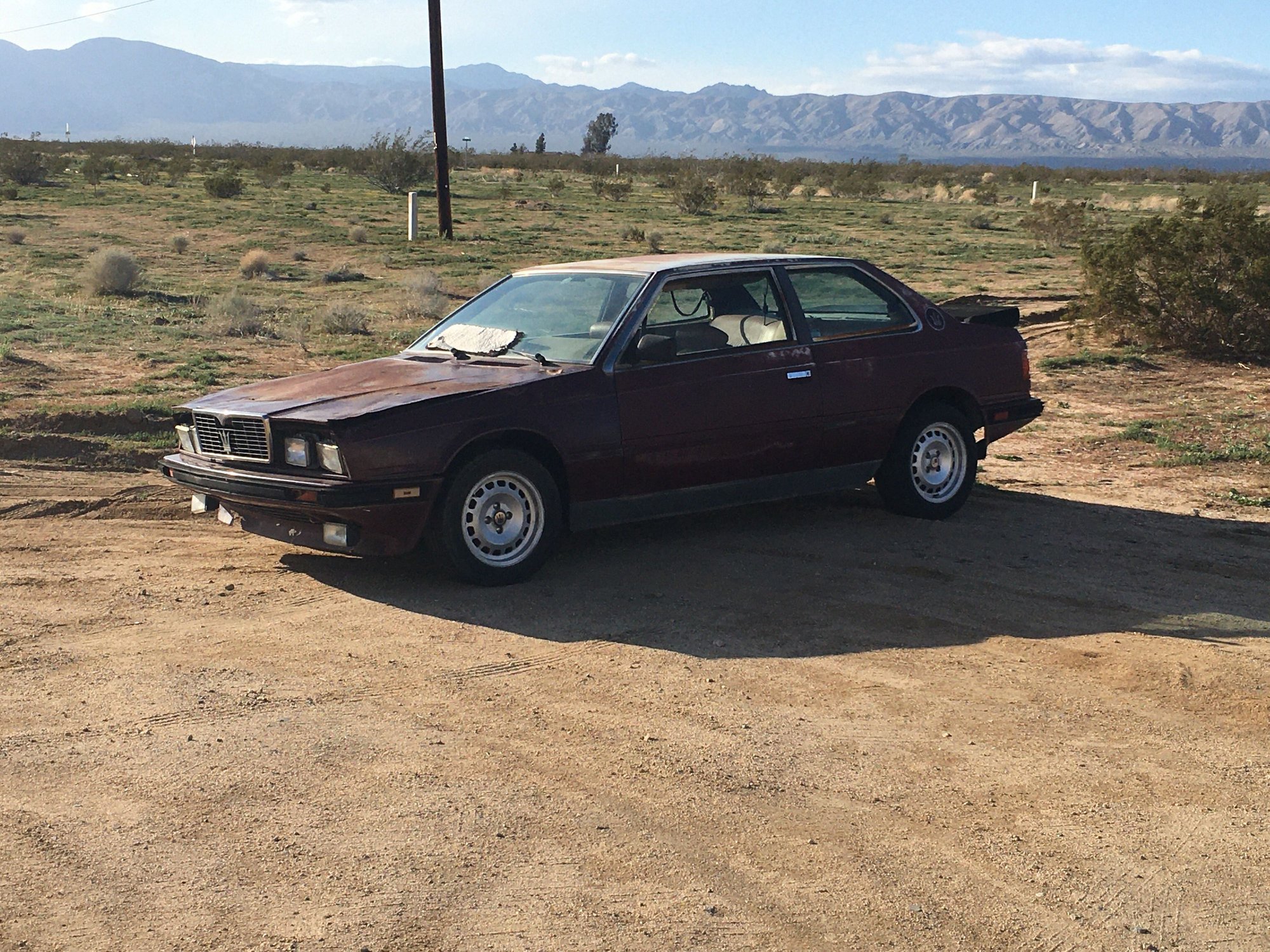

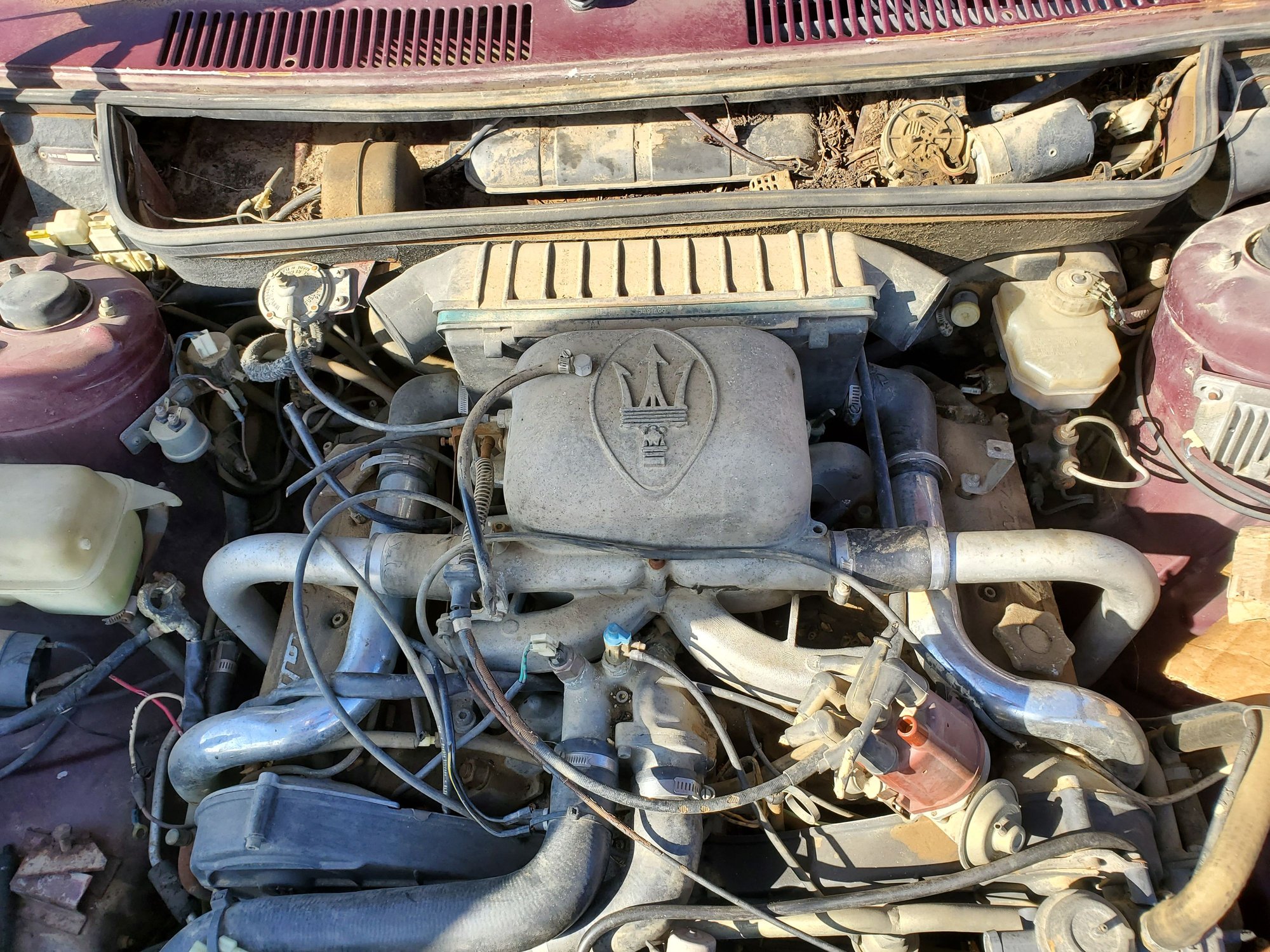

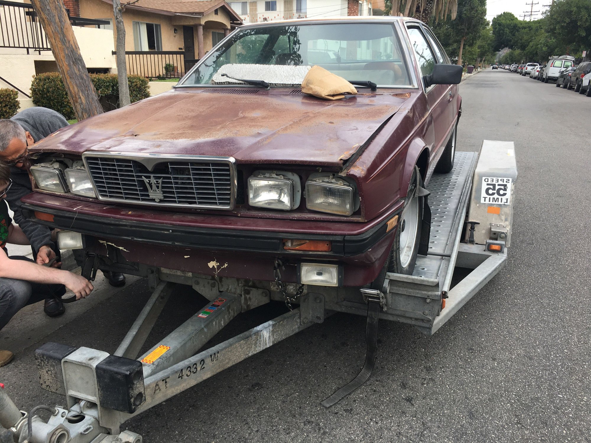

(Some pics of the car for who may like this idea)
(sorry, I'm not the best at taking pictures)
