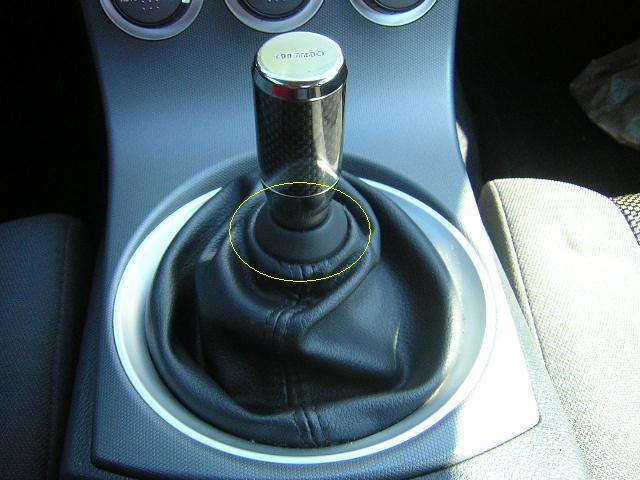

anyways, i have the Nismo TI (non-GT) shift ****, and LOVE it i might add! but i have never cared for the finisher that comes with it. you know, the thick black spacer at the bottom that fills the space between the ****, and the shifter boot. some of you are using toilet a washer! (good catch to the member that thought of that by the way! ) here is a pic i borrowed to show you guys what im talking about.
https://my350z.com/forum/attachment....&postid=750586
so i was thinking at work tonight, and decided it looks CHEAP, and had to go! i was going to get a diferent ****, but while searching i found that ALL ***** seem to need it? then i had an idea (incert light bulb over head here!) what if i remove the ****, then the shifter boot, place the finisher "UNDER" the boot on the shifter assembly itself. then reinstall the boot, and screw the **** back on "DIRECTLY" over the boot?
well come to find out, the UNDER side of the boot at the top (just below the shifter) is beveled. so by placing the finisher BEVELED side UP, it slides into the boot. and your shifter actualy gets a little shorter. (if you have a short throw like me, it makes it EVEN BETTER!!)
im assuming this is how it was intended to be mounted!? (and i dont want to hear "duuua JACK A$$ from anyone!") becaues i went through MANY PAGES of pics tonight looking for a new ****, and almost ALL of them were installed like mine was! i dont have my camera to get any pics, but you guys get the point.
so now we can all have a shorter shifter, and we dont have to look at that cheap a$$ looking fat rubber washer anymore! my new setup feels MUCH more comfortable too!
try it out, and let me know what you guys think. someone PLEASE post a pic after you do it so everyone can see. a before and after i mean. thanks! i gotta go for another drive!
o'yea, if anyone doesnt care for the nismo *****, i have decided after HOURS of looking at *****, that the Top Secret **** is also a good choice! just my $.02

BrickyardZ, by looking at your pic, i dont think you understand exactly what im talking about? i wish i had my camera here! the washer you placed on TOP OF THE BOOT, im talking about placing it UNDER THE BOOT. that way we dont have to look at, or feel it anymore. hope that helps! someone get a before-n-after pic up please. i think it would help alot! thanks!

I understand. That is a photo from someone here that got the rubber washer as a finisher. I installed my washer under the boot as well. Pulls the boot right up under the ****, I agree that nismo may have enginerred it that way, but the first people to put them on didnt known that.
Looks great under the boot, but unfortunately photos of that dont show from the outside. ha ha.
Sorry I wasnt more clear in my post.
