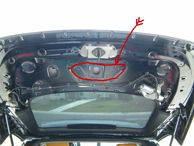

Where is the weight exactly?

Here is where it is. This was was already removed.
Attached Thumbnails Weight in trunk??? spoiler too heavy!!-remove-weight-here.jpg

you can grab the lower plastic cover (that covers the rear windshield wiper motor) almost anywhere and pull and it will start popping the cover off the bottom of the hatch, be careful if you pull from the sides first, there's different clips near the top. But if you pull it straight out it should be fine. Once you pull it off, right dead center is a retangular black bar with like butterfly rails, (can't describe it, theres a picture online someplace) But it has 4 screws. You can't miss it. It's cake to unscrew that and pop the plastic cover back on. My hatch stays up now, but i had to do the 2 penny trick and the furniture pad trick too to make it pop 100% everytime without having to hit the unlatch button again.
