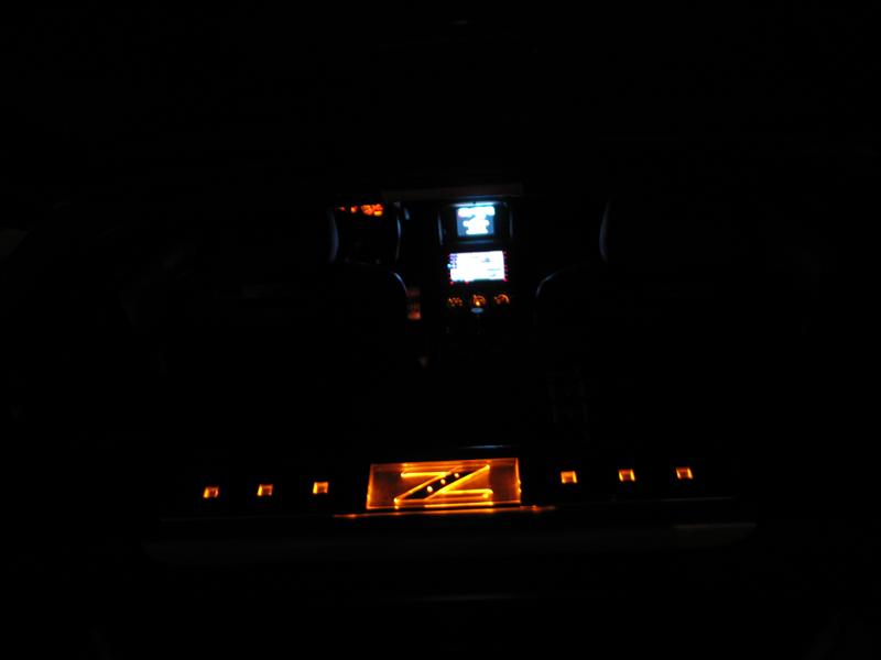

Here's a shot of the Rear Strut Sill in the Dark
Attached Thumbnails Just Intstalled the New Light-Up Door Sills!-rear-led-sills.jpg
