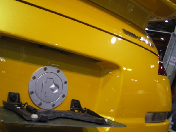

I was looking at the HIN gallery and came across a pic of a yellow Z with the gas thing relocated to behind the license plate.
It looks sweet!!!!!
Does any-1 know how to do this??? Or where can I get any info on this mod.??????
here is the pic I saw:
"https://my350z.com/gallery/showimage.php?i=143&c=257"

Really this was not as hard as you think.
I first took the filler line off the car, but keep it because you will be reusing a part of it later.
Take the filler pipe and cut both the filler pipe and vent pipe about 5 inches down from the bottom of the filler bowl. (This is where the cap screws in)
Take off the bumper and remove the wire for the plate light. This is the hole you will use to put the pipe through. You will then need to drill another hole to use for the light.
After you get your filler just how you like it tack weld it on. You will need to make a brace in the back for support.
After that you can make a hole in your bumper.
Install the bumper and the cap you like and you’re done. Remember I did leave out a lot of the work the body guys did to make it look good. Also you will no long have a spare tire because the filler line will go across the spare tire well and drop down to the tank and connect to the 2 stock hoses that connected the OEM filler.
