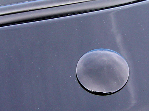

Here is what I did. I bought a sink stopper from Lowes. It was chrome and has a large wing nut on it. I sanded it and painted it to match. I also placed a large rubber O-ring and rubber washer under it to prevent water from getting in. The car is dirty in the pics, forgive me.

Lebby, Is water getting in from your set up?
Old Jul 12, 2005 | 08:20 AM
lebby-pooh's Avatar
lebby-pooh
Joined: Sep 2004
Posts: 286
From: atlanta / chattanooga
Thumbs up
hi el guy
no water yet after 1 week, i think we're good

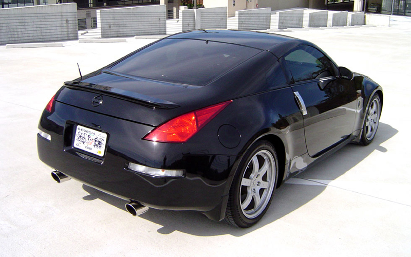

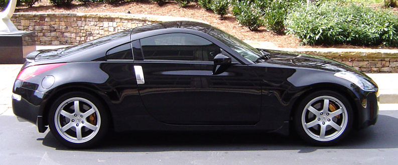

I like the look without the wiper back there, too. Looks much cleaner, IMO.
I used a low profile Chrysler headliner clip - painted and clear coated it. Then applied a thin layer of automotive grade silicone to seal out water. Let it dry and put it on. I used a very large metal washer on the underside and a wing nut to make it stay put. It's been many months and thousands of miles with no leaks or trouble.
looks great man. did you black out the nissan burger on the back?
nice touch. i might try painting the burger body color instead of shaving it off in case i ever plan on trading the car in.
That looks awesome, I want to do it this weekend can you give me more installation instruction.
Thanks. Yeah, all emblems are blacked-out in the photos. I've since replaced the side emblems with a new unpainted set. Like with the wiper, I was going for a cleaner look and felt that the emblems were too distracting.
Thanks. I'll do my best to shoot some pics of the inside (underneath the trim) and post by tomorrow...maybe Saturday. It really is quite easy to to.
