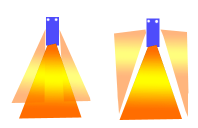

Default There aren't blind spot in Z
It's all about how you adjust your side mirrors. If you position them to duplicate central mirror, then yes, you've got yourself a big blind spot. But if you position them much more outward the car, you'll cover all of your blind spots.
Go to the parking lot, position another cars into your blind spots and adjust side mirrors so you can see the cars. Then check setup again on the road, when you approaching traffic light. With right setup car in side lines should be visible to you directly, then visible in the side mirror, then when living side mirror it should go into central mirror. I stress it again that before you can trust your mirrors you should double check that they adjusted properly.
After that with a little practice you'll be able to drive withoud turning you head to check blind spot (which you can't see anyway). If your side mirrors clear - you are clear.
I know that it's totally oposite to what they teach you when you getting license, but it works fine in Z
