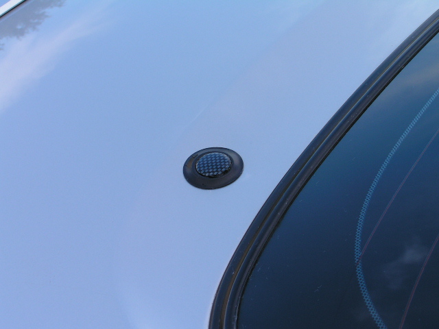

Default Carbon fiber
I like that idea, but have this already!
