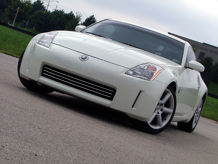

werd, love mine
Attached Thumbnails "Door edge guard" front bumper mod driving me nuts!-zgrill2.jpg   "Door edge guard" front bumper mod driving me nuts!-zgrill1.jpg

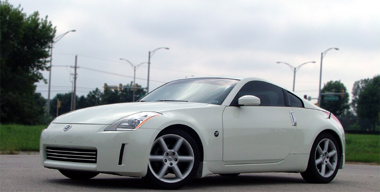

heres my CS with them on
