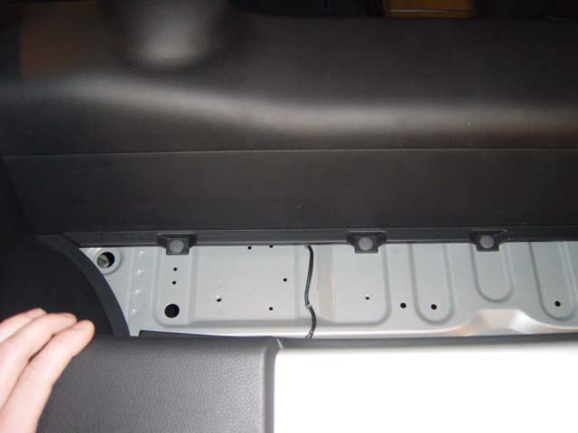

I was reading STLZ post on 4 point seat belt harnesses and decided to see where one Member attached a 3 point system. Well, when i removed the trunk mat, i found this hook on the passenger side. It aligns perfectly with the middle of the passenger seat. Could this be a possible attachment point? And why only the passenger side?
Could some check their car to see if they have one on both side or only on the passenger.
Passenger side

Could have something to do with securing a baby seat.

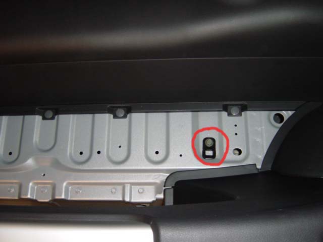

driver side...
ahhh...true.
Then if it's for a child seat, i would imagine i could use it as a harness anchor point then.

It is the child seat anchor. But, it is not designed to secure an adult in a collision. You weigh a LOT more than a baby in a small plastic seat.
To properly affix the shoulder harness, you should use a static bar that goes across the back of the seats. A roll cage has this part designed into it. In my A4 I had a bar in the trunk, under the rear package shelf.
Or, bolt it to the floor with the approved hardware from the harness manufacturer. When bolting into the sheet metal you have to place a plate about two inch square on either side of the mounting hole. This provides the support needed to hold you in the car if you crash. Otherwise, you will rip the bolt right through the metal.
Hope that helps.

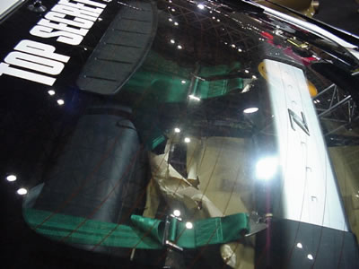

This is how the Top Secret Z had there belts attached.
Yup, that is what I have been thinking. You would need to weld in a plate for the eye bolt, but the rear STB is a hefty box section piece under all that plastic.
