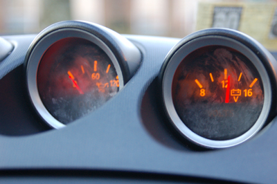

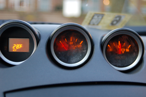

This really makes no sense to me, but two of my three factory gauges are cloudy/scratched/f**ked up for some reason or another. Initially it looked like some small smudges, which I tried gingerly to remove just with water and such (didn't use any harsh chemicals or anything). But everytime I touch the darn things, it gets worse. Even if I touch it with my finger.
When I rub my finger across it, the smudges seem to disappear a briefly...but they gradually come back and are worse than before.
I'm totally at a loss for what's going on, and only think that perhaps I have to replace the whole console.
Y'all ever seen this before or have any ideas?

clean them with alcohol.

Yeah, it looks to me like you've got a greasy film on them. Perhaps try some diluted dawn soap, or something that cuts grease and isn't too harsh.

well, that last thing I tried on 'em was some windex. (and before you say that might be what did damage, the gauges look almost the same as they did before I tried that)
as for the film and alcohol, it doesn't really feel like anything's on it. and wouldn't the alcohol be bad since they're plastic? if not, I can go that route and the soap one

windex has amonia (unless you used the amonia-free version).
I don't think amonia and plastic is a good combo...
Maybe the previous owner used windex too.
Try using some plastic polish (the one they use to clean the headlights, you can find it at your local auto parts store).

Alcohol will not damage the plastic on it. Alcohol is actually the prefered cleaner of window tint. Alcohol is a non-abrasive cleaner and will remove grease and various other things that will leave a film on glass/plastic surfaces.
Agreed - ammonia is BAD for plastic (just like that used in window tint).
After using the alcohol I would follow it up with Maguires plastic cleaner and polish (2 step system, will also clean DVD's and CD's)

Looks like fume damage from Krazy glue. One of the trim rings probably fell out and the previous owner tried to Krazy glue it back in!
You ever try to glue a model airplane canopy with Krazy Glue? thats what happens.
