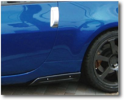

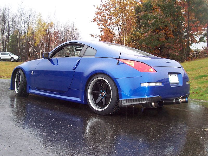

Can I get a custom Side diffuser made In Twill weave??
It would go on my sideskirt like the Tommy Kaira version...
Thanks
CHad
The car on the left is my ride, I want something like the pic on the right of the TK sides so it will flow with my rear CWEST addons in Carbon Twill weave.

the TK sides are nice. i wonder if you use just the rear VS1 pieces you would have the same look?

Good call, but I dont think it would fit over my Airwalker sides?? If it did then SWEET!!!
