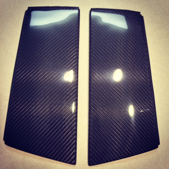

Latest project straight out of the mold (still not done). Carbon b pillars that are a direct replacement and not just covers. I've been getting much better results with infusion versus vac bagging.
