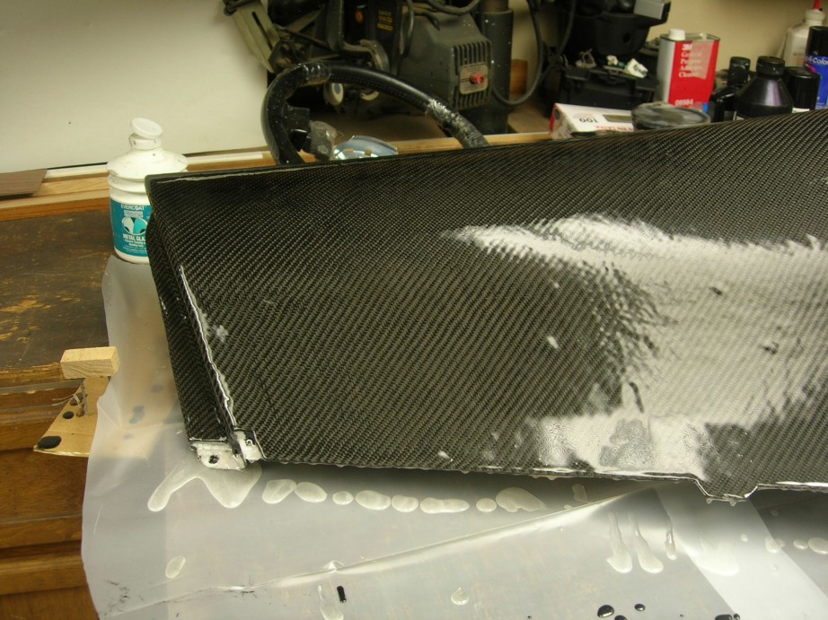

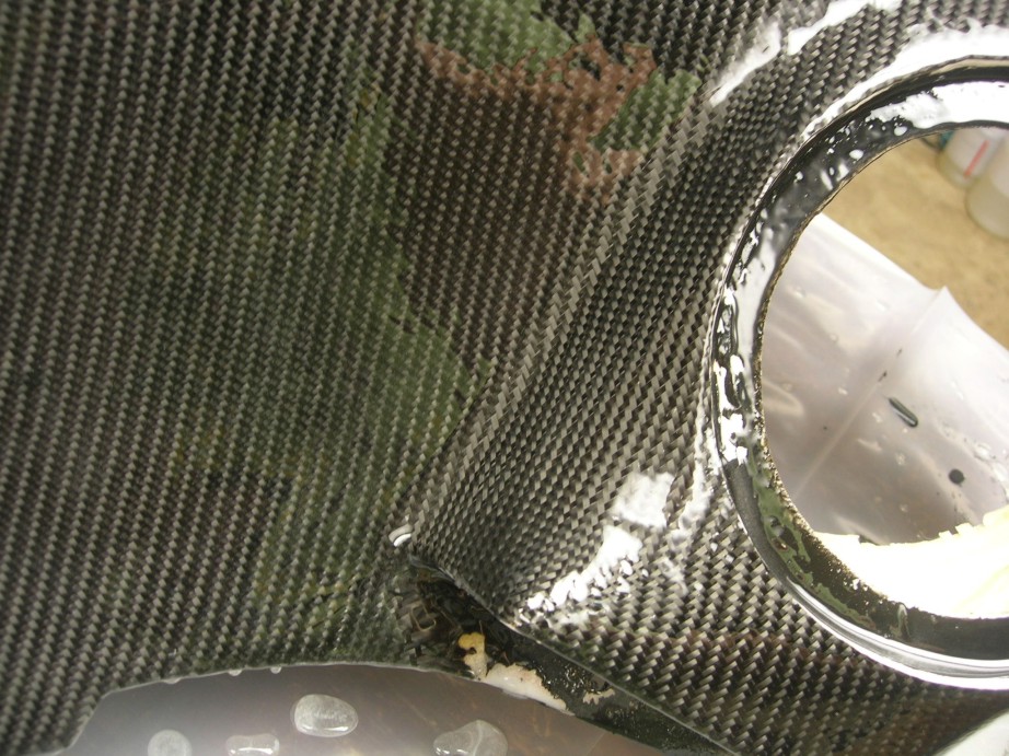

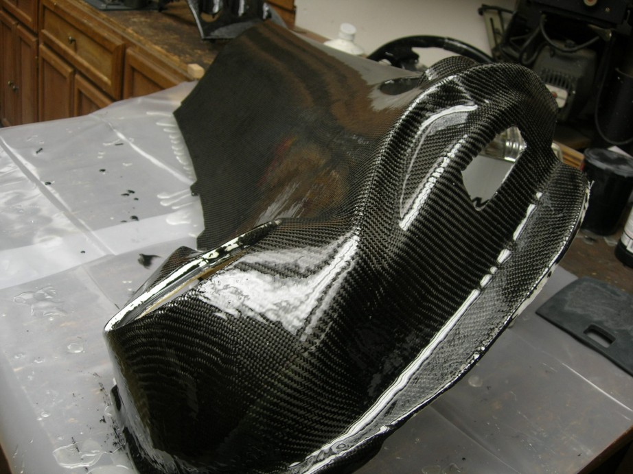

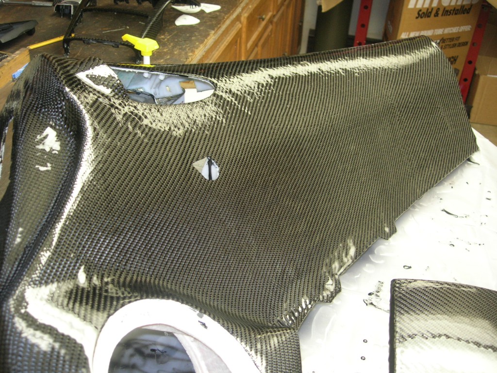

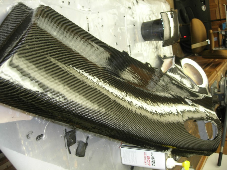

So its been a while since i posted pics of anything ive been workin on so i figured i'd share some of these. A set of door panels with speaker pods modled in. I am wraping them in cf. They are not totally done but very close. They still need a little sanding and then clear, but u can see how they will turn out. Opinions welcome of course.

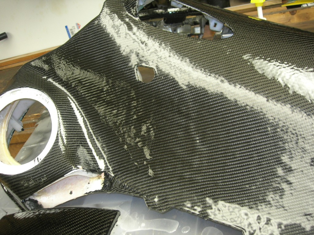

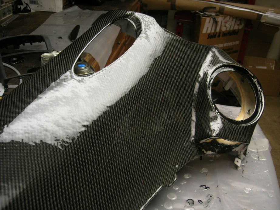

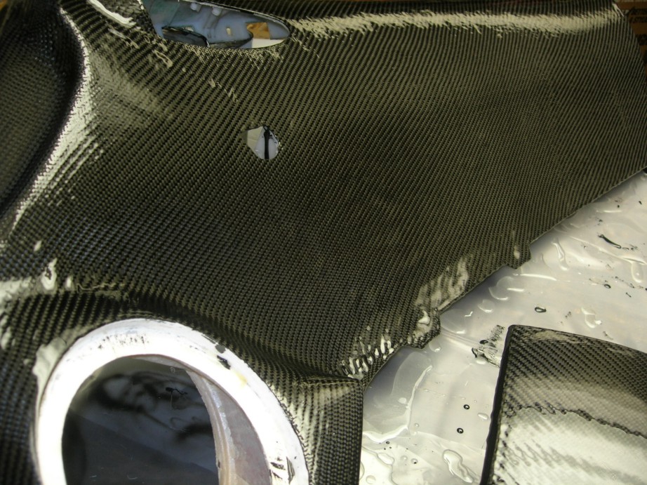

Heres the passengers side...the drivers side is a little further along than the passengers side cuz i started them first.

Originally Posted by tonester1011
no one wants to tell me what they think??
hey man, they look pretty good! I am imrpessed witht eh continutiy of the weave from the door panel shape to the molded pod. the weave stays pretty straight!

I am assuming that the remaining sanding will get rid of all of the ripples and bumps?

yea u can see the drivers side is further along and has less ripples...the resin has ripples cuz it falls into the weave of the cf and as i sand and add more resin it gets smoother and smoother til the last coat when its sanded and sprayed with clearcoat....the end result is as smooth as glass!!
