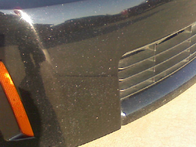

here it is!

the bumper is not too bad. You would need to wetsand with a 2000-2500 grit paper and buff it back out with compound a machine. There will still be tiny little dots of chips but it will look a lot better because you are smoothing the clear coat around the chips.

is that hard to do? or should i hire some one else to do it

Worst case scenario.. you do a bad job and it looks bad.
It already looks bad.
Just do some googling and check out some tutorials.. its not too difficult.

See post #5.
