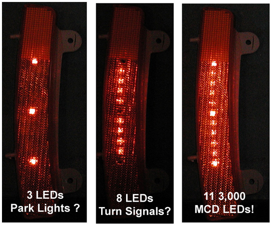

I thought I would try something a little different on a amber set of side markers. I put a total of eleven 3,000 MCD amber LEDs in each side marker. What makes them different from other multiple LEDs is how they are wired . The standard three inside the squares are wired together. I then put four between the middle and outer squares on both ends. These 8 are wired to a different positive lead from the three inside the squares. This way the 3 can be hooked to parking lights and the 8 can be hooked to the turn signals.
Let me know what you think. I have the one pair on ebay at http://cgi.ebay.com/ws/eBayISAPI.dll...tem=2420658165

looks good man

Make them in clear and I will get a pair

awesome idea!!
