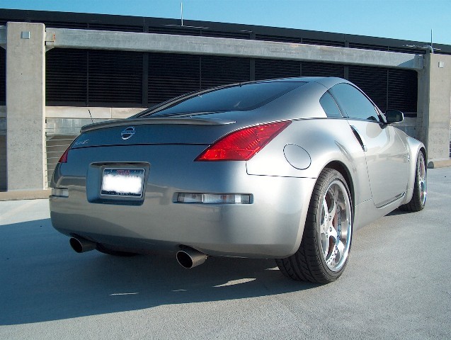

I sent you a reply to your PM Chris. But, to let others know, I removed mine last week when I installed the OEM spoiler.
I am currently using the stock rubber gromet filled with sealent (and upside down) to fill the whole.
I will shortly have a polished stainless steel hole cover to cover it. Problem is the covers I have are 7/8" and 1" and the hole is somewhere between. So, I am going to mod the 1" cover to fit. I will post some pics when I finish, here is a shot of the rear for now.

Old Jul 3, 2003 | 08:30 AM
jran76's Avatar
jran76
Posts: 671
From: Plano (Dallas), TX
Oh, one other thing, sure enough right after I removed it there was a downpour of rain, like the streets flooded, and I had no problems seeing at all. I did put RainX on it, but that was 6 months ago...
Here is another pic, not sure if you can see it that well from the side.
Attached Thumbnails Who wants to get rid of their rear window wiper??-up.jpg

Can you post a closeup of the wiper motor area? It's hard to see from the rear pic. I know that photo was more to show what the rear window looks like without the wiper.

I will post a pic by saturday, I have to work a lot between now and then. It is very easy to remove, I will do a write up this weekend if anyone is interested....
