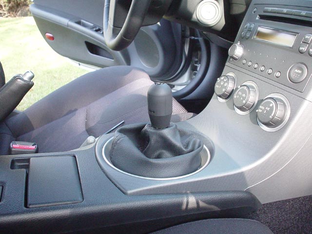

Default Urethane Nismo **** Installed Pics..
Here is the nismo urethane **** installed pics. I'll drive it tomorrow, but so far it feels great. Super grippy too so it'll get better with heat. The only problem is the shift boot doesn't want to fit snug up in the **** for a clean look. Maybe some gluegun action will do??
Oh ya and the price on eBay dropped to $59 Oh well..

I have seen the TI and the urethane which you have.
I will be interested in hearing your shifting impressions (feeling, throw, etc) using the NISMO urethane -vs- stock.

looks kewl

For a fix that'll leave a lot less residue (and potential problems with taking the **** off later), unscrew the **** and remove the boot. Take a pretty long rubber band (med-heavy thickness) and keep looping it around the end of the exposed shift lever to form a stopping ring basically. Then put the boot back on, and put the **** on, but don't screw it tight yet. Make sure the boot is snug against the base of the ****. If it isn't, then roll the rubber band ring up a little more. Then simply tighten the **** and you're set. I did this for my last shift ****. It worked great!

This **** feels great
You can feel the gears engaging
I'll try to find a spacer /ring to put between the **** and boot.

Try using 3/4" heat shrink tube if you want the boot to stay down. Cut the tube to about 1.5" and slip it over the shaft wraping it around the tip of the boot and under the nut. Shrink it and you have a nice black shaft to match the urethane ****. Now when you grab the ****, the boot won't be rubbing your hand.

I wanted that ****.. But im not feeling how the **** looks at the base with the shift boot..
