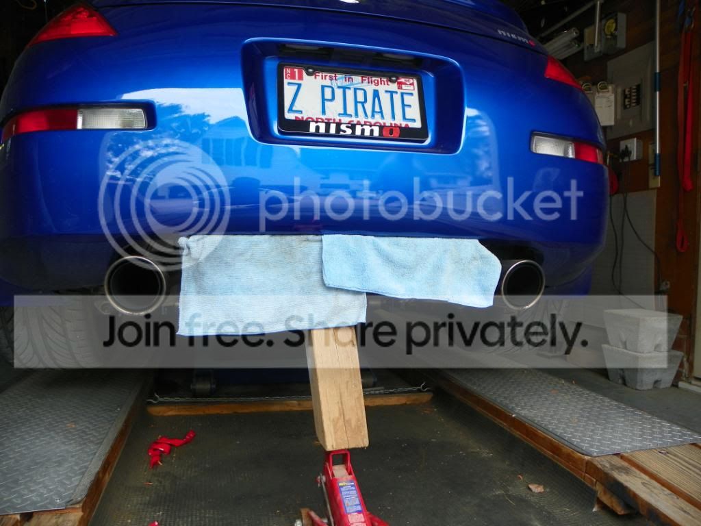

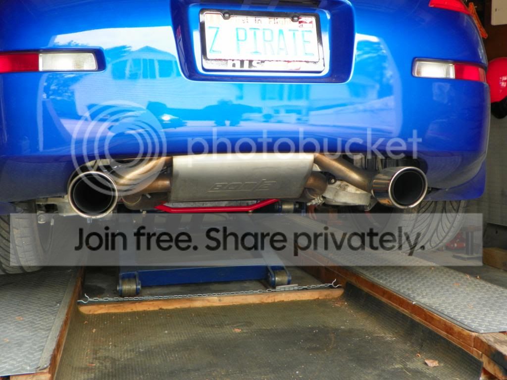

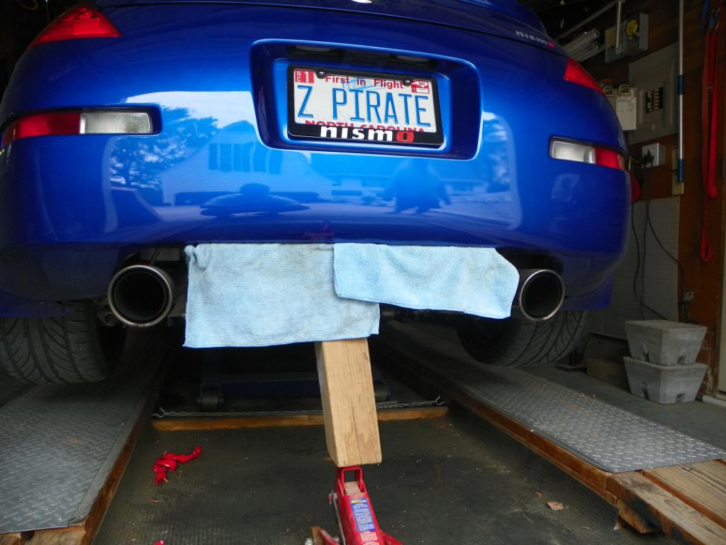

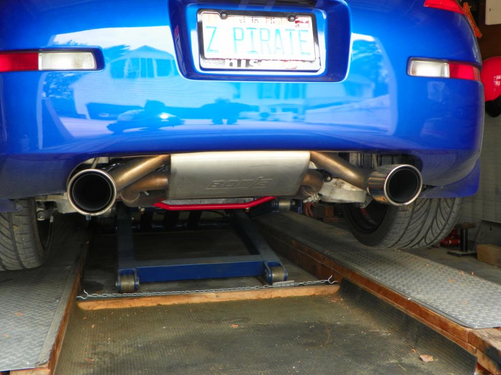

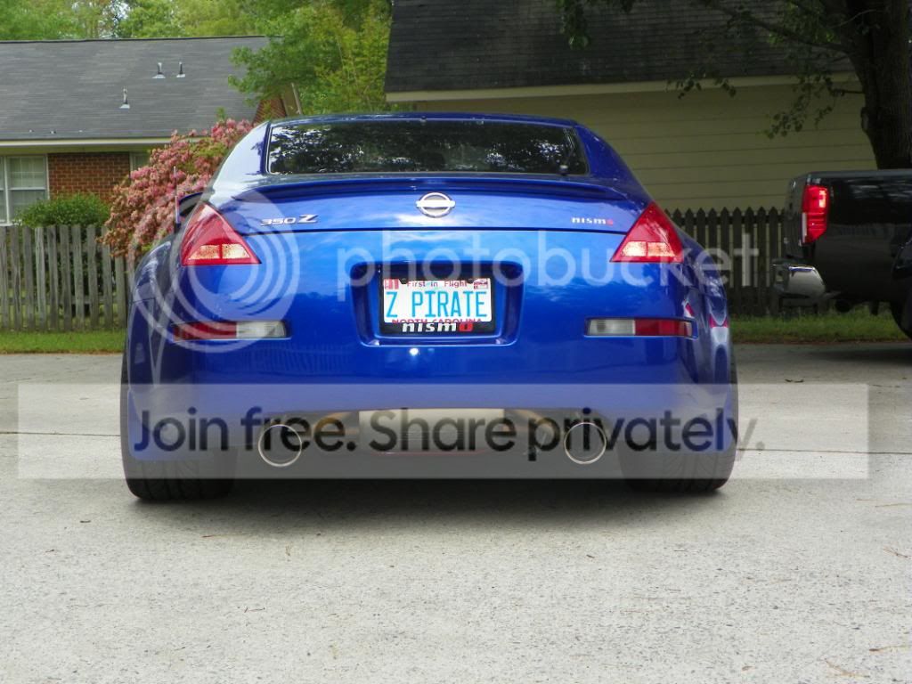

Did mine yesterday using 3M double sided tape and a jack with a block on top until the tape set. After the tuck I polished my exhaust.
I did exactly that about a month ago lol. 2 x 4, jack, and two microfibers. The double-sided tape held 2-3 weeks then the bumper came "untucked" haha.
I guess I'll have to wait and see. My buddy Chris did his about three weeks ago and his still holding up. We both used two rows of 7/8 inch wide 3M molding tape. We also kept the bumper cover jacked up for about fifteen minutes before letting it down in hopes that the adhesive would set up.
I used the same stuff but only 1 row. Left it jacked about an hour to set.

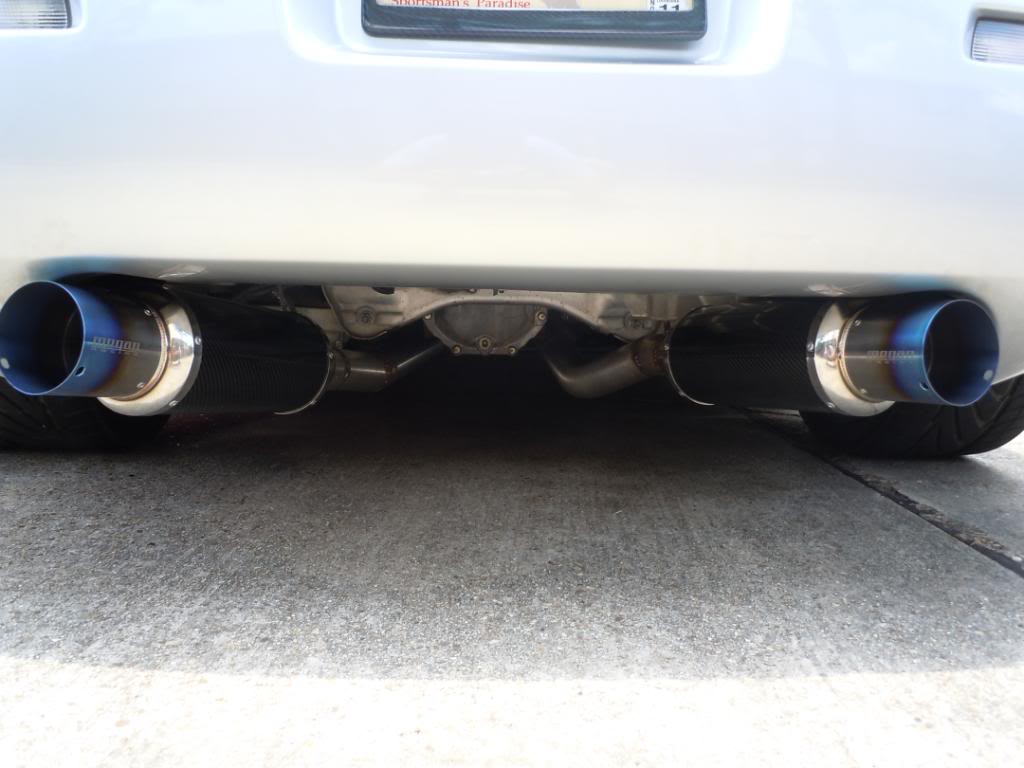

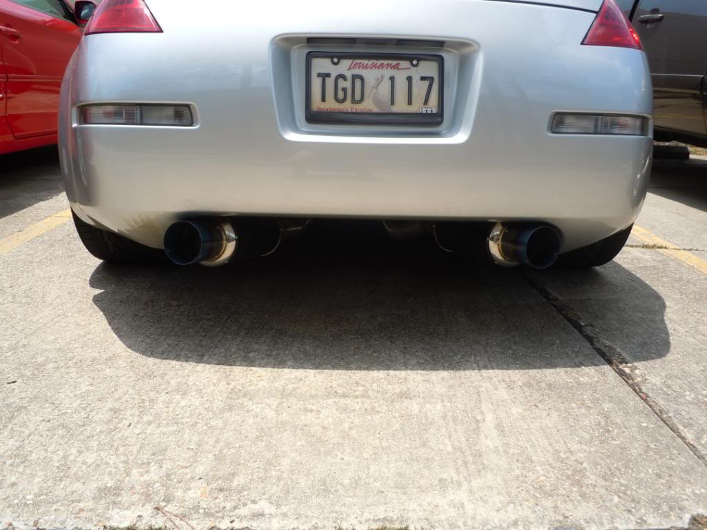

My new custom Dual Carbon Megan set up with a bumper tuck
Old May 21, 2011 | 12:01 PM
  #497
omsin523's Avatar
omsin523
Joined: Oct 2009
Posts: 1,007
From: orlando
Doesnt look bad, got any pics of the piping underneath?

Nice
How raspy are the CF cans?

Originally Posted by ADMAN
Nice
WAYYY quieter than my topspeed and way less raspy than it also. i have res TPs also... heres a vid i just uploaded...
