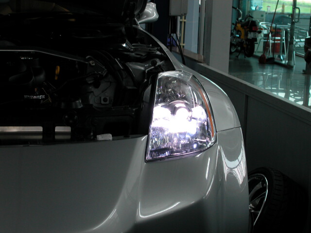

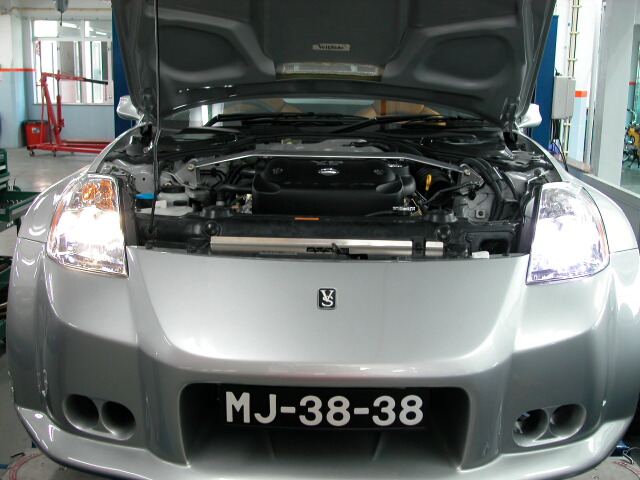

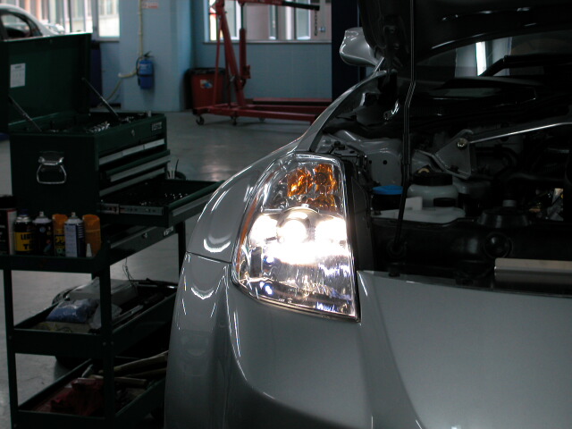

Okay guys, I just got my HID from Phillips in. D2R of couse. The install was pretty painless, but that was because I had all my wheel off, on a jack, and a couple of guys helping because I was bleeding my brake also.
Left side is stock, with a signal LED city light, and the stock yellow bulb.
The right side is with a double LED city light, coylite chrome signal bulb, and the Phillip 6000K HID.
I think the HID will get a bit brighter and less purple-ish after it "break in", at least that was what I was told. This pic was when it was first and and we were testing it out.
The lighting was what I have expected, LESS then the 4300K stock HID. But the Color was more then what I was expected, very very nice looking from outside of the car. Actually a tad bluer then I had in mind, but no complain here. If you are looking for PURE WHITE, I would suggest the Phillip 5300K then.
Okay, on with the show.:

Sharp: I just got some Phillip D2R bulb from Hong Kong and gave it to Ao's Racing to install them...pretty good, no big deal. I was bleeding the brake anyways so the wheel was off and the job was easy.

Oh, one thing I noticed. Even though nothing at the headlight housing is touch, the cut off seems to be more blurry then factory. That I don't understand as I only swap out D2R bulb for D2R bulb.
Any idea?
Any idea?

I imagine the replacement D2R bulbs dont have the same quality control as the factory units, or not precise location of the gaseous element - too low or high or close or far from the reflector- I too have this "bleeding" problem, although mine is more due to the design of the housing . Even the halogens had a crappy cut off.
