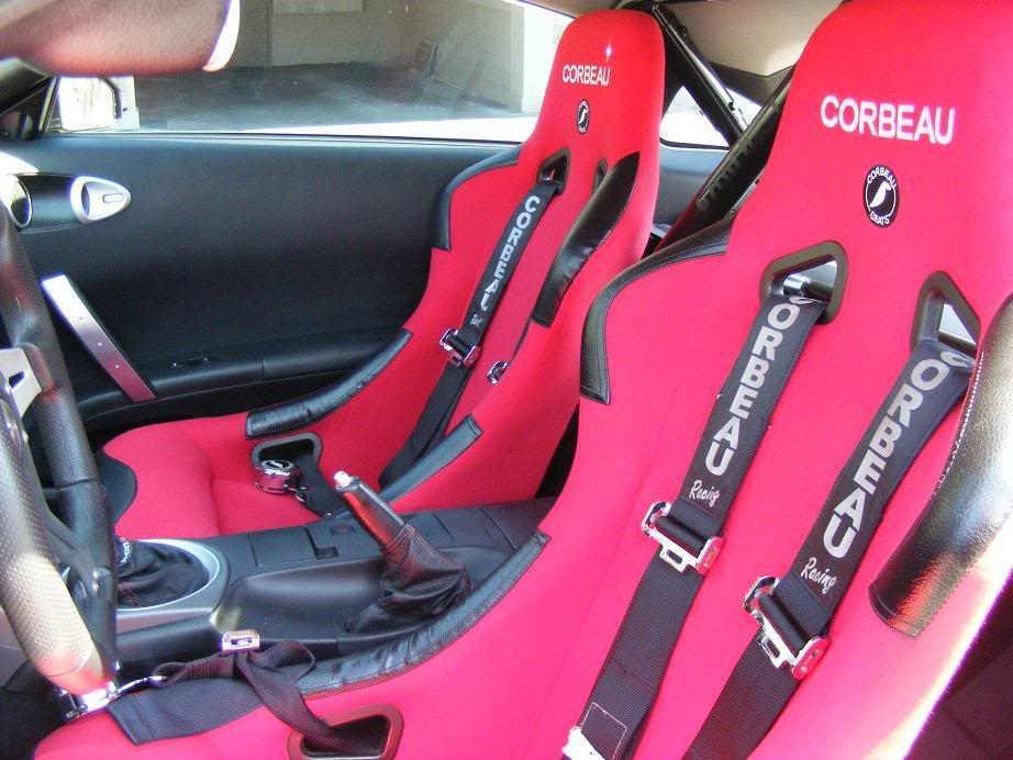

I am not really a big guy but how is the roll bar with the stock seats??? Is it safe to use it that way??? I understand that the seats are not really a true sport seat but would it be alright to run the bar a set of harnesses and the stock seats???

Never ran the roll bar with the stock seats, I installed my corbeaus around the same time. Personally I would not use harnesses with the stock seats, although its been done... The lack of a pass thru for the harnesses in the seatbacks and side bolsters makes me uneasy.
Really, there is no reason you should be using harnesses on the street unless you have deleted your airbags, and if you are tracking the car, then some more useful seats are in order anyway.

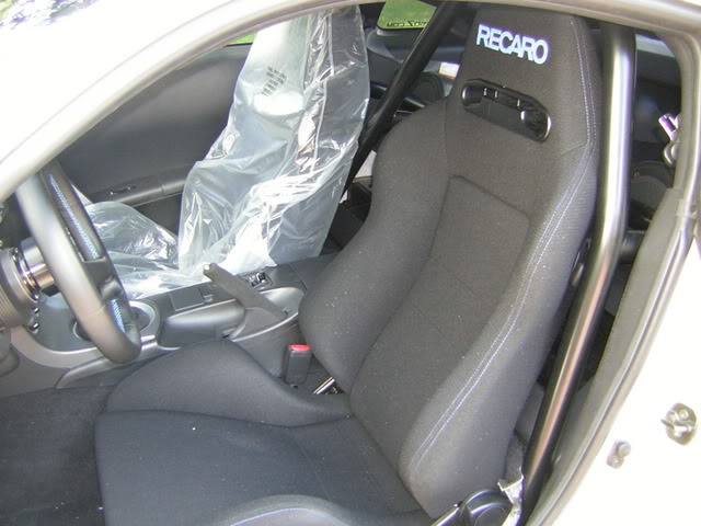

One more pic that sorta shows where the seats are located in relation to the bar. I can take more if anyone needs them.

Pic with the X-Brace and no seats...
somehow we'll both end up with similar looking cages ..

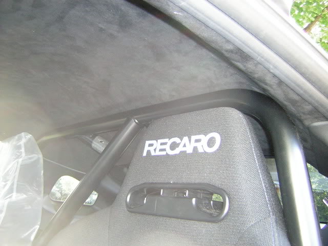

Does it look like it is possible to bang your head at all off the Kirk roll bar along any of the tubes?? Also is the rear glove box accessible with the bar in???
Would like to see some pics of the bar in with out the seats if possible??

With any roll bar/roll cage that has a loop that is anywhere near your head you should have it padded just in case you were to hit your head on the bar/cage during an accident.
The rear glove box is barely accessible if at all.
Pictures without seats have been posted above.

The box will not open all the way with the roll bar installed. It will still open about 6 inches before it contacts the diagonal brace, but thats about it. So you can get small things in and out of it.
As for pics without seats installed, Kwame posted one on this very page in post #25. What else do you want?
