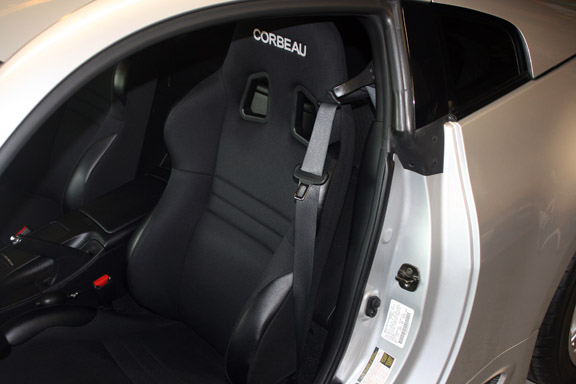

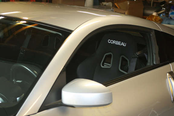

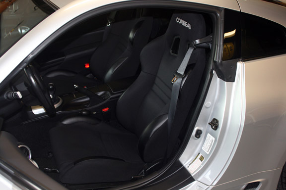

Pics...
p.s. Seat belts fit fine

Thanks man...so that is the non wide huh? looks great i think i may pull the trigger...

Your car looks sweet man thanks again.
