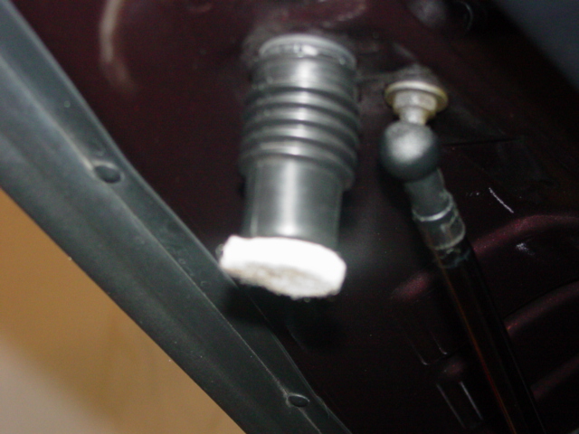

Sorry... there is a misunderstaning there... There is no black bumpers from Nismo.... you just need to buy "something" from your local hardware house.... well...... okay.. I should say that "something" as black rubber pads (around 3 - 4 mm in its thickness) or any pad that you can stick right under the legs of the chairs to prevent the floor damages by moving the chair without lifting it up.. get it now?
You just simply stick those pads right at where those black bumpers (black springs on the hatch that actually push the hatch up) touches the car.... it will allow greater compression on the black bumpers on the hatch and when you want to open the hatch, those springs will have greater forces to push the hatch up! As easy as that!

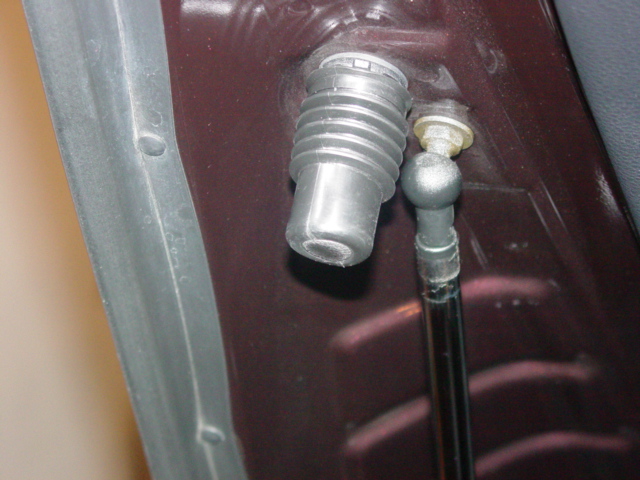

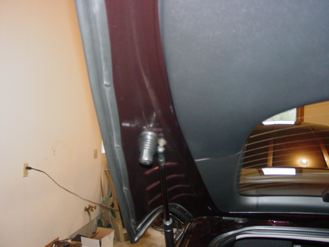

Here are the black bumper things he was referring to:

Close up:

I hot glued a couple of those furniture pad thingies to each bumper (there are two, one on each side of the hatch). Here is the pic:

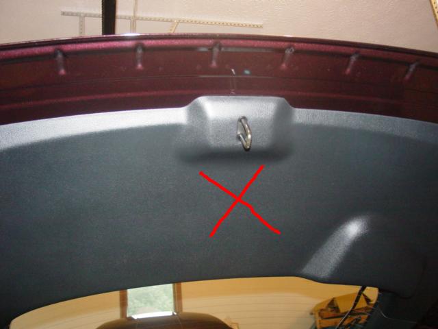

BTW, here is where the hatch weight is located in case anyone didn't know. It's under the panel where the red X is:

Ok, that's all well and good that you can pop the hatch in one pop now, but what about the hatch staying up when you raise it? Does taking out the weight you marked FULLY solve that problem? Thanks, Mike

Exactly what do you mean by "staying up"? It depends on what angle the hatch is at as to if it stays up.
If I have it all the way up (like in my pictures) it stays up. If it is anything less than say, a 45 degree angle, it will close but I would think that it does this even without the NISMO wing.

The counter weight adds weight to the edge of the hatch to make it easier to close the hatch. This weight was designed to balance things for a hatch with no spoiler or at most the small factory spoiler. The larger wings are heavier so the counter weight is not needed because the combination of the larger wing and the counter weight is just too much for the "stays" to hold up. Removal of the counter weight will give you a fighting chance of having your hatch stay up when you want it too provided you are on level or "nose down" surfaces. Taking the plastic panel off to get to the weight is not overly tough. Just be careful with any clips you encounter. Lift the center of the clip out and the legs compress allowing for easy removal.

Good works.... but you put those furniture pads at different location to mine... I actually stick those pads on the body panel instead! But either way, they all work perfect!!!

Mike. Mine stays up all by itself at any angle greater than about 45 degrees. I have to conclude therefore, that the weight (or the lack of it) is the answer here.

The weight is very easy to remove. The rear lid panel simply pops off. Just pick a place and start pulling. It's not an easy thing to break, and even if you somehow break one or two of the pins, they're easily replaced.

Well, it's a beautiful day and I just removed that weight. That really did the trick!!! Thanks guys!!!
