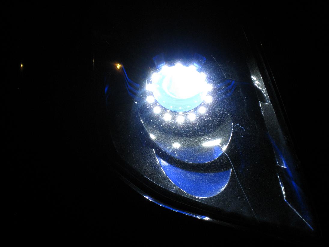

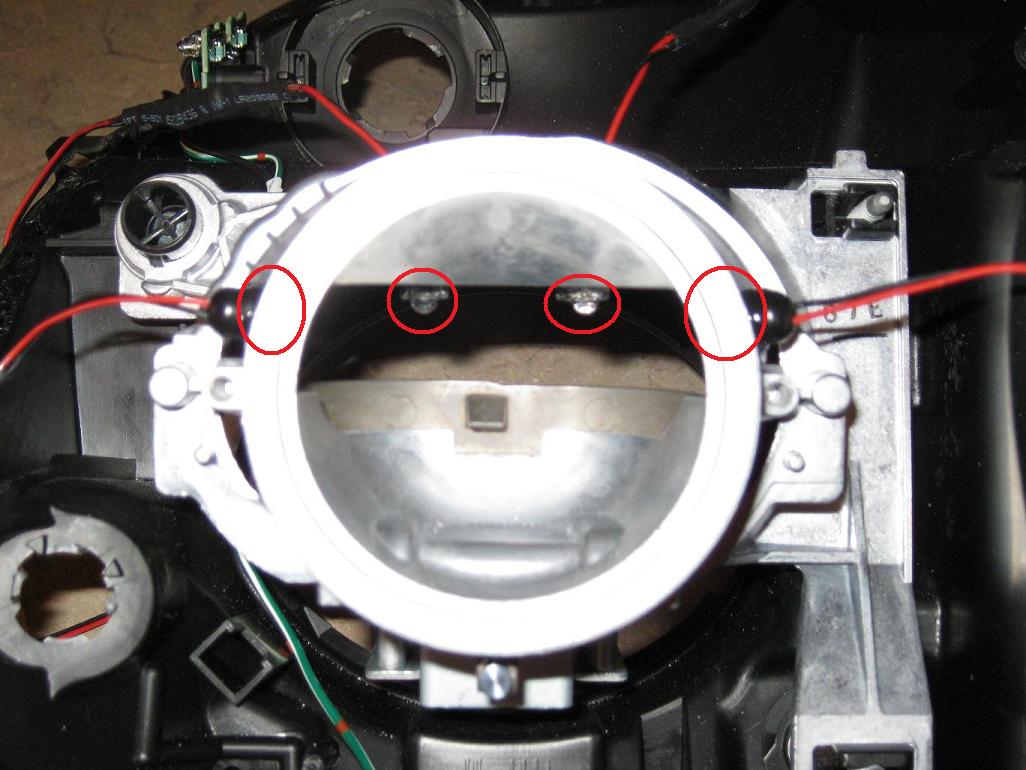

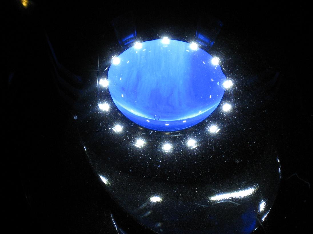

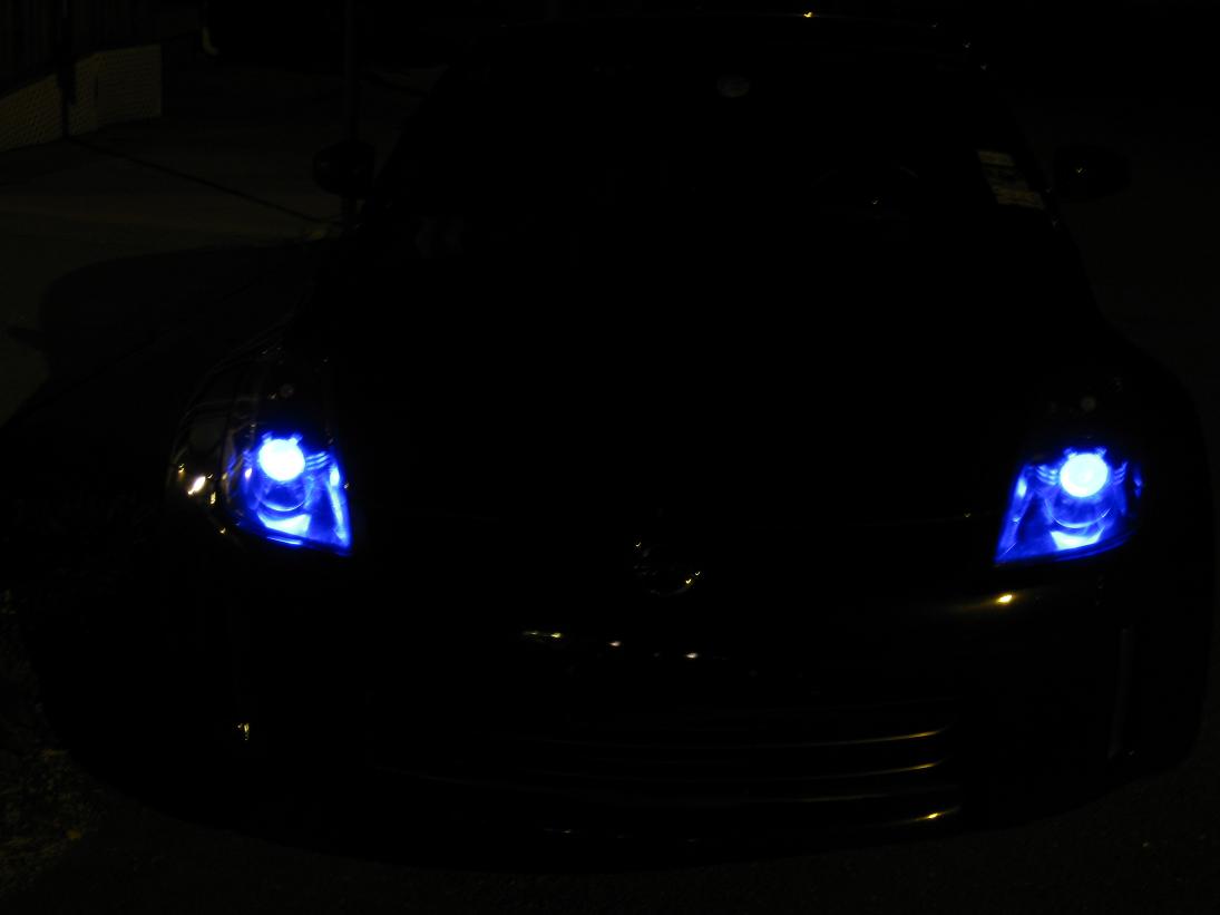

Old May 22, 2009 | 07:41 PM
Prone's Avatar
Prone
Joined: Nov 2008
Posts: 40
From: PA
Default Hope these help
I hope these help. I took some shots to give you some sort of reference point. I'm not a photographer so the picture quality is not the best, and yes, I have a scratch on my lens that I need to buff out.
