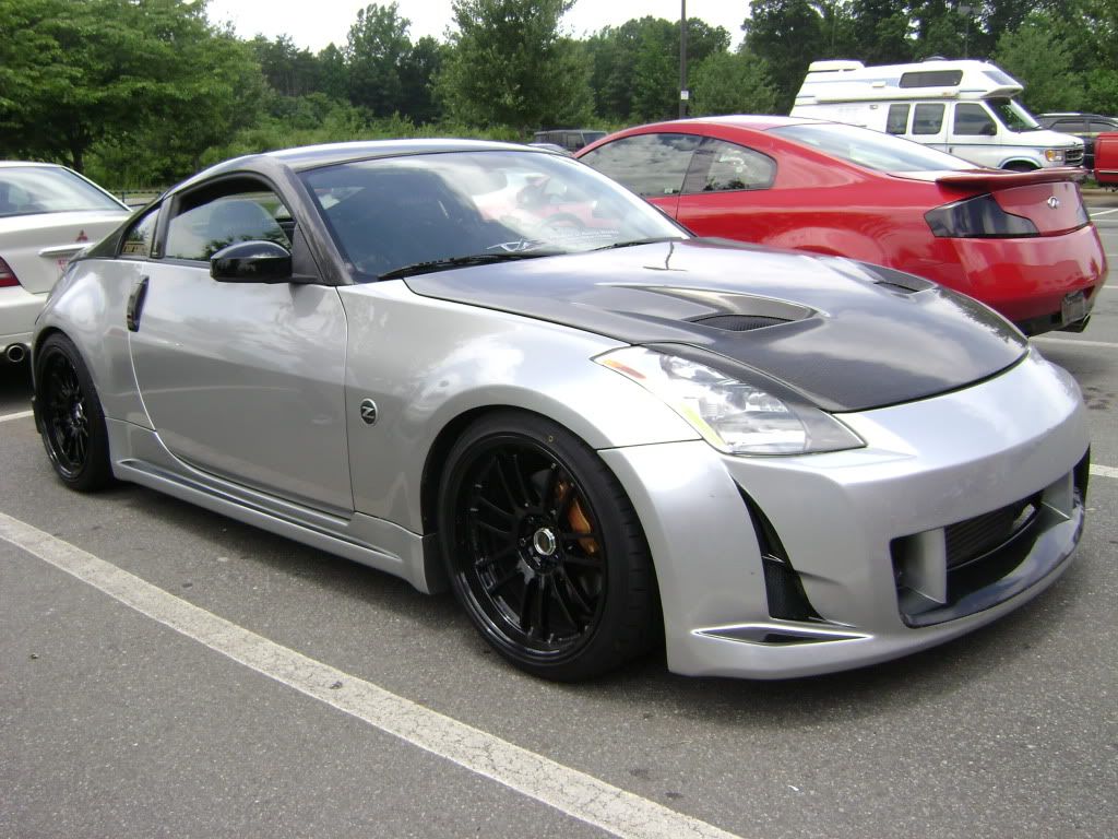

Here is mine.

Originally Posted by TSG-Z
Here is mine.
Nice Loving the black hi-lights

your car looks awesome but i would get the side z badge shaved, it kinda of offsets everything, but its your car

on the pic above, are the mirrors something different? i.e. the color? they seem really glossy in comparison to the rest of the black on the upper half of the car. just curious, sick ride though!
A-Pillars/Hood/Hatch are CF. The mirrors/handles/Roof are painted black.

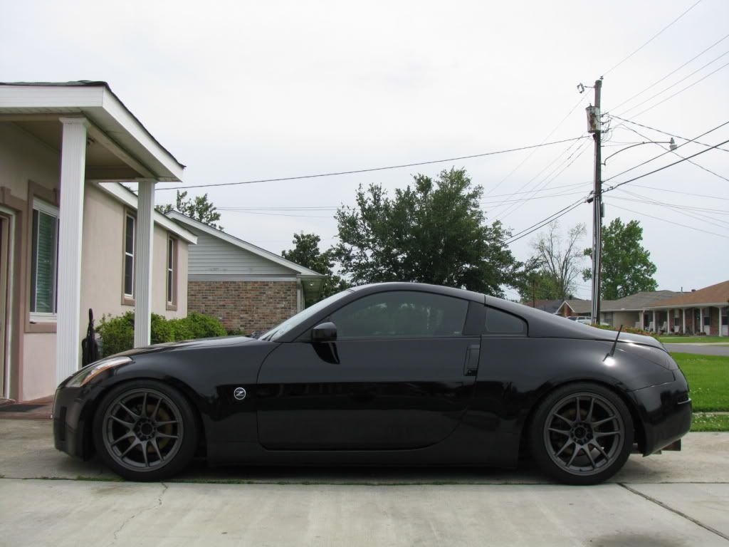

Originally Posted by JonnyB504
Got mine done by a body shop too....someone ran into my door so I asked how much to get the handles done when they were fixing the door and they said theyd take care of it no charge =)
Hey Jonny, if you don't mind me asking, what are you lowered on and what size are your wheels? I'm trying to decide how I want to lower my Z and I like the way yours sit. Also how is the ride? Thanks!
