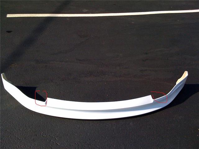

So got a brand new front lip from vertex.
went into the shop to install and they called me back saying no way its going to fit.
i'v never heard of this? i have only heard GOOOD things about vertex.
BUT the shop is VERY reputable. hmmm
the circle part is where they are telling me its not fitting.
any suggestions?

Pics of it close up on those spots as best as you can fit it on the car would be helpful.
Suprised, though, Vertex=good. Does the shop do much custom work or just straight collision body shop?

You need to GO TO THE BODY SHOP AND HAVE THEM SHOW YOU WHY IT WONT FIT, then take pictures.
Im assuming you understand that 03-05 has different lip fittment than 06-08, correct?
Collision body shops dont see many "lips" brought into their shops, thats why i always go custom body shops for work with kits. They have done it time and again and know exactly what problems can happen and what you and they can do to fix them if need be.
Many "collision" body shops will try and put it on, and if it doesnt fit PERFECT, they tell you it wont fit period. It requires a little knowledge of the aftermarket body parts market.

you should also ask if they removed the bumper for test fit. As you should already know the OEM bumper is polyurethane. In many cases i've seen as far as lip installs go, the bumper has a lot more play if removed, and you will be able to guage fitment much netter vs. taping or holding the lip to the bumper while it is on the car, which is probably what this shop did. It should line up much better with the bumper off the car, especially if it's authentic.

If the shop is saying it's not fitting especially the part where you circled, you are trying to match the lip with the wrong year bumper.
